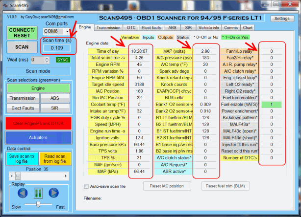

re: Scan9495: Free OBD1 scan app for 93/94/95 LT1
Originally Posted by bobdec
Gary, latest version and Users Guide looks great... going to send you back that simulator chip, never got to hooking it up.. IMO your app, cable and a PC s/b required tool set for any DIY on these cars..
i have windows8 and downloaded to software. sorry to say it does not work. it says i am communicating with my ecm but it does not show any datastream or anything. does not tell me any trouble codes. does not work period
What kind of cable are you using? What is the manufacturer, or did you build your own?
If the cable has lights (some are hidden under translucent casing) see if the lights flash briefly when the cable is plugged into the pc. Leave the cable plugged into the pc and then, when the cable is plugged into the car and the ignition is switched on, see if the red light flashes continuously. If either of the above does not occur, the cable isn't working correctly. It may be defective or the pc driver may be incorrect or not installed.
If the above is ok or if your cable has no lights, check the com port this way: Unplug the cable and start the app. Make note of which com ports are available, if any. Plug the cable into the pc and restart the app. If a new com port does not appear in the list, the cable or driver is not working.

I bought a 16 pin ALDL to usb cable from OBD Diagnostics. The scan9495 software shows that it is scanning and that I have trouble codes but it will show me what the codes are. I have tried everything. I have done it by the instructions the software came with.
What indication do you have that it is scanning? How does it indicate there are trouble codes? Are there any numbers in the engine tab entries, like in the attached diagram (3 arrows pointing right)? What value is shown in the Scan time box (4th arrow)? Please be specific, so I can get this working for you.
Attached Thumbnails Scan9495: Free OBD1 scan app for 93/94/95 LT1-scan9495-engine-tab.png
