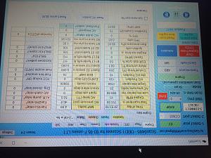

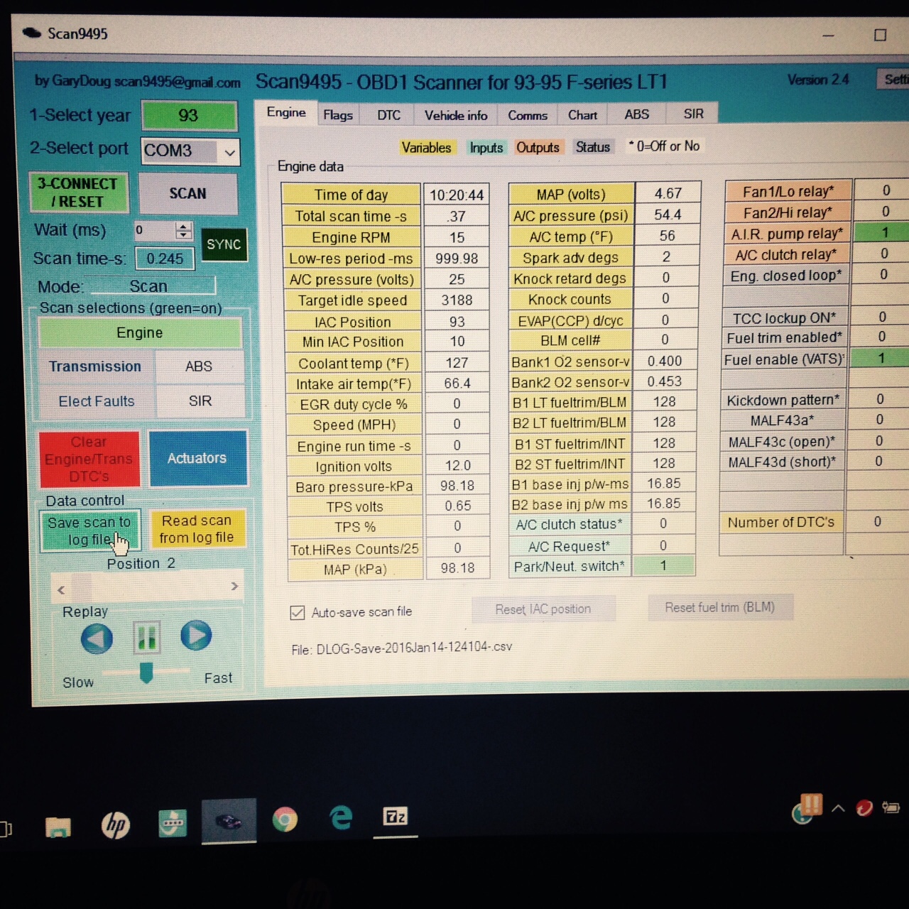

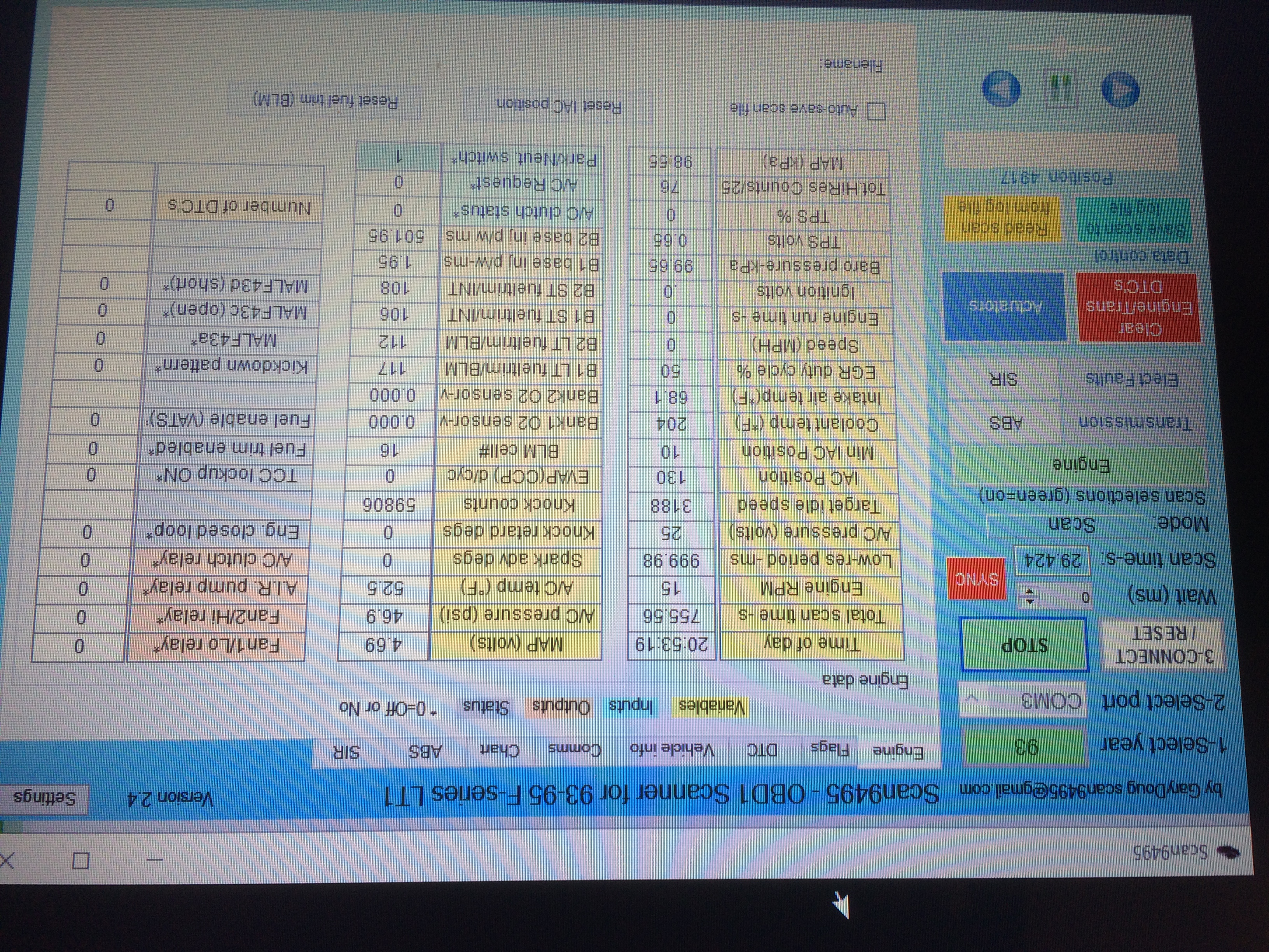

Well,here is a scan from yesterday and todays scan.
Attached Thumbnails Scan9495: Free OBD1 scan app for 93/94/95 LT1-img_1087.jpg   Scan9495: Free OBD1 scan app for 93/94/95 LT1-camaro-scan-1-14-16.jpg

Hope GaryDoug and or Injuneer can decifer this for me.Just double click on the image for clarity.(Windows 10 here).After trying out different ways to make this work,I think I'm getting closer to getting it right.Many thanks for your input and patience.Jim.

Not sure what your question is. You can't really learn much from a single frame or two of data. That is what you posted. And the engine isn't running, so there's not much there. Typically the software can scan about 9 frames per second, meaning there are more than 2,500 frames (lines) of data in a 5 minute log.
You have to run a data log over a period of time - which you may have done. If you are having a problem while the engine is running, try to duplicate the conditions when you are running the data log. One screen shot looks like the beginning of the log, the other is at the end of the log. Save the entire data log as a .csv file and upload it to an FTP site. Put the link in your post.
