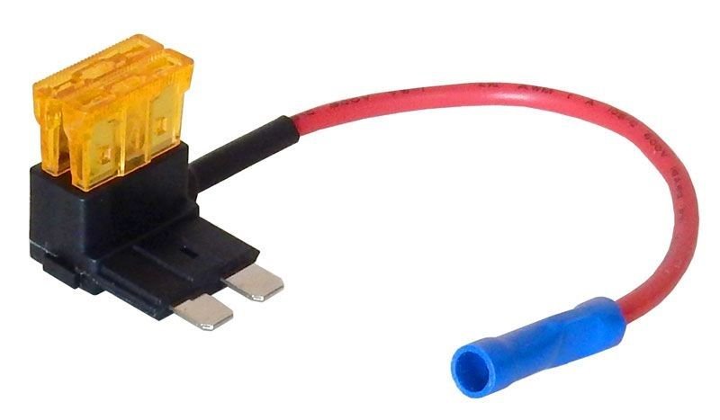

Since a relay coil is a very low draw, I would usually suggest a Fuse Tap (at most auto-parts stores). Another possibility is a Fuse Blade Tap, which you could use in the relay panel, where a relay gets switched power. The Blade Tap provides a standard .25" male blade terminal, to fit with a .25" female terminal end on a wire. If you can find a place to tap, the Blade Tap can be bent as needed to give access to the power.
Standard Fuse Tap. ^^^^^

The relay coil load is so small, it would not matter much about which fuse/relay you tap, as long as it is switched by the ignition key, Injuneer makes a good suggestion, above, for the dragstrip. For any added voltage wire, an inline fuse near the Tap is a very good idea.
