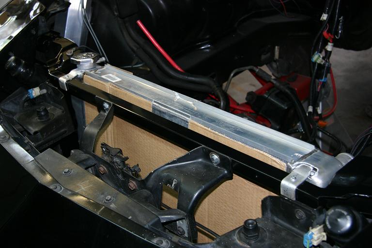

VERY nice work!! I'll be doing some similar Fabing when I get a garage for the car. I'd like to do something similar, but I'll be adding a little more reinforcement above the rad. Maybe a piece of angle iron, or something thinner.. W/ room for the fill cap, but able to strap the rad in still..

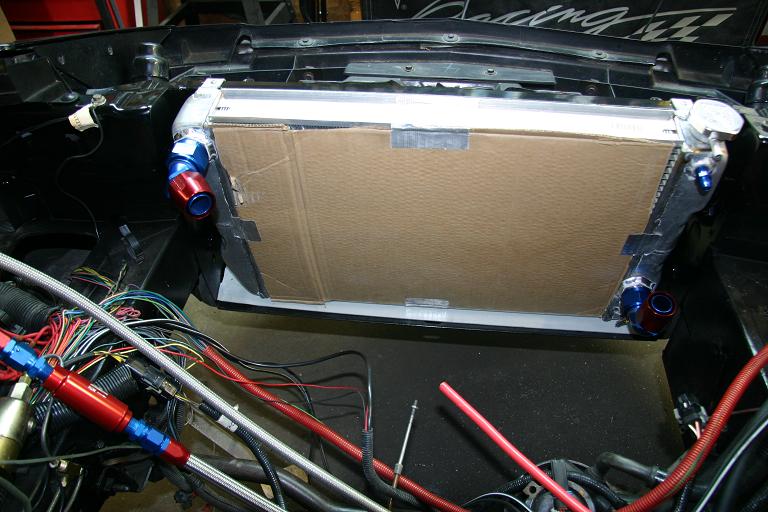

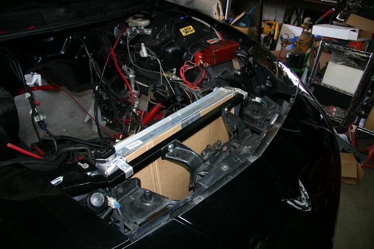

Running... and runs DAMN good... I can't wait to dig into the motor and build an ANIMAL.
Here is a couple pics for now guys

Looks awesome! Get some paint on the radiator support so it doesnt rust!

Sweet, how does the pusher fans do for keeping it cool?
Keeps it right on the thermostat with em both running.

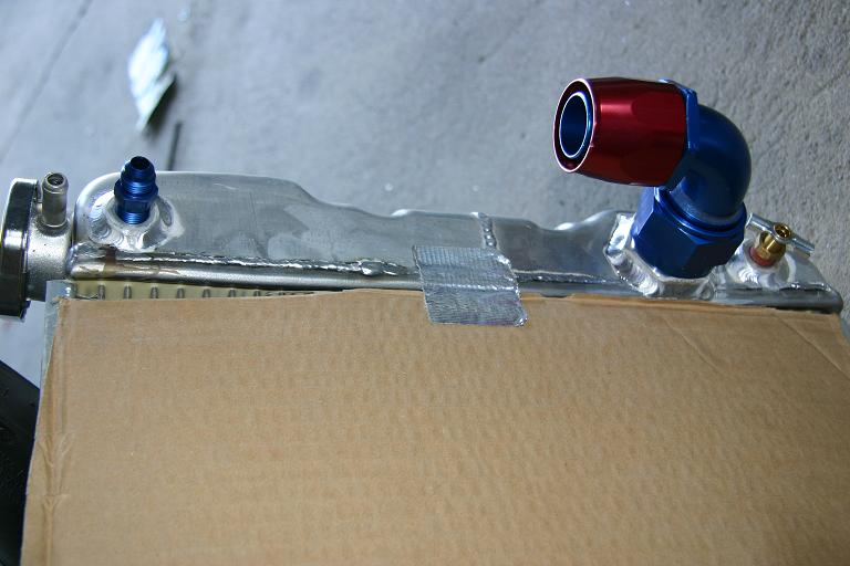

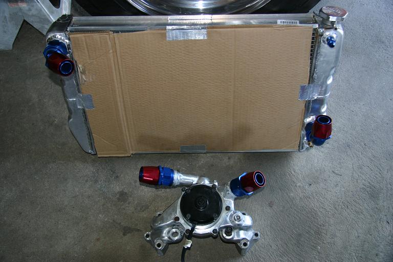

I used the same rad but I welded new fittings on my rad and water pump for true braided AN lines so I didnt have to screw with adapting diffrent size hose ends.
Looks sexy *** hell!! When I go to build my motor I am doing all that good stuff along with paintin everything under the hood black.
Props man!! looks sexy!

rad hoses
i did the same thing with mine 20an fittings with a braided i-core nomex coated hoses for upper and lowers, and for the steam pipe line i went 4an kevlar braided line.
