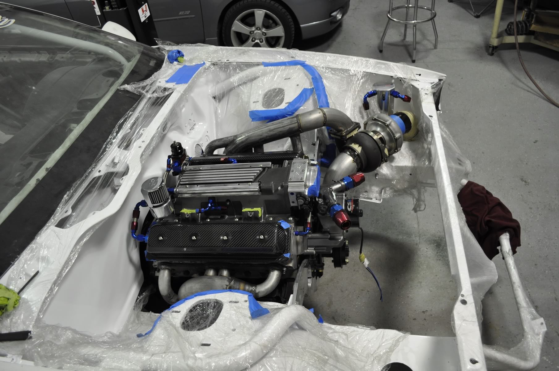

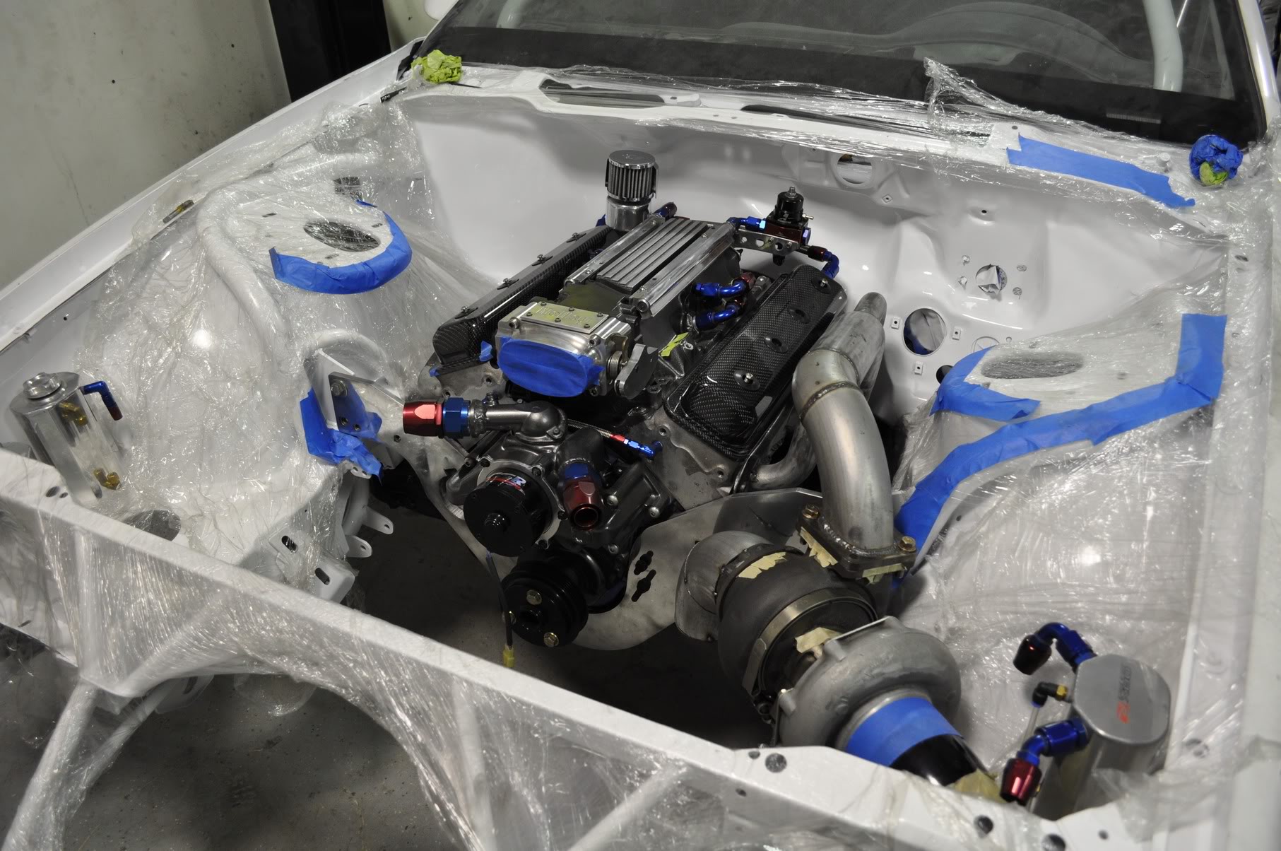

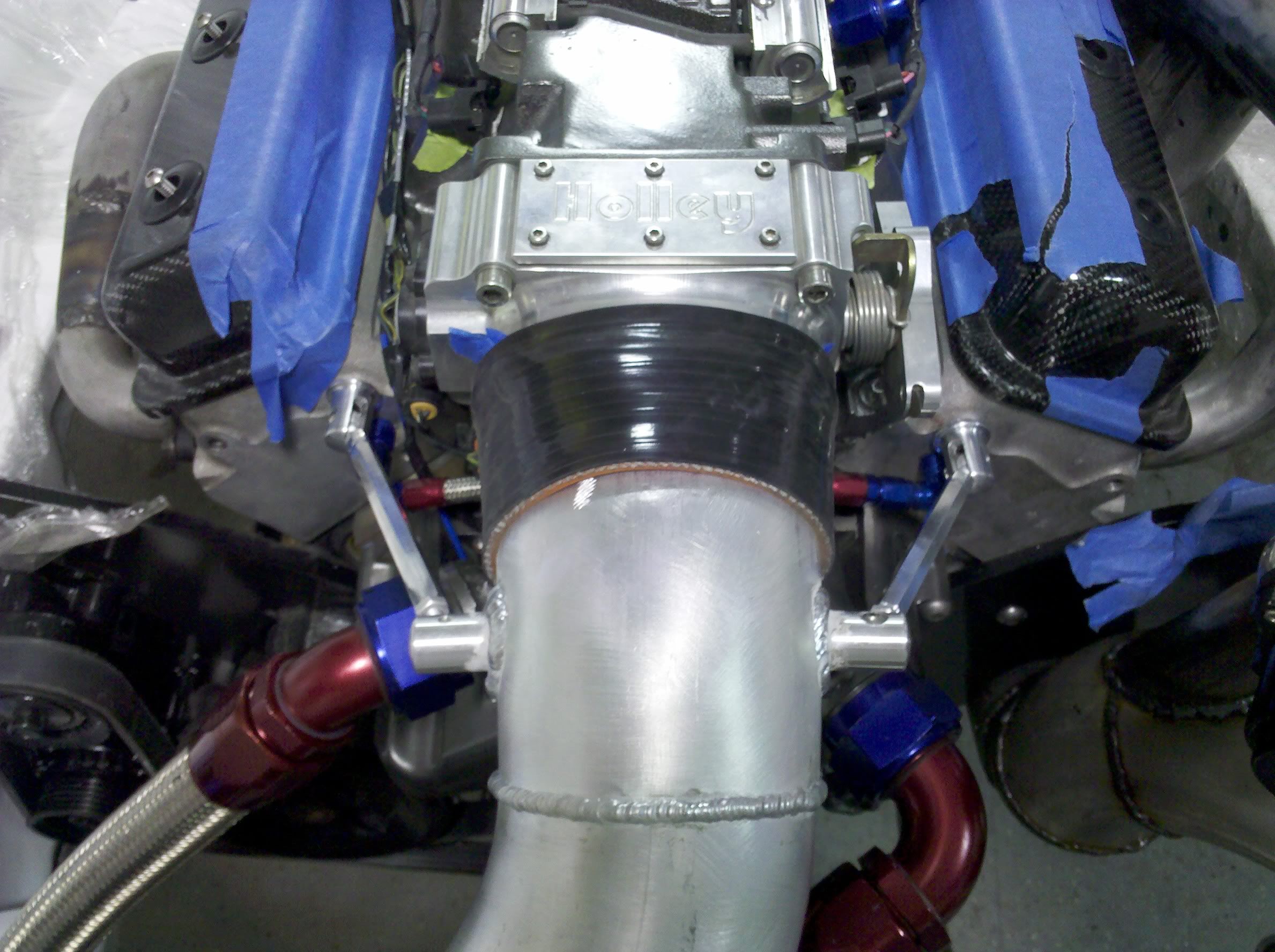

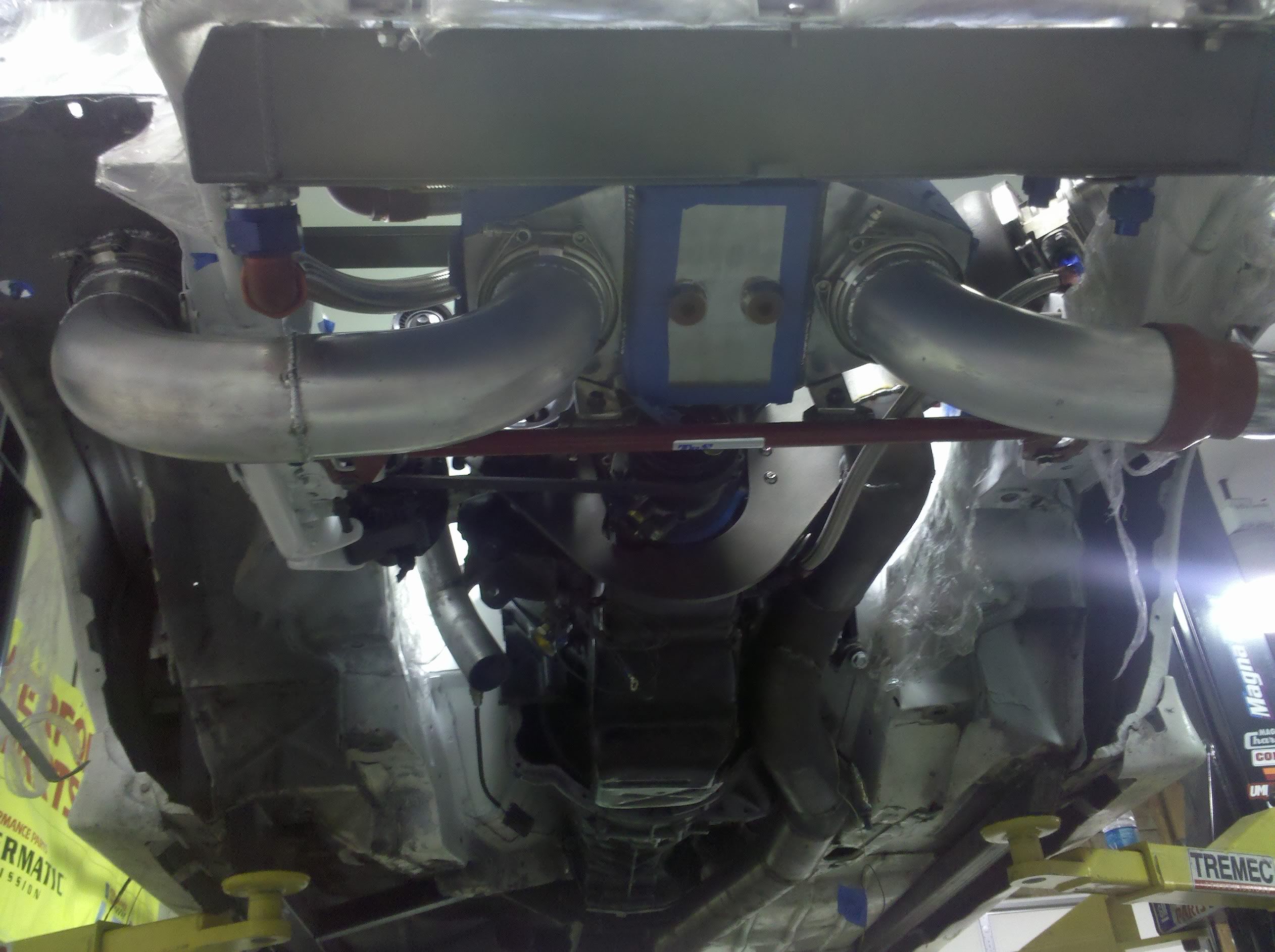

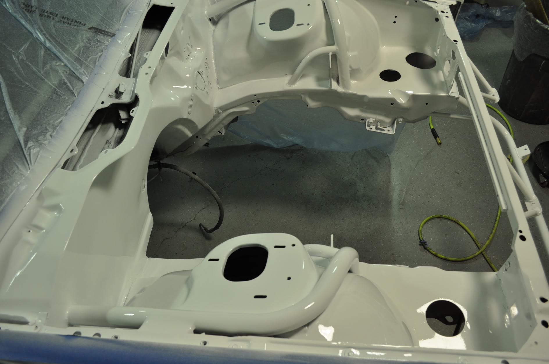

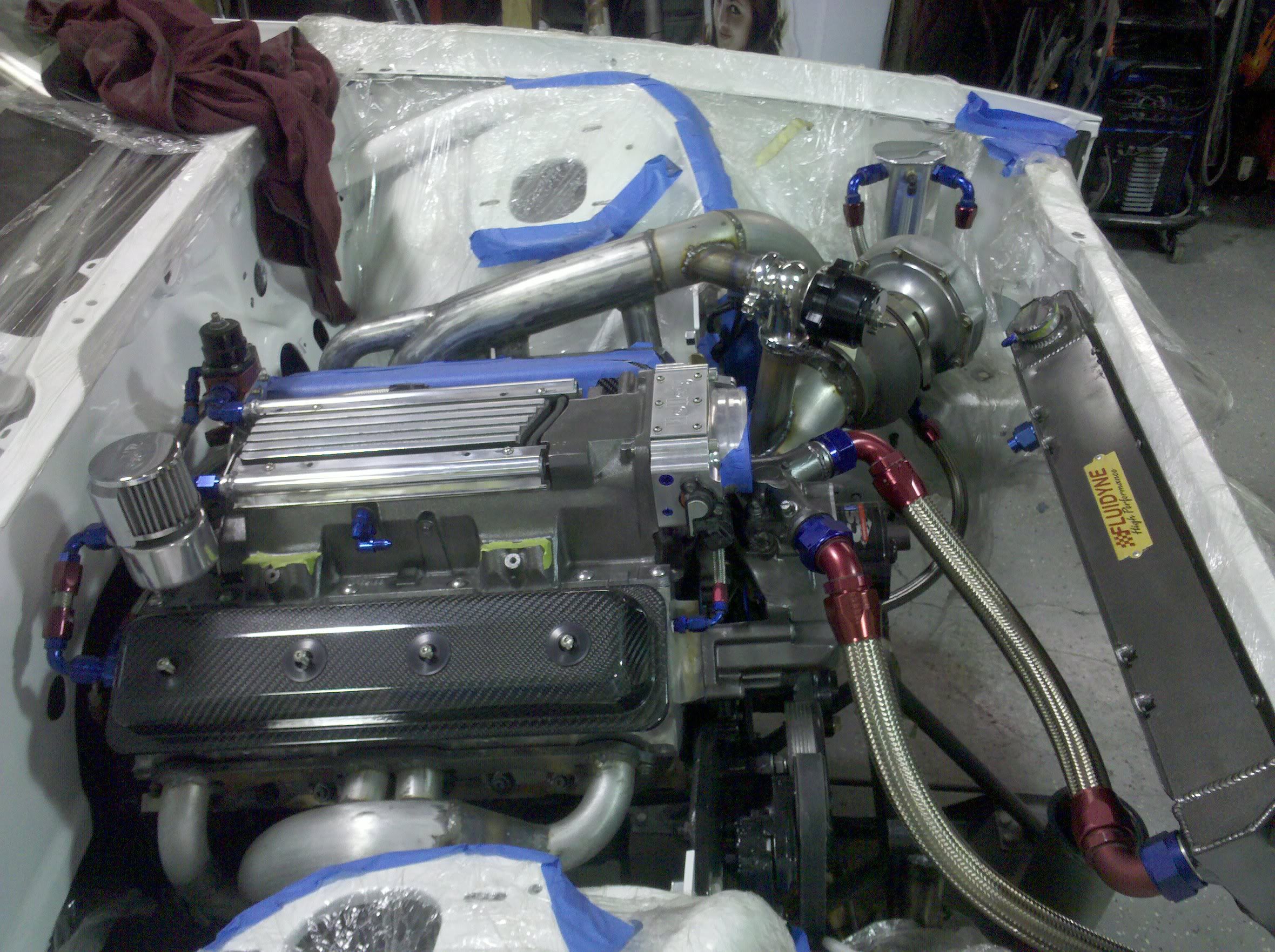

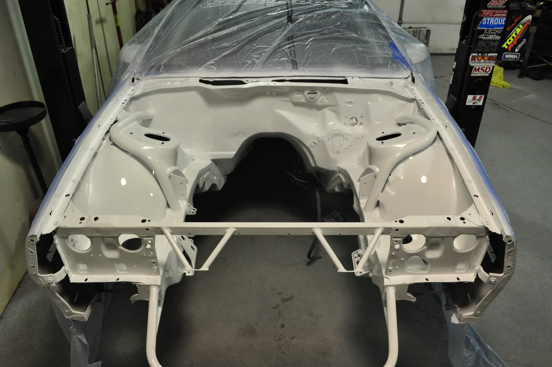

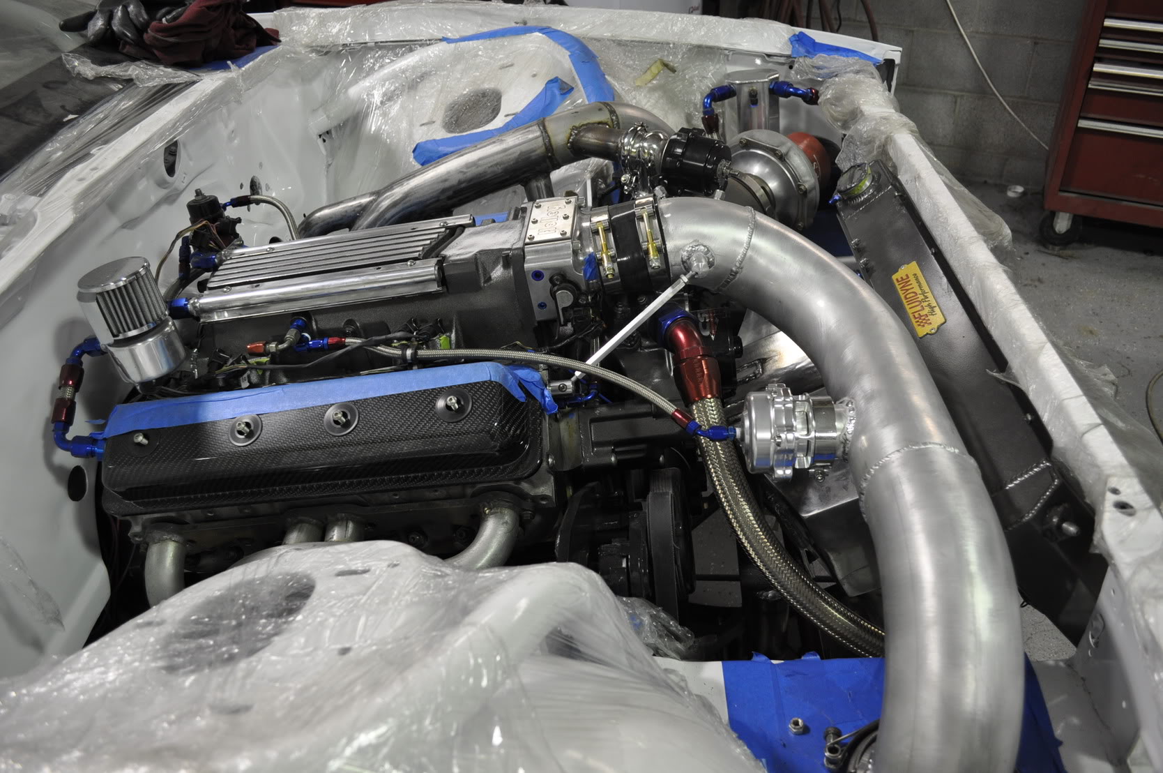

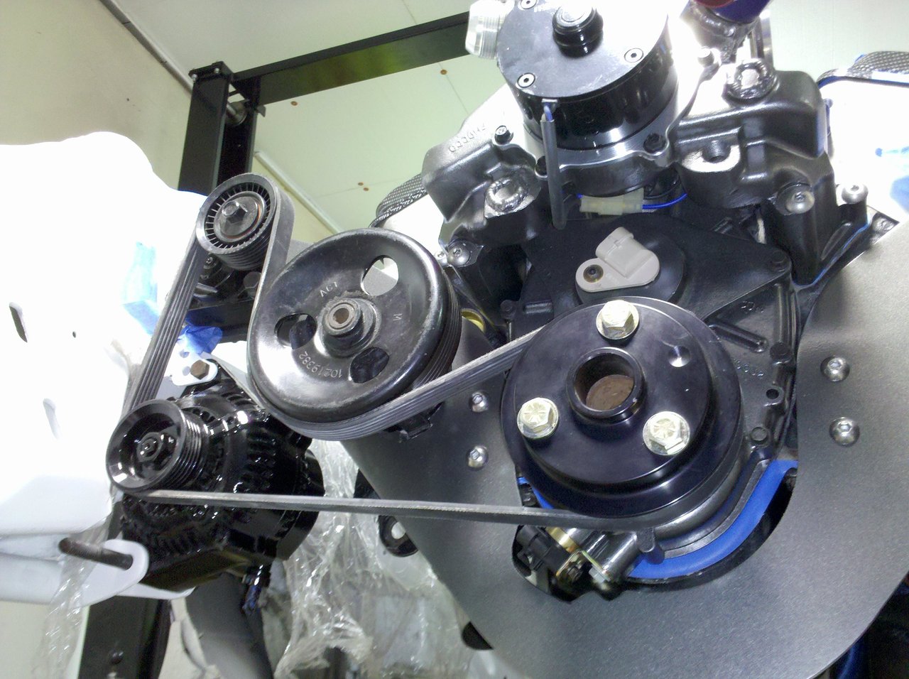

Wow, its been a while since I updated my post here! Heres the latest if you hadnt seen my posts on the other forums. I got rid of the A2A and went with an A2W setup. also finished the complete rewiring of the LT1 harness to get rid of all the crap I dont want/need and repinned it to an LS1 PCM... Im still working on alot of small things but the majority of the fabrication work is complete. once I get it fired up Ill get back on the interior/mini tubbing and watts link build.

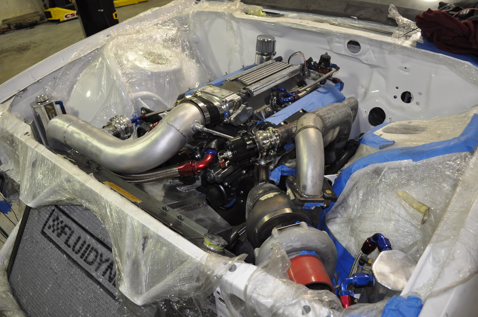

Why are you putting the intercooler behind the radiator? Space?
Old Jul 18, 2010 | 10:44 AM
  #65
Tricked-Out-Toy's Avatar
Joined: Nov 2005
Posts: 840
From: Nashville, TN

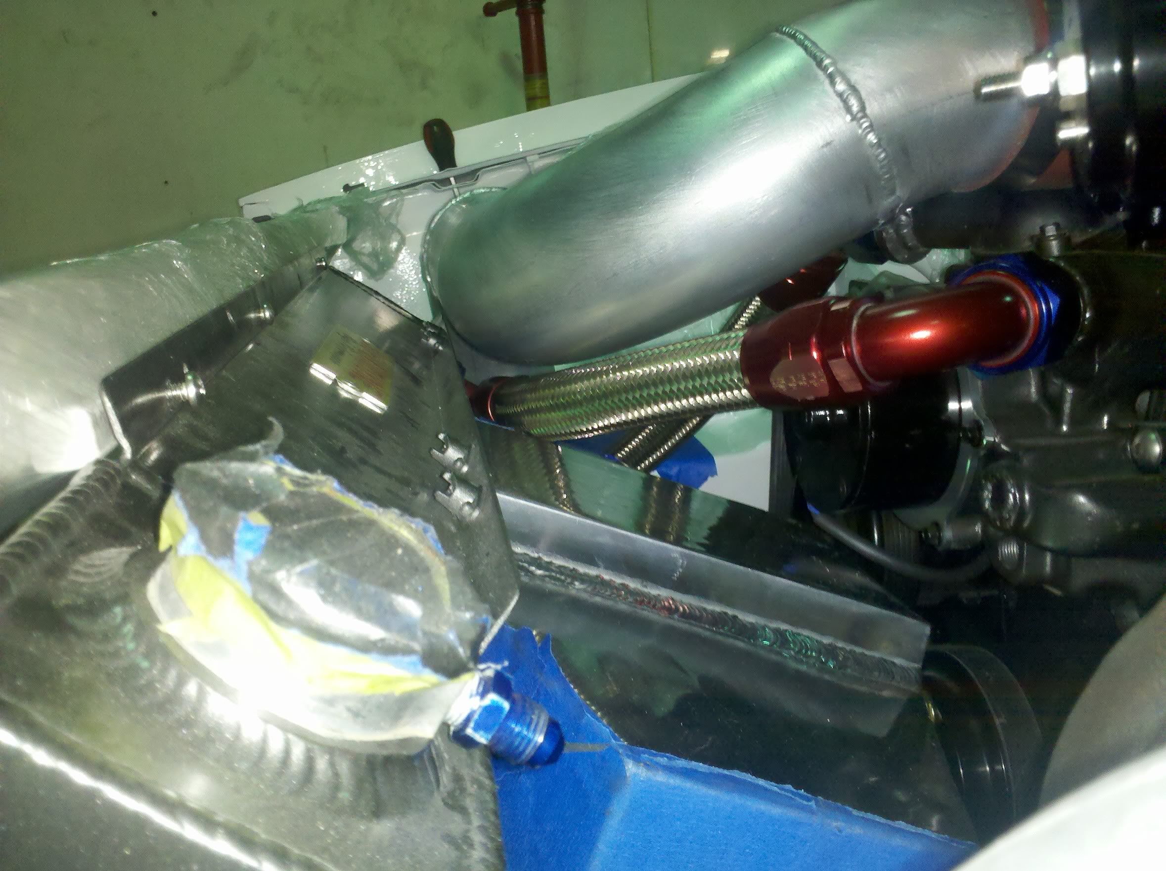

Ya theres no way it would have fit in front of the radiator. Ill probably make a blanket for it to try to insulate it IF it causes a problem. right now the core is over sized for what I plan on doing so adding some heat from the engine bay doesnt really bother me. its still light years better that the IAT's I would have been seeing with an A2A
Old Jul 18, 2010 | 01:36 PM
  #66
97WS6SCharged's Avatar
Joined: Nov 2002
Posts: 4,784
From: Jacksonville
It's not the hot air blowing on the thing that concerns me since it's an A2W setup. I'm wondering how well the radiator is going to function with a big hunk of aluminum behind it hindering airflow through it.
Old Jul 18, 2010 | 02:27 PM
  #67
Joined: Nov 2005
Posts: 840
From: Nashville, TN
thats the last thing im worried about. lol its really hard to see from the pics but more than half of the radiator is free and clear. I have two 14" spal fan going on there. its only tight against the radiator at the very top. also rememeber this radiator is 2.5+ times larger than a stocker.

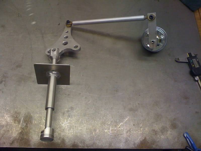

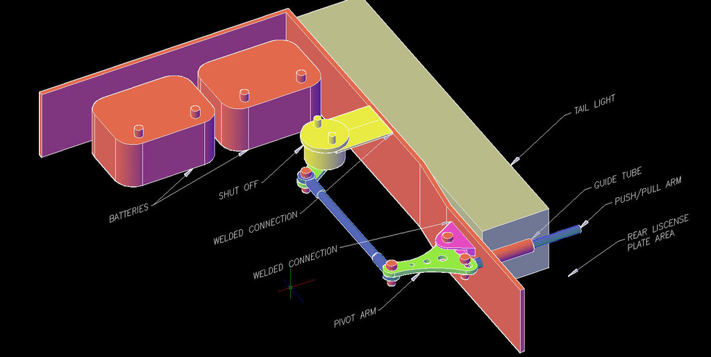

Just a lil update. got my battery cut out mounted and its pretty pimp! its cool to see something go from a rough sketch to a drawing then to the real deal.

That battery cutout linkage turned out pretty damn slick, fitment is trick too.
