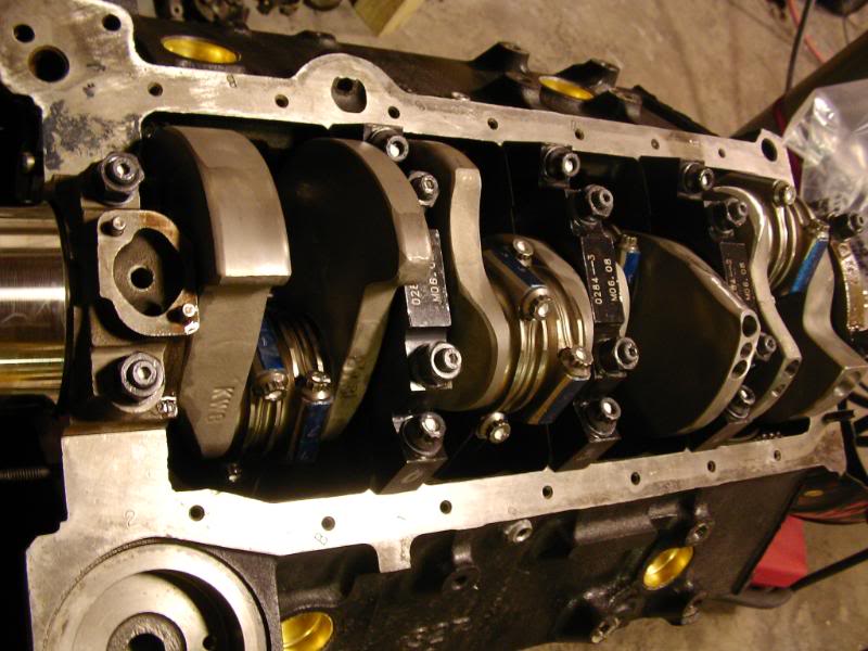

Thanks man! The car has been slowly getting to were I want it. its taken almost 10 years to figure out what that was!
The engine is a 355. Im doing splayed main caps. Using Pro-Grams caps. Eagle crank and Eagle H-beam rods (5.7") The pistons are the ones from Mahle. The should be here in a couple weeks. every person Ive talked to from Mahle says there 2618 so Im going to go on there word... The stock heads are the LE3's from Lloyd so they should support my goals, (~600hp). The cam is last on my list. not sure if im going to go custom or off the shelf....

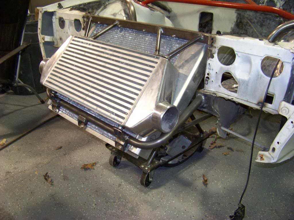

Wow, I havent updated this is A LONG time lol all my pictures got delete/moved to rather than start a new thread, Im updateing the first post with the pictures that got moved and heres where Im at right now.
Intercooler and my MASIVE radiator mounted

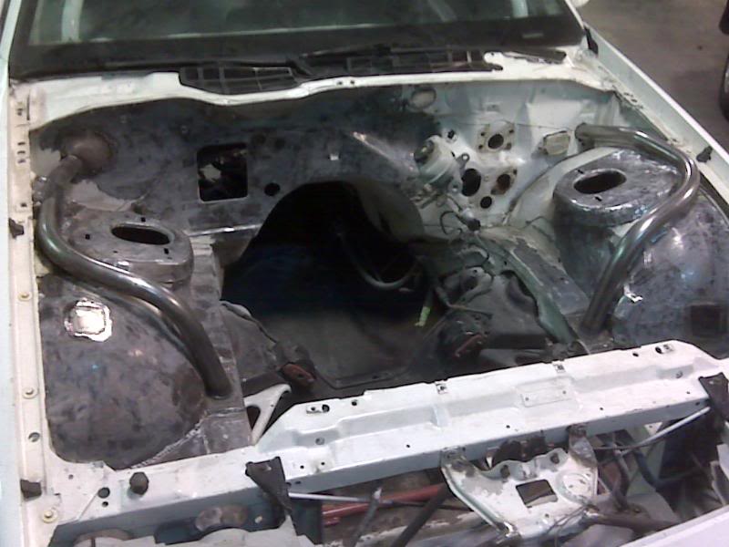

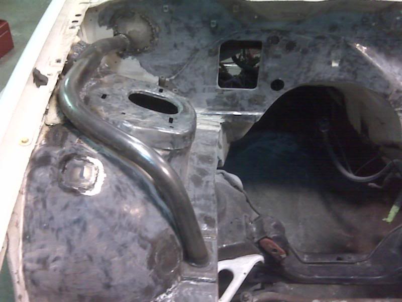

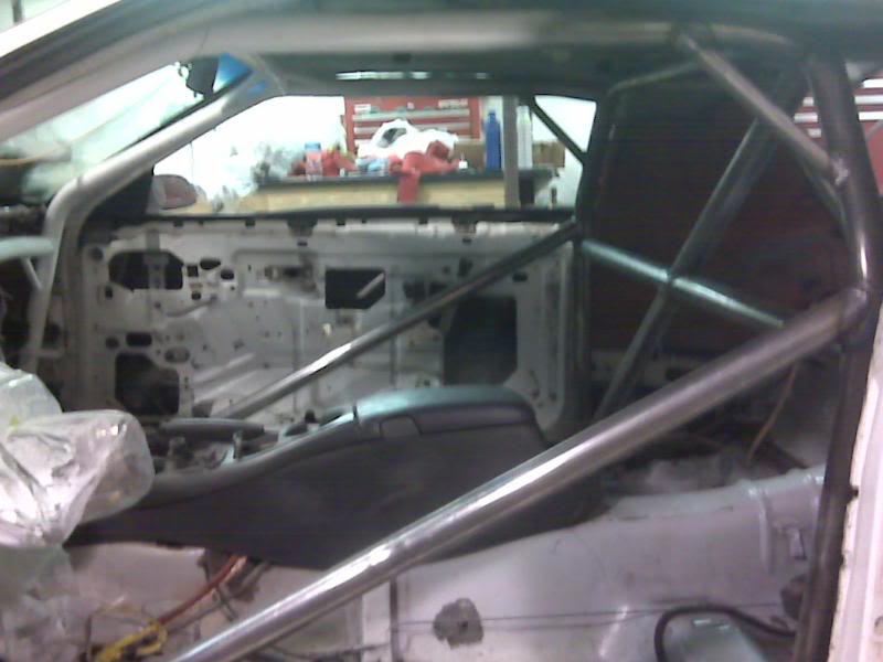

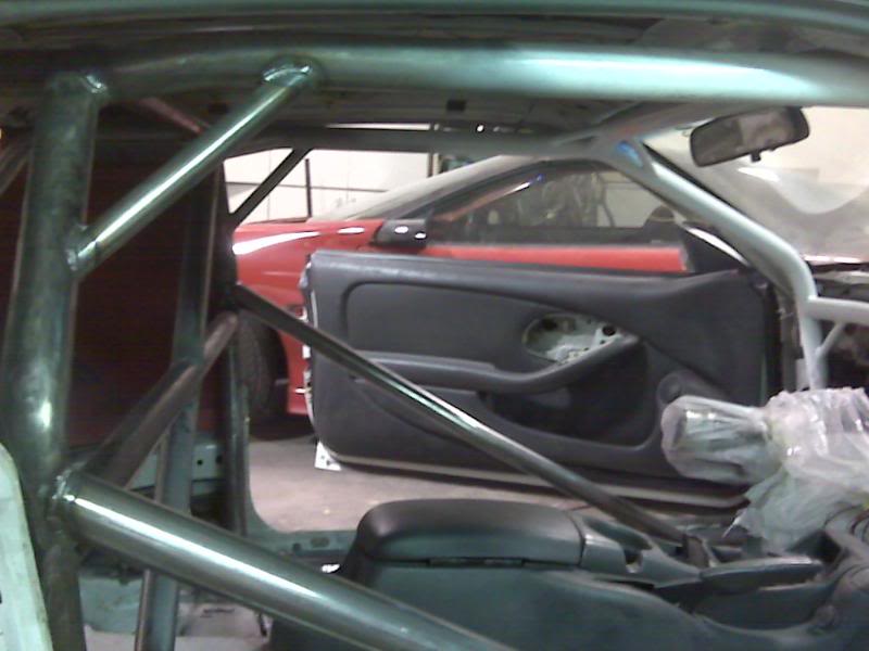

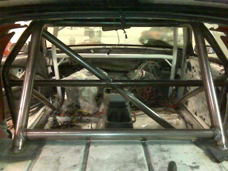

Engine Bay and cage as it sits...

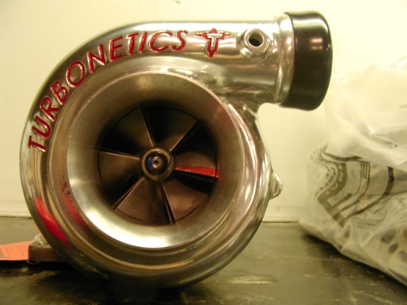

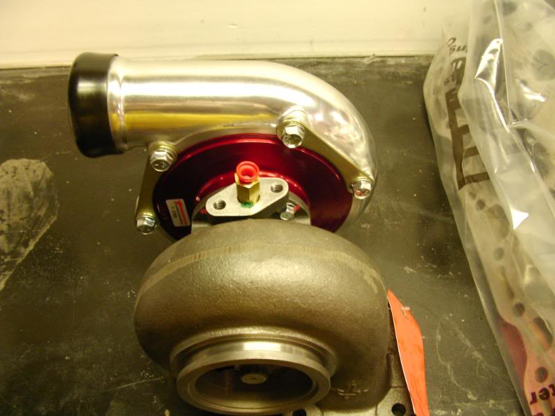

Engine and NEW Turbo going with the TC78 rather than the MP 70 I had in the mock up pictures. also plan on makin 700+ instead of the 600 I started out wanting to make

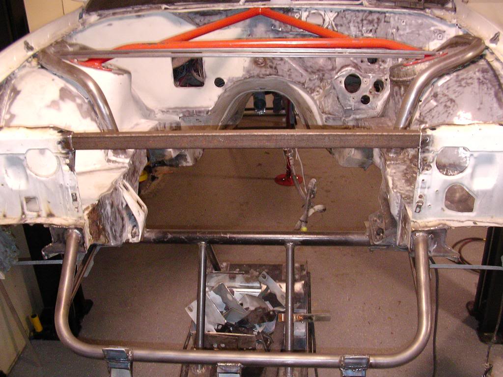

Thats pretty much where Im at... Im smoothing the **** outa the engine bay and once thats painted the engine is ready to go back in! then its assembly time!! I cant believe Im about a month away from starting to put parts back on the car!
