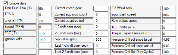

Hello everyone. First of all i want thank Gary for this awesome tool, it come very handy for my car. I own 94 Chevrolet Corsica 3.1 AT. Week ago i had swapped transmission valve body and my car started to stall while placed in gear. It feels like my torque converter is locked and it keeps happened until car gets warmed up. After it warms transaxle works just fine. So i am trying to find problem and what confuses me is the pressure control solenoid amps actual that show 0.02 while target amps is 4.98 . Could someone please tell me those readings on a normal working transaxle?

I can't help much with the diagnosis. But I want to make clear that you may be the first one to use this program on a non-F-body 93 V6 car transmission. So it is possible the readings are wrong. I think they are probably correct, but you are probably the first one to test it.
I would assume that there is either a blown fuse or an open circuit to that valve solenoid. I suppose it may be that the PCM has turned off that current because of an overload, too much current. Are there any transmission trouble codes?

I am also using "tuner pro" and "aldl droid" and i can confirm that your program reads everything correct and can control all actuators. There are no trouble codes from transmission, it only says "illegal range" but i am sure its ok. I thought that maybe this solenoid had stuck in semi open state and keeps oil flow to push clutch until the fluid gets hot and it starts to slip allowing to drive car. And i can`t compare readings with my old solenoid because it breaks in half when i tried to disconnect it. Just wanted to know how this reading looks in another transmission so i could decide to order solenoid or not.

All i need is a screenshot from a transmission tab with engine running. Like one that i posted above.
