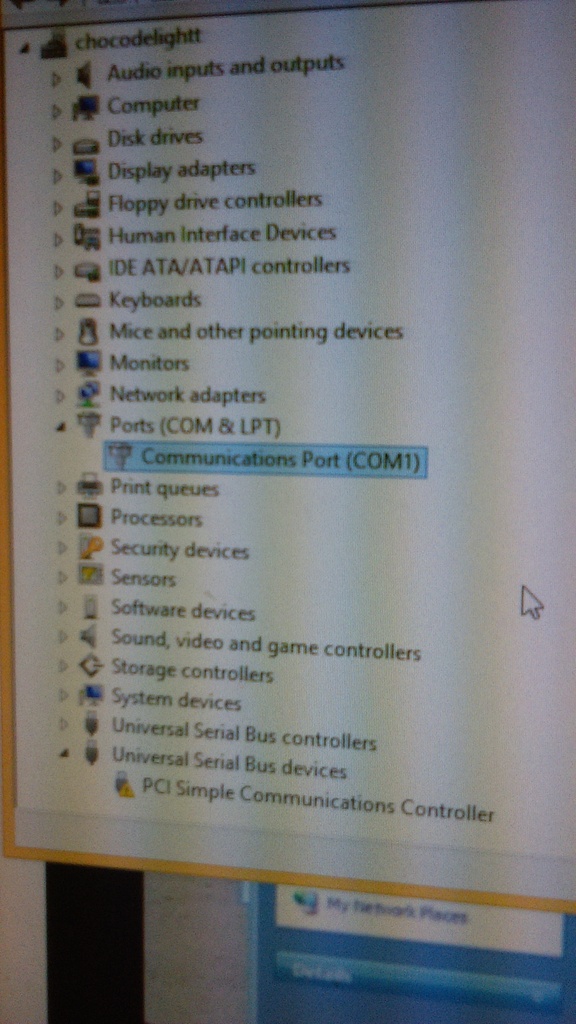

This is what I'm getting on my desktop Name:  IMAG0130_zpsuzmir50m.jpg

It looks like the pci system drivers are bad or not installed on that pc. Do any other USB devices work on this pc? See this video about installing the drivers for that system device:

thanks i ended up buying the devils 12pin and got cd install of right drivers and everything is a ok i am learning more about my car with this software. thanks garry!! BTW to others who are wondering which one to choose whether that be scan9495 or freescan i tried freescan and it is way to complicated for the average DIY mechanic there were also some noticeable bugs when i was trying to perform DTC test on freescan i recommend scan9495 because its easy and it has a lot of good features. there is some stuff that i never knew about my car that i could now see with this program. i am sure there is room for improvement but overall a great program just wanted to share my experience.

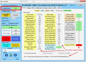

Hi Gary. Great work on the program. I was wondering if this is compatable on my 93z? And if so what adapter do I need? Thanks
Old May 14, 2015 | 08:42 AM
  #263
GaryDoug's Avatar
Prominent Member
Joined: Jul 2010
Posts: 1,521
re: Scan9495: Free OBD1 scan app for 93/94/95 LT1
Scan9495 now supports the 93 LT1. I didn't bother renaming it. The only thing it does not support is the early 93 SIR (airbags) module. But you can get the trouble codes from that using the 93 service manual.
https://www.camaroz28.com/forums/gen...-today-874002/
The adapter is the same as for the 94 (12-pin).
