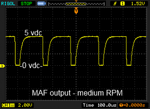

Hello. New to this forum.Have a 1995 Z28 LT1. Had a question with my MAF sensor. I checked voltages on wires/connector OK. When I get to checking the MAF (Signal voltage) it is 4.47 volts (at idle)..When I increase the throttle the voltage DROPS...Is this normal??? I do not have access to the recommended frequency reader.Also, I have the K&N filter. Will this hurt the MAF? I have only had the car a couple of weeks.

When measured on a DC volts range, the meter will show the average reading. The maximum voltage of the MAF output is 5 vdc. It is pulsed to ground for a constant amount of time with a varying frequency. The higher the RPM, the higher the frequency. You can see in these scope screens that the average voltage will drop as the frequency/RPM increases. But that is not the best way to measure the signal.
