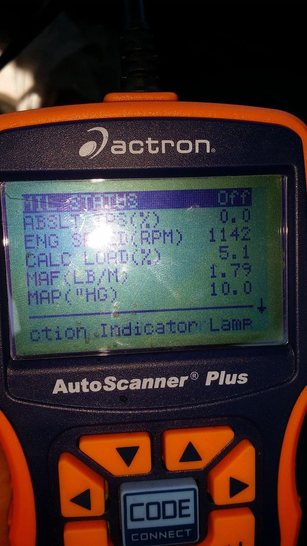

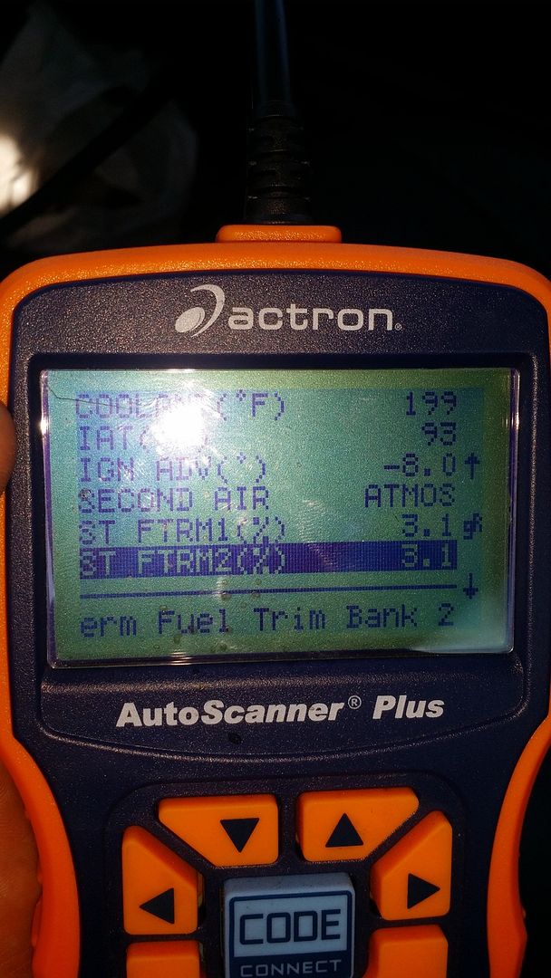

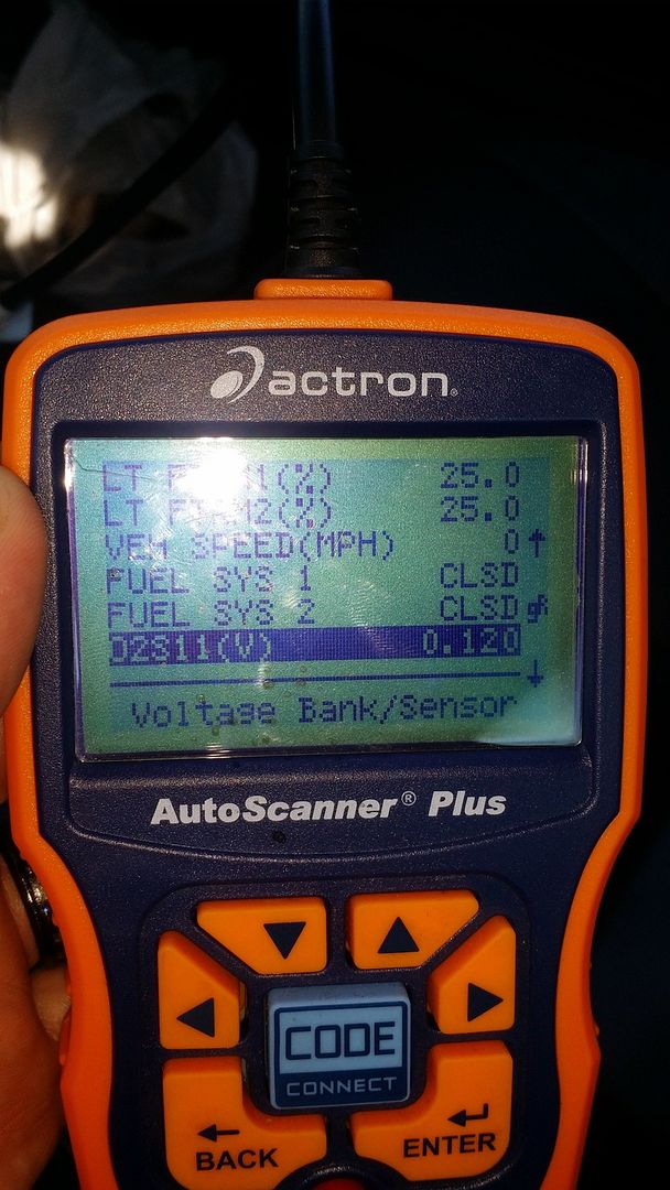

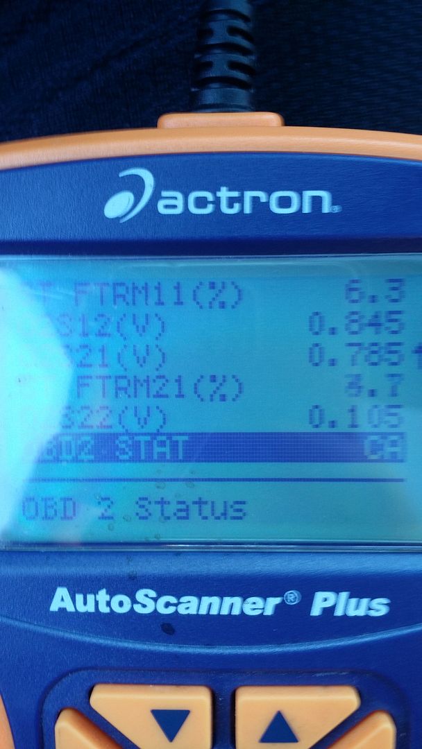

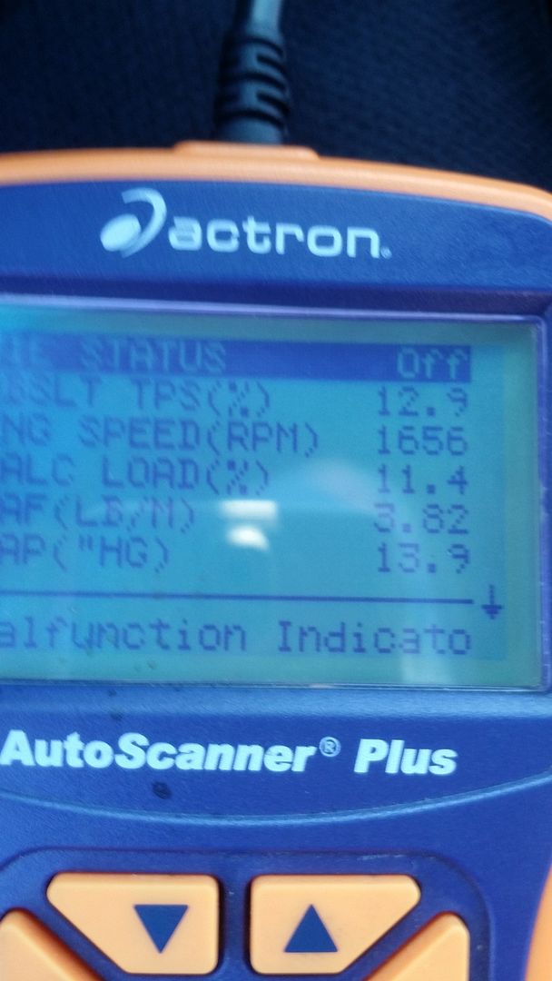

Yes I did clear the codes. And I just cleared the codes again and went for a 25 mile drive and nothing came back up. Thing about that is normally would get the light within 5-10 miles after resetting the codes. But I hooked up a scanner and took a few pictures of at idle and cruising at 65-70 mph. Im working on trying to upload logged data but cant find the cord.
[IMG][/IMG]
[IMG][/IMG]
[IMG][/IMG]
[IMG][/IMG]

Old Mar 20, 2015 | 05:12 PM
lt1matt's Avatar
Joined: Feb 2015
Posts: 13
Re: Need help high idle and a few codes
IAC fixed high idle. No new codes yet. Probably going to need a few more drive cycles to see how everything else goes. Good step in the right direction at least
Old Mar 20, 2015 | 07:11 PM
Posts: 71,123
Appears its maxed out the long term fuel trims, adding 25% extra fuel beyond what it calculates is normally needed. Either the fuel pressure is way low, or there is air entering the engine that is bypassing the MAF. Could also be faulty O2 sensors, exhaust leaks before the O2 sensors, or injectors that are smaller than what the PCM is programmed for.
When checking for vacuum leaks, did you check the bottom of the injectors where they mount in the intake manifold?
