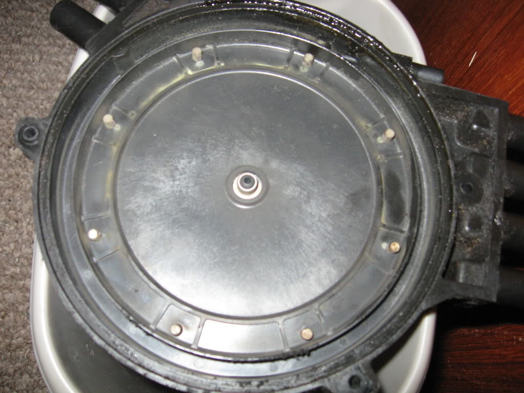

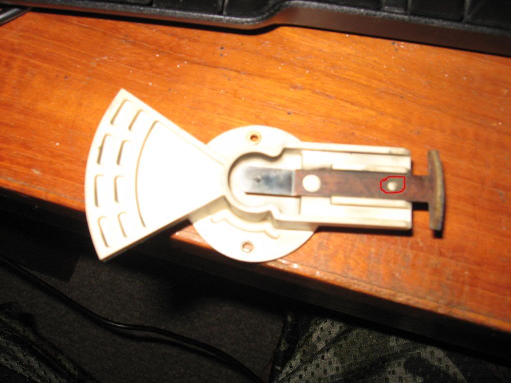

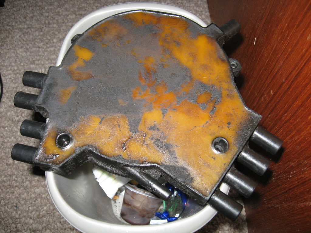

Got everything off , put the new dust cap and rotor on, now my opti harness wont line up with the pins due to the dust cap, tried using different angles and wiggling around, looks like it is a hair or two from lining up. any suggestions? EDIT: Ended up having to use the original dust cap in order for the opti harness to line up and plug in. Therefore I had to pull off the rotor again , pull the new dustcap off and put the old one on , reinstall the rotor. Tomorrow I will be putting everything back together, Starting with the waterpump, already got the two gaskets and some permatex water pump and thermo housing gasket maker. I've never done a waterpump before , Do I just put the gasket maker on the w/p then put on the gaskets and bolt it back on? Thanks for all the replies!
Oh yea, I think my problem was the rotor , the second "button" had came loose . Hopefully everything will work out now. any input is appreciated.

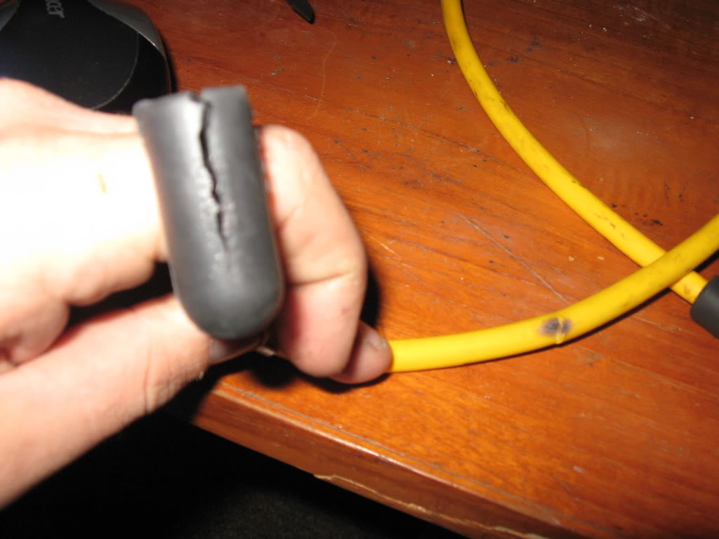

Well I found two burnt plug wires so far, the number 6 and 7, they werent even touching the headers! Also no Idea how the boot got split like this on the # 7

Time to go back to school. Plug wires are the first place you look for misfires. Now you can change them ALL out with the plugs. I assure you at least one plug looks like crap now. This time use tie wraps to hole them where they aren't next to anything. If need be, use shorty plugs and header wrap at the problem areas.

Have you carefully examined all the wires and verified that they are not damaged or burned? The fact that you had a problem in such a short period, and managed to crack one of the boots as well would indicate that the install was not as clean as it should have been. If 2 wires are screwed up, there's a good chance more are. Replace only tow and you'll be back here in a couple days asking why its still missing.

Replaced the two burnt wires and changed out 3 of the plugs. Car is running like a champ for the first time since I've had it. Free of hesitation and misfiration ! Oh I also did the ICM cooling mod, though I'm not sure if it helped because I did it at the same time as the plugs and wires. So its fixed in open loop..The car is running better than ever. Its never been smooth like it is now. What If I leave the driverside O2 unplugged? bad mpg? Is the pcm still reading off of the passenger side o2? Im guessing its the original w/129k miles on it , I know I should have replaced them both because I replaced the passenger side about a month ago it smoothed out tremendously,
