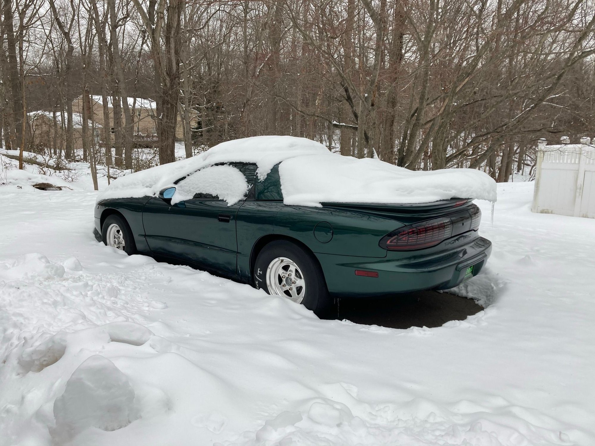

I suffer from the same problems. My car has been sitting for at least 8 years. The tank had a mix of 94 octane pump gas, and a VP Fuels blend for the 300-shot of nitrous consisting of highly leaded C16 (R+M/2 = >118) and Air Race (airplane fuel). No stabilizer. I'm tempted to cut the hatch, but 1) old age - mine - is an issue, and 2) the rear braces for my roll bar will require the agility of a contortionist to work through it. My preferred solution is to flatbed the car to the shop that did most of the work, and let them drop the tank, clean the injectors, etc., and go through the engine at the same time. Then sell it. But the COVID thing caused me to hold off. I might try selling it at a reduced price “as is”. Pretty sure someone could part it out for at least $10,000.
Right now it's in a snow bank where it's parked. I had a collector who claimed he was interested (he has something like 64 cars) so a buddy and I pushed it out of the garage and I cleaned the dust off it. Still looks like brand new, but I hate seeing it sit outside.

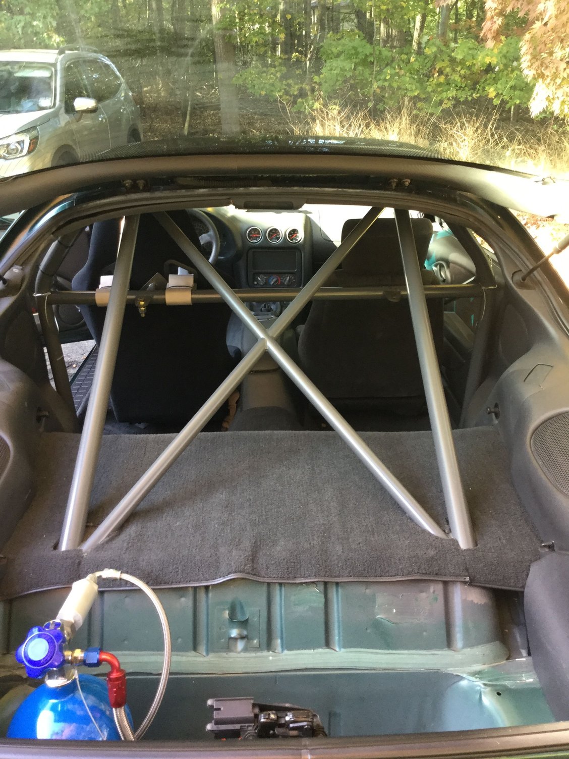

The X-brace seemed like a good idea at the time:

Injuneer, that brace would hamper things a bit in general, but it appears to be out of the way of the area needed to cut the trap door if you went that route. I do understand many folks don't like the idea of the trap door and I can respect that. Your car is in nice condition and you are thinking of selling, so it may make sense not to cut it. On the other hand, you've modded it with the braces, and are pretty far away from stock and a buyer may look at the trap door and easy access to the pump as a plus.
