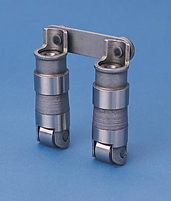

Just a thought but has anyone tried Crane lifters? I've been from stock to Comp R to Crane and like the Crane lifters the best so far. If I would of know before I purchased them that I could of used any lifter with a .842 diameter I would of went with these
Crane 144530 http://static.summitracing.com/globa...44530-16_w.jpg
What I really like about these is that the roller part is completly open on both side even the Comp-R's lack this important feature that would benfit anyone with extreme ramps on the cam. LSx lifters are a direct replacment for LTx lifters so that opens some more doors.
Jason
