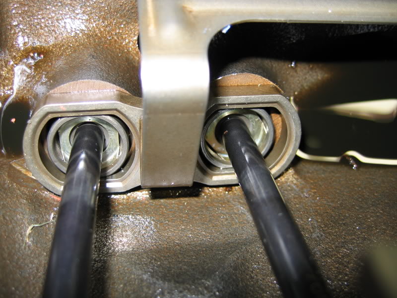

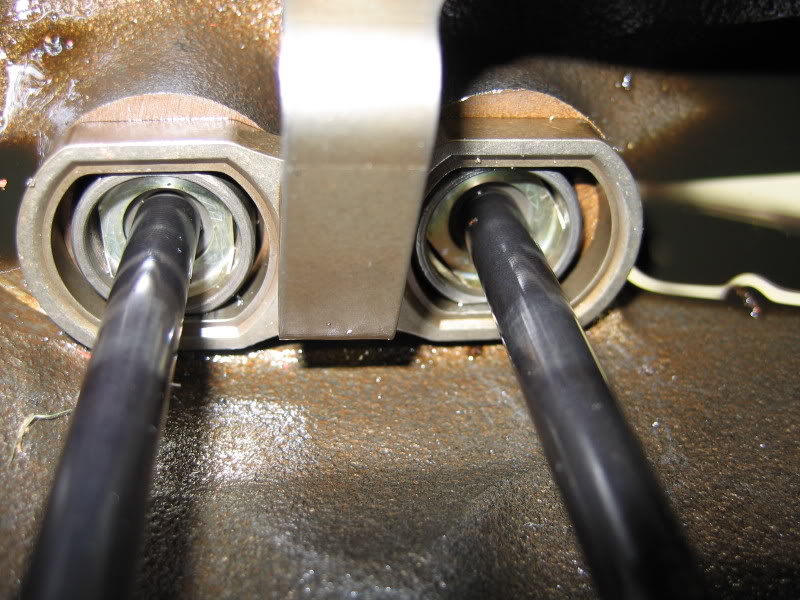

Pulled my intake the other day and all my comp r's were still together.
Are these the old style or newest style retainers??
