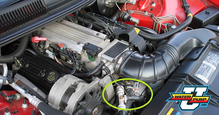

Just brought the car home. Wasn't getting fuel, and while replacing battery and doing some diagnosing, my gorilla arms busted this T fitting circled in green. Appears it comes from the water pump. The schrader valve confuses me. Is it an A/C cooling line? Sorry for the ignorance, i'm new to the Camaro life. I looked at it briefly, but cannot remember where the two larger lines go. Being that they are crimped lines, makes me think they handle high pressure. thanks in advance!

Not a Schrader valve. That's an air bleeder valve for the coolant system, on the heater lines. Shoebox has a photo and a diagram of the hoses.
Hoses - see parts #4 and #5:
http://shbox.com/1/heater_hoses_93-94.jpg
Bleeder valve - Shoebox's 95 is slightly different than your 93, lacking the third hose out the side:
http://shbox.com/1/bleeders.jpg
Bleeding air out of the cooling system is critical with the LT1 engine, due to the use of a "reverse flow" cooling system (coolant from radiator is directed to the heads first, rather than the block).
