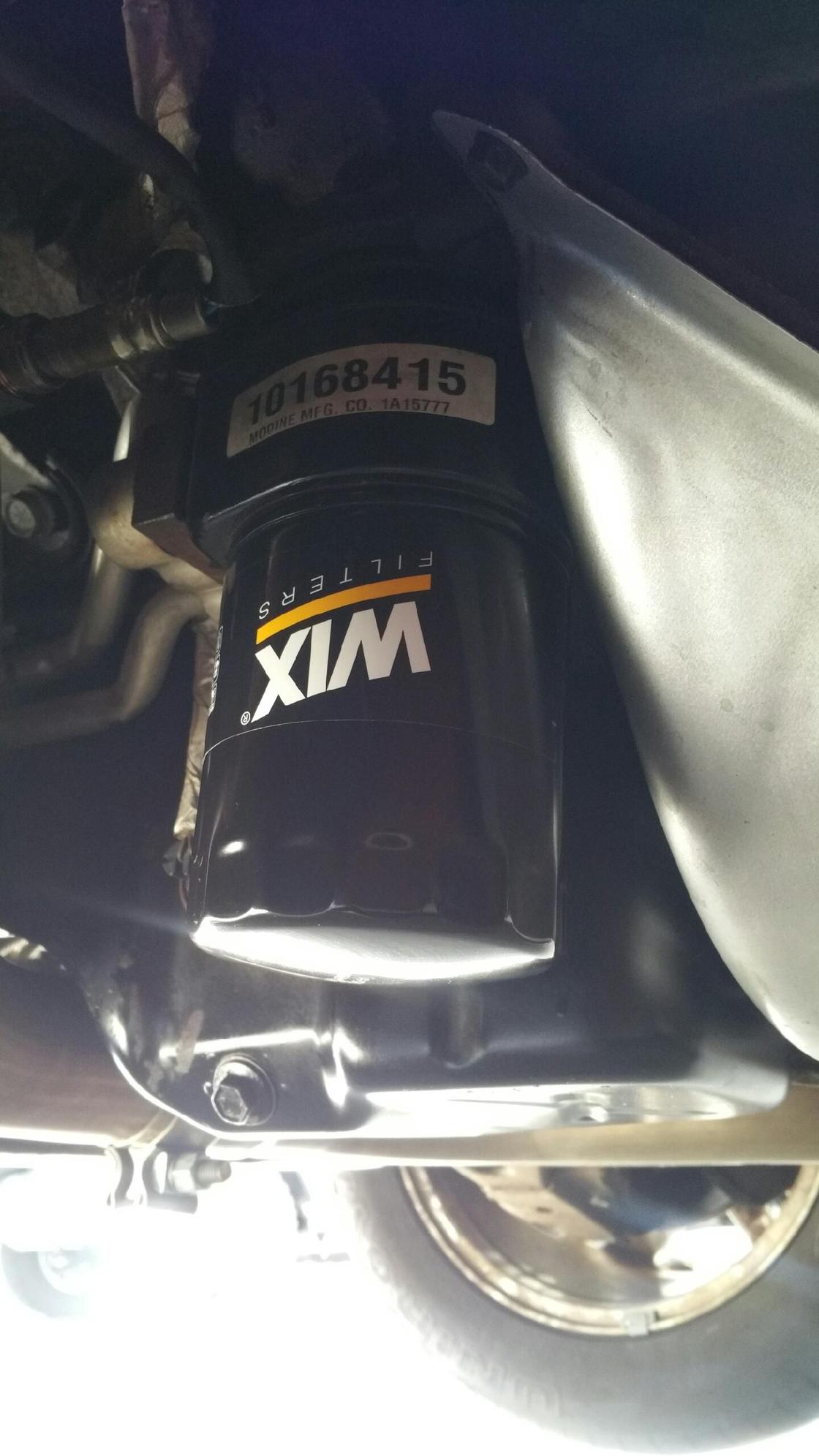

You have to block the connection on the water pump. If you still had the connection on the radiator, you would need the factory bypass hose, #16 in this diagram from Shoubox:
http://shbox.com/1/93-94_hoses.jpg
With no connection on the radiator, the diagram will at least show the location of the water pump connection you need to block.
At the oil filter, you can remove the cooler, install the correct fitting for the filter to mount directly to the block. But if you keep the cooler, no need to block the coolant line connections.
https://www.camaroz28.com/g/picture/8154201

So if I'm understanding this correctly if I block it from the water pump and just don't run any lines I should be alright correct? And let me know if I'm misunderstanding it but i would block it right where part 29 attaches correct? Or I could remove the cooler and fix it where the filter mounts to the block?
So in theory I can just block the line from the water pump, the bottom line, and just leave the cooler on and my motor would be fine right?

Correct - remove oil cooler coolant lines, cap the water pump connection at part 29 location. You're done.
Some people feel the cooler itself can cause problems (plugs up, causes pressure loss, etc.) and physically remove it. I've kept mine for 26 years since I bought the car new in 1994, and never had a problem with the oil cooler. I have aftermarket oil pressure and oil temperature gauges, so a problem would be visible.
