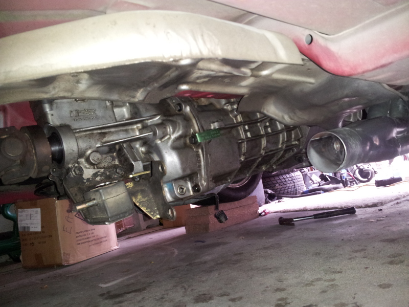

finally did the install on Sunday. after i bolted down the kmember i quit. i was beat and didn't wanna do any more!
got the tranny crossmember, front sway, driveshaft, and slave cylinder bolted on today and realized the root of the problem.....
at first glance, this was my passenger side header
then, with the tranny crossmember holding the tranny in the correct angle
was gonna put my alternator back in and do my oil dipstick( which i wish i did when the motor was out), but i was little passed when i noticed the header, Haha

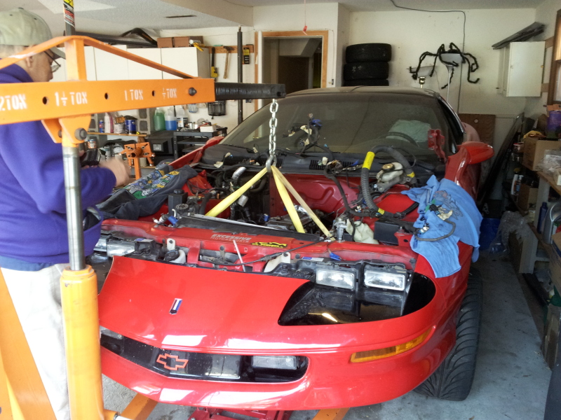

if i can do this in my garage with two jacks, a motorcycle jack, an engine stand, two engine hoists, and a simple craftsman 220pc mechanics set, ANYONE can
