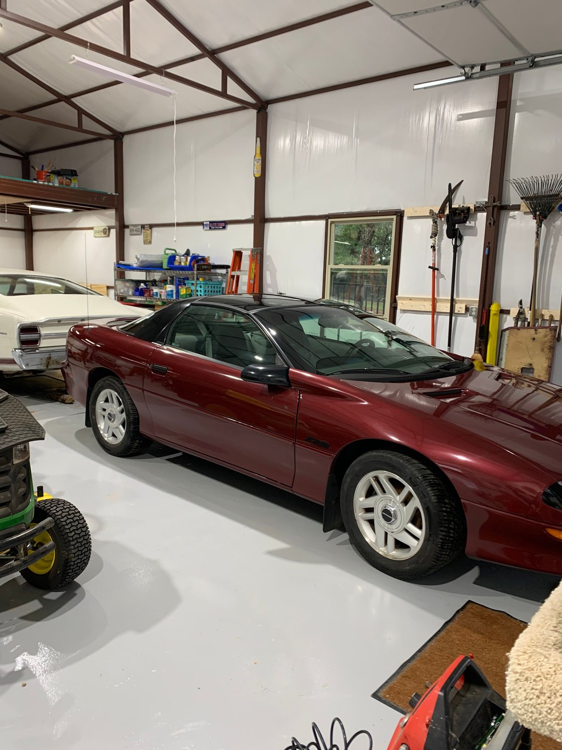

Yes, 93 Z28
it was in storage for at least 7yrs.
