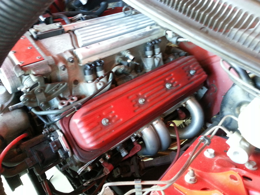

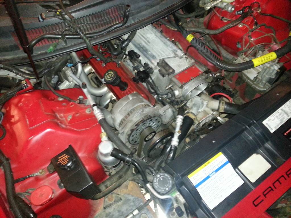

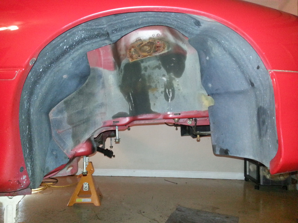

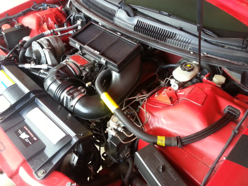

I started yesterday. ramps under the back wheels, big jackstands up front
removed ypipe to free headers
pulled everything electrical off and pulled it up to the windshield
unhooked fuel lines
drained cooland and removed hoses
cold air intake off
battery out(cables stay with the engine, just slid them down through the bay.
Im waiting on my bro to bring over his cherry picker as i sold mine thinking i wouldnt need one anytime soon. go figure. I didnt need to do this in the first place but i got bored.
I still need to figure out how im disconnecting the ac, brake lines and power steering. Ac is full but doesnt cool. just ordered the delete pulley.
Leaving the wheels on when i drop the engine out the bottom, will a jack be good enough to pull the drivetrain out using the wheels as support? as well as something under the trans?
Will be updating with pics later, my phones downstairs so i cant upload them atm.

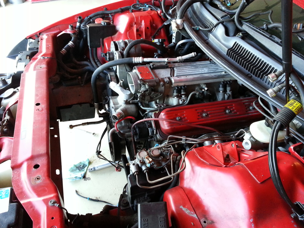

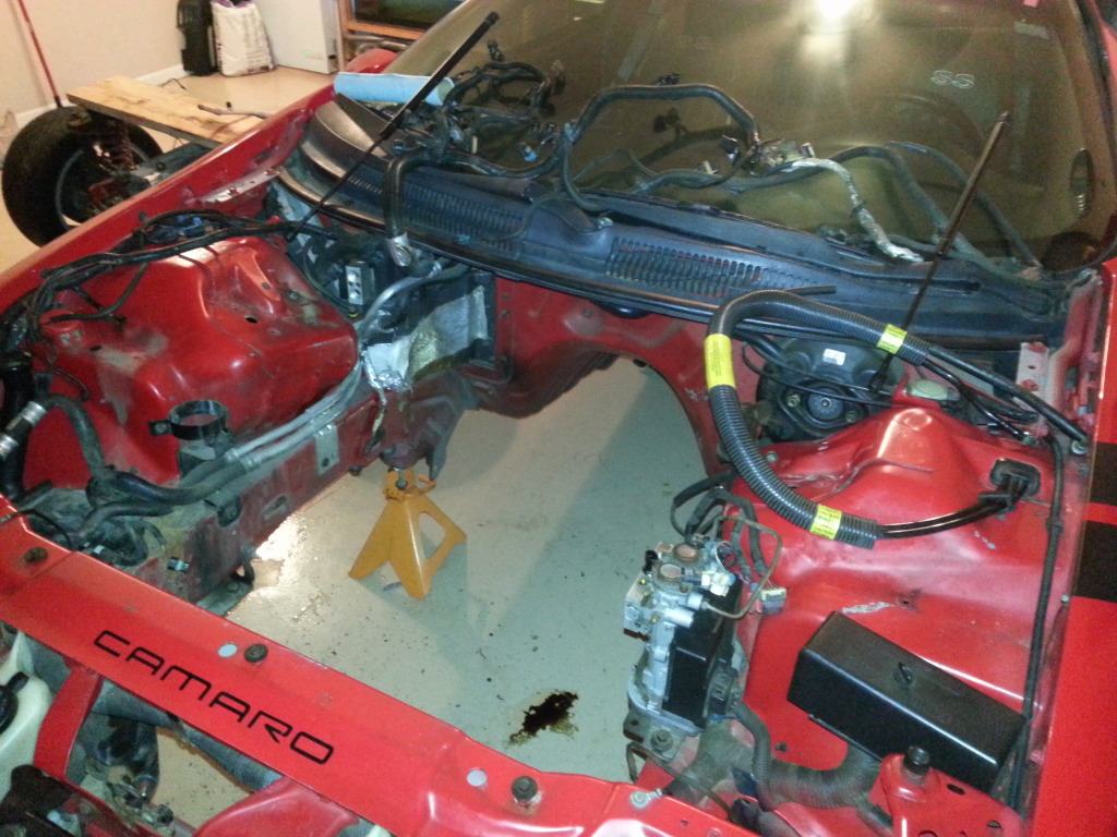

ive been reading a few different threads about it. trying to do it the easiest way possible as everyone does it a little different.
Im about to discharge the AC and figure out where to disconnect the brake lines, loosen everything up and wee what happens, still waiting on the engine lift but might see if i ca get it high enough without it using my jack and some wood.

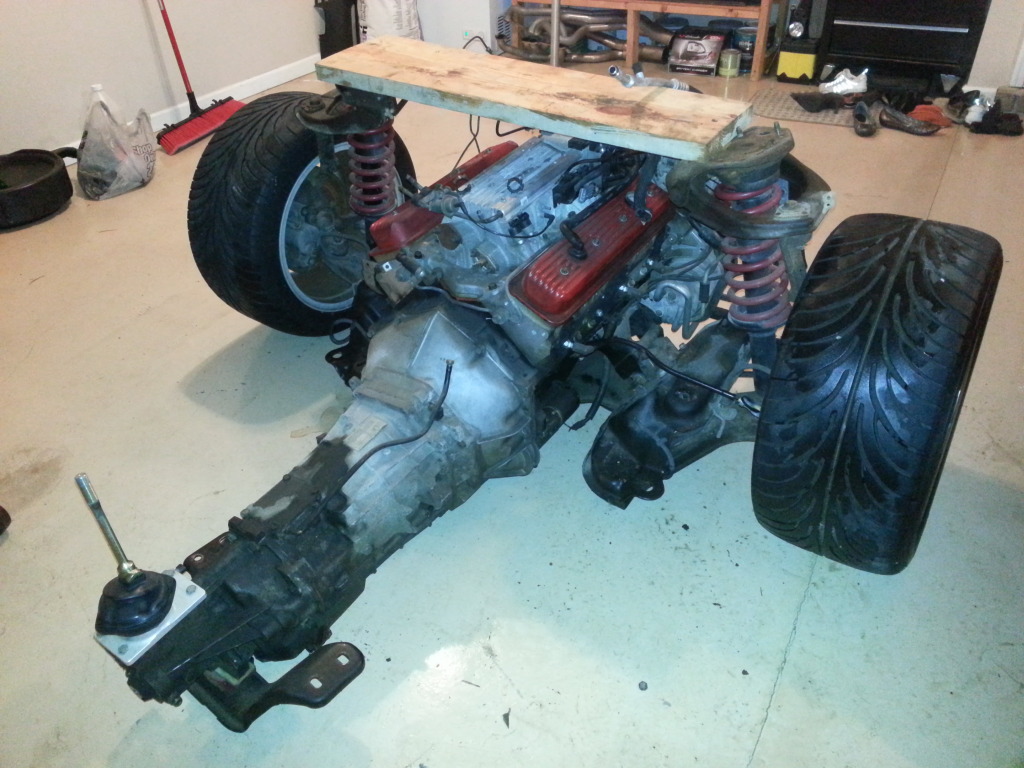

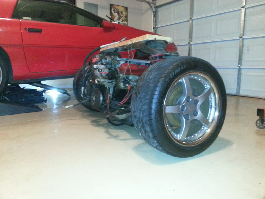

Well, its out. finally got my hands on a cherry picker and got it out on thursday. only issue was one of the strut mount bolts on the pass side. the nut thats mounted to the underside broke loose and we had to cut the bolt off the top and pount it through. gonna need a new upper a arm mount. thinking about removing the entire ac/heat box for a cleaner look.

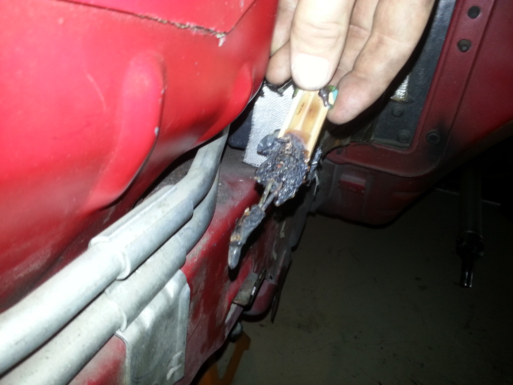

this was one of the issues i know i had and needed fixed. the plug was melted too bad to get it apart so i just cut it. ABS sensor wres
