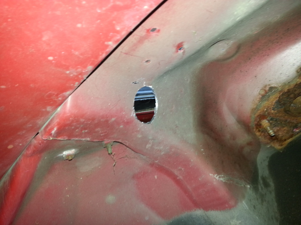

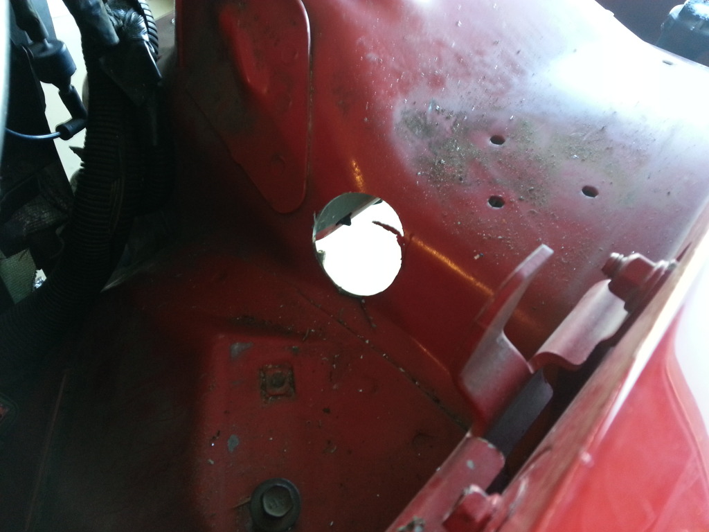

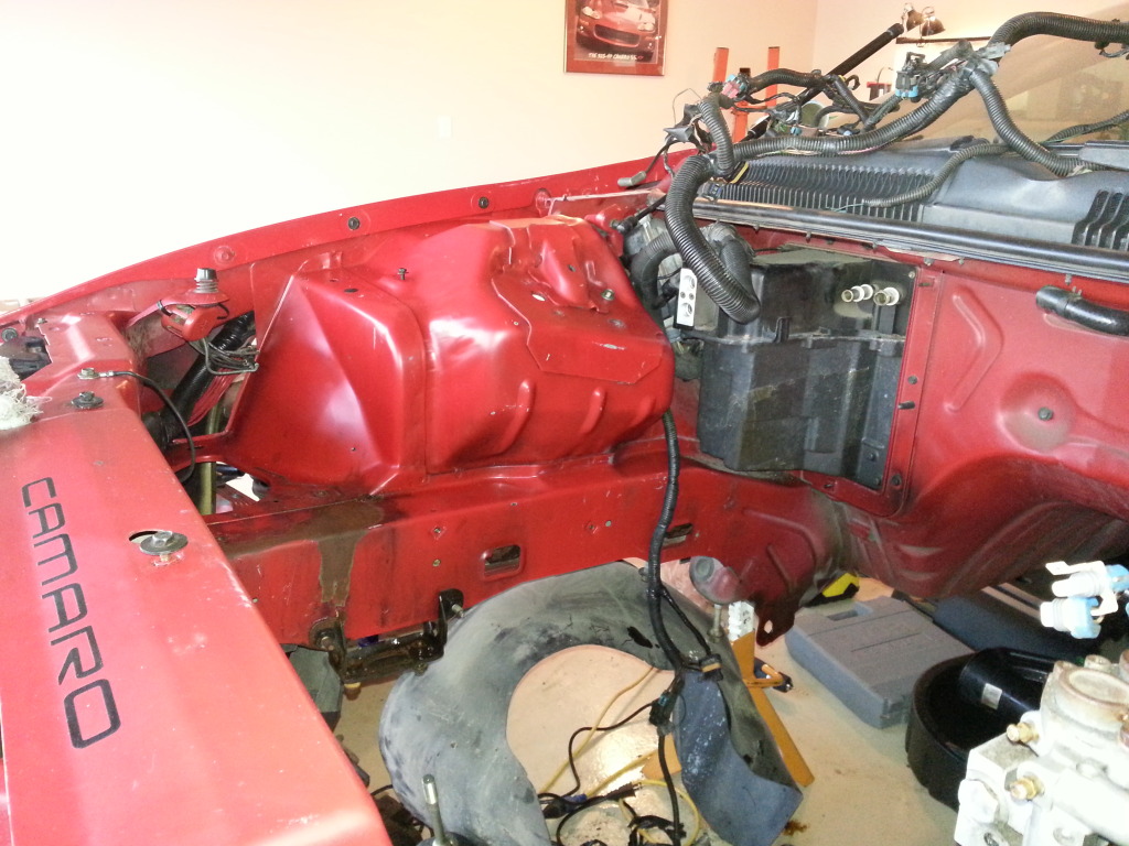

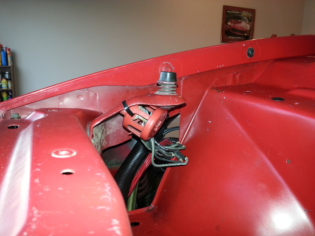

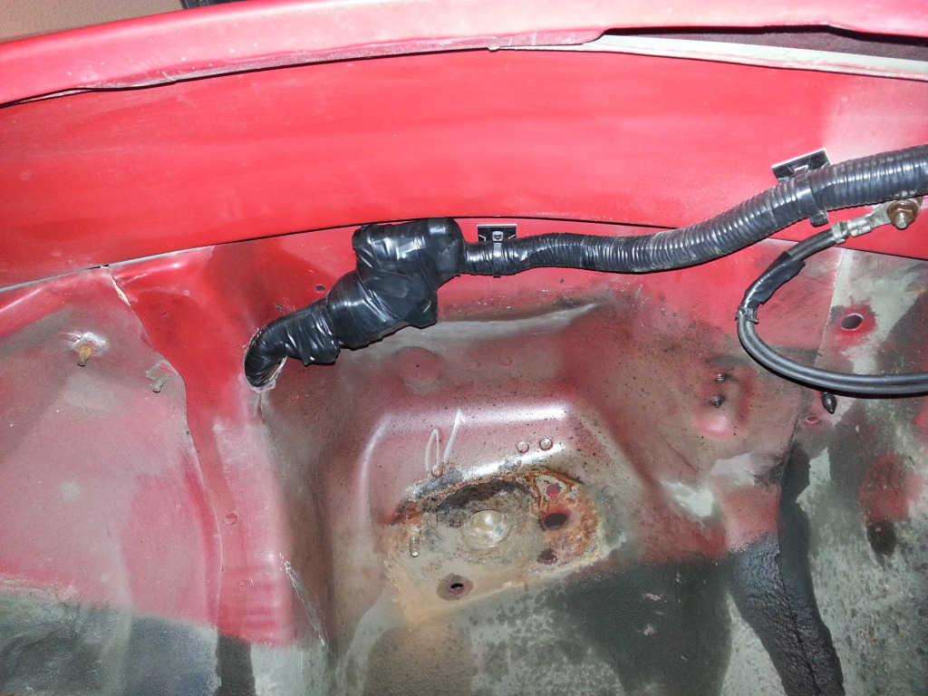

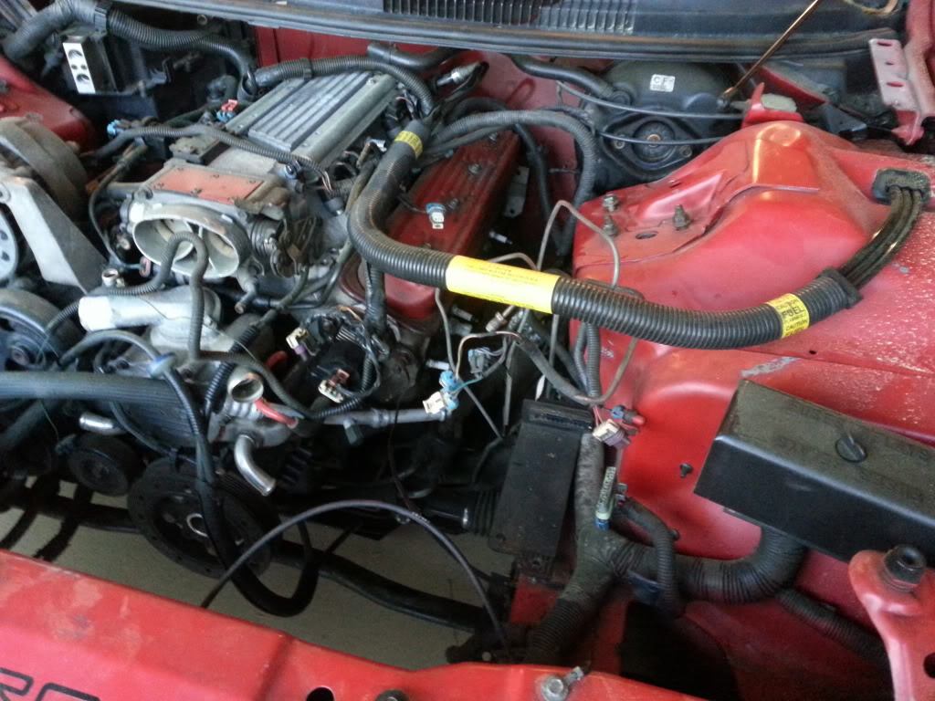

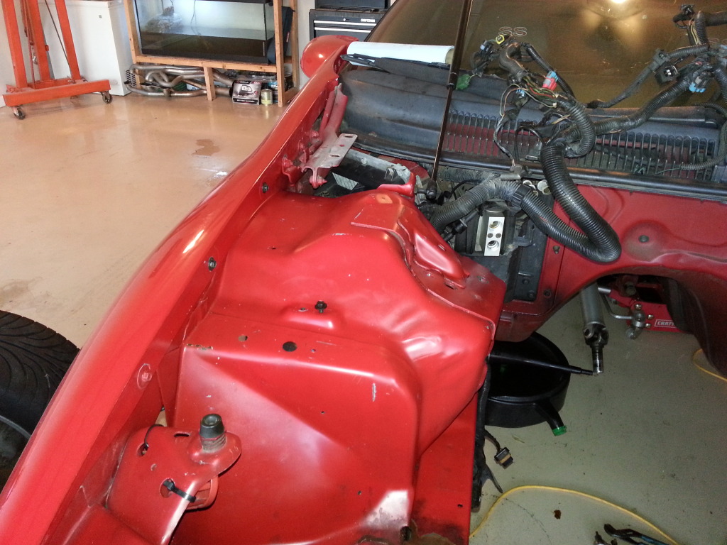

well i made a little progress with a few things. i got all the heating and ac lines out. I did the !wire mod. and working on the !fuel line and !hood latch mod. I will prob go back and tuck the wires better before i put it everything back together. Cant wait to ditch those fuel lines next. Has anyone relocated the fuse box at all? Doesnt look like it can go far

That is a clean looking car, keep us posted on the progress.

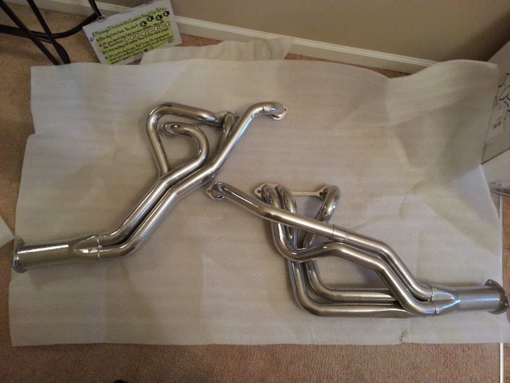

haven't updated this in a little while, but I did reinstall the engine to move it out of the garage. Hadnt done all the work I wanted to before doing so. but I needed the garage for my new baby. 13' ZL1 Vert M6.

I ordered a new optispark, this one that went bad was a Delphi from 2008 when I installed my cam and installed the waterpump drive seal wrong, oil had been leaking out slowly since and filled my opti with oil.
I ordered a black and red chandler motorsports brand with lifetime warranty for 135 shipped. seem to have a good rep going on these.
