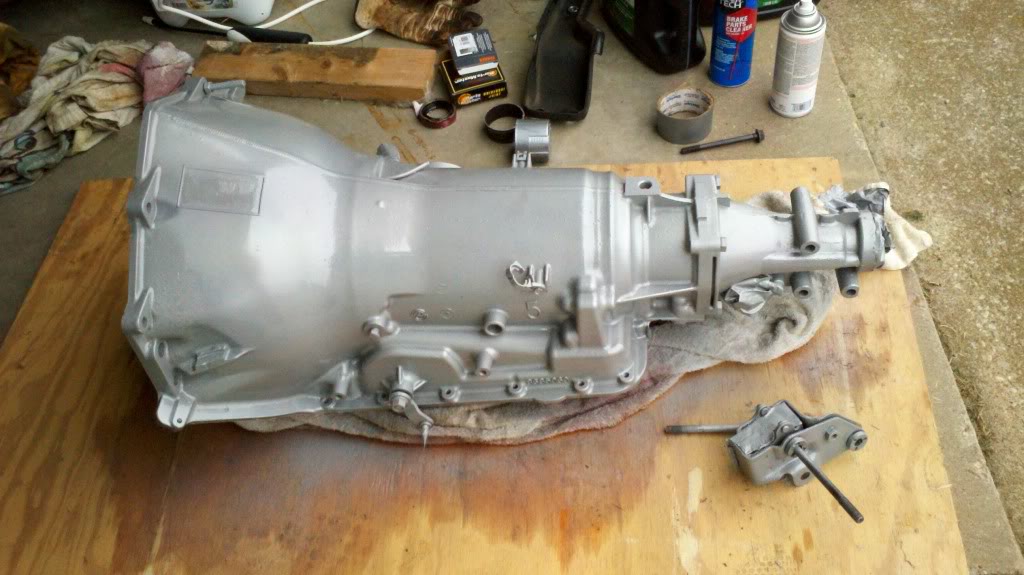

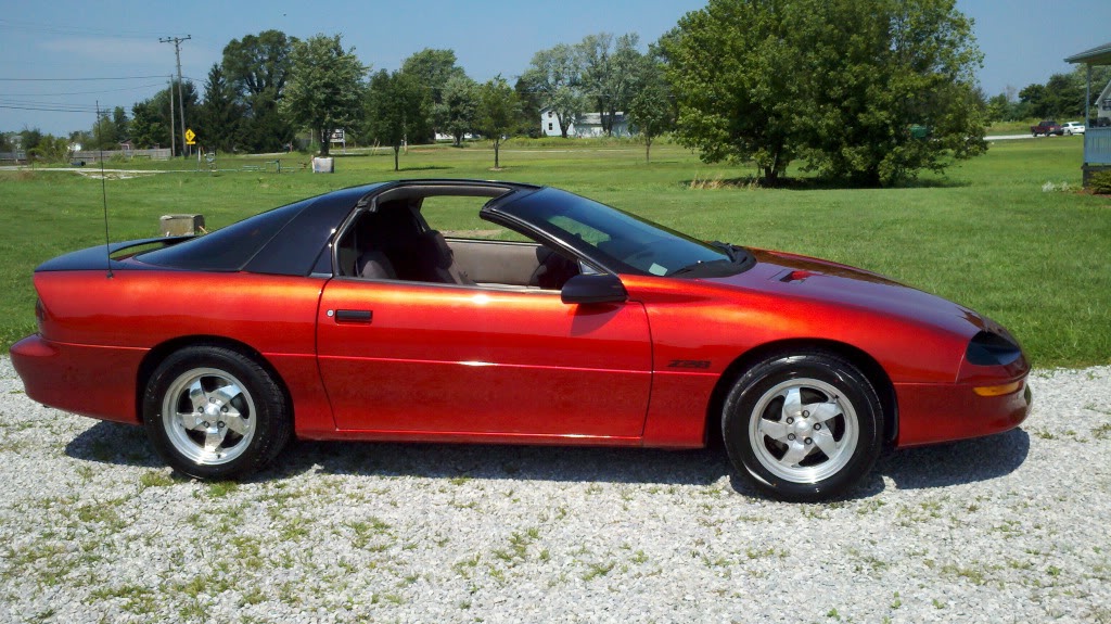

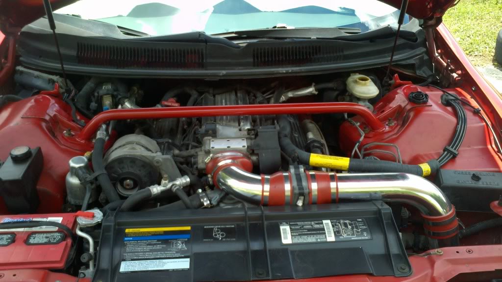

hey guys how it going. i have a 94 z28 camaro. Dont have alot done at the moment. 10.5 mm plug wires, drilled and slotted rotors with ceramic pads, Front strut bar, Cold Air Intake, Freshly rebuilt tranny with shift kit, new pacesetter long tube headers and y pipe with magna flow cat back(not installed yet). Im looking to put a cam in it. I have asked around and i have been pointed to the lt4 hot cam. Im not looking for a big cam, as this car will still be a normal driver. but what roller rockers and valve springs should i use with it. also im not looking to spend a **** ton of money. any pointers would be great. thanks guys.
