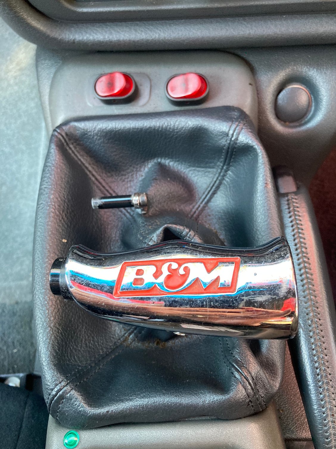

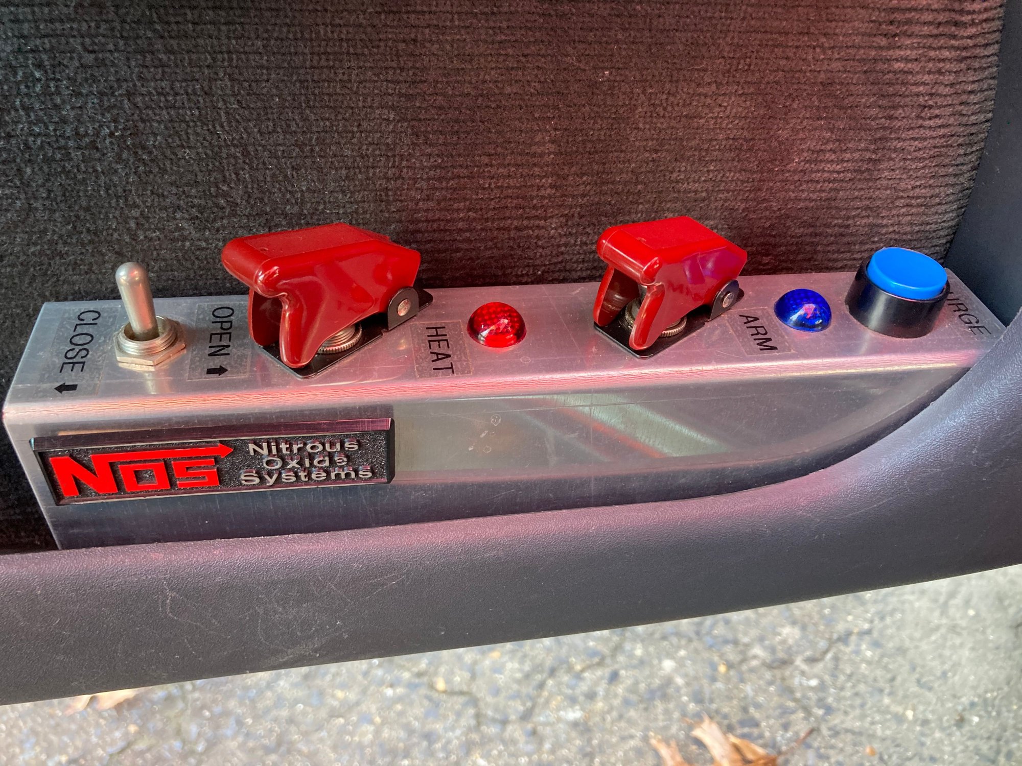

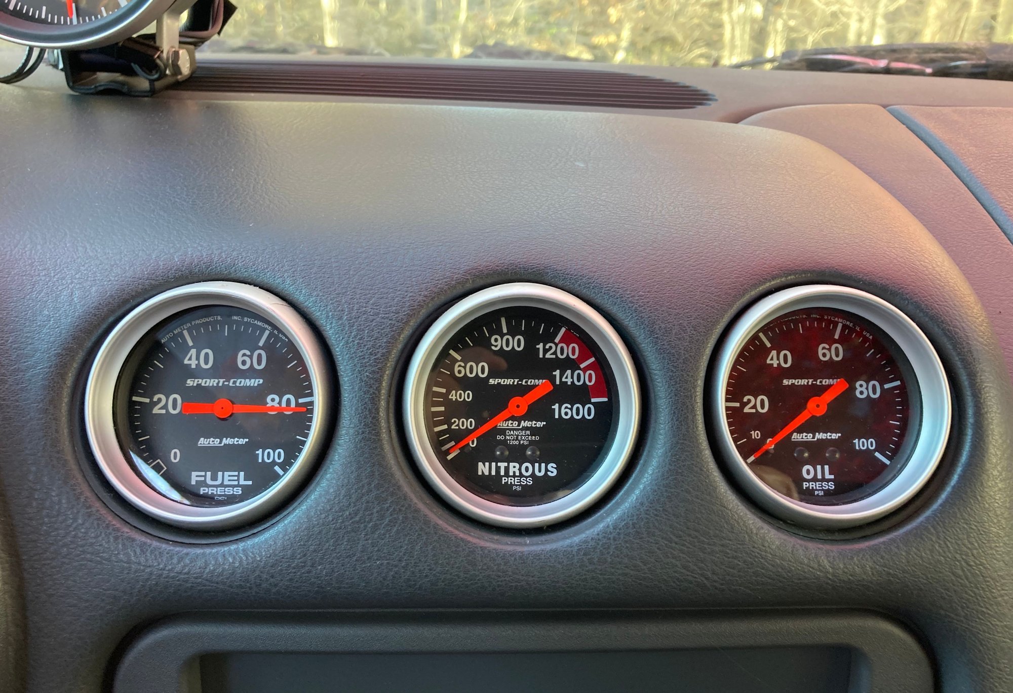

With nitrous BSFC goes up, and can exceed 0.50 #/HR/HP. What you need in the way of a fuel pump depends on what type of nitrous system you are running (wet or dry) and how you are adding the extra fuel. For my setup with a 275 HP dry shot, I added an outboard 208 LPH high pressure Bosch pump, pulling off a sump at the rear/bottom of the stock fuel tank. That pump only ran when the nitrous system was armed. Flow from both pumps was combined before the fuel filter. Injectors were high impedance Bosch 74 #/HR, and I was using MoTeC engine management system, not the stock LT1 PCM. But it got awkward because if you need to run high octane racing fuel it means you have to change the fuel in the tank,

By mentioning the stock PCM with regard to dry nitrous, I was pointing out there are limits to how you can properly tune for normally aspirated operation, and also for nitrous, particularly with a dry system. That's why I chose to use an aftermarket ECU that could be tuned to perfection normally aspirated, plus independent tunes for a single stage (125 HP) of nitrous, plus a second stage (150 HP). Can't do that with a (tuned) stock PCM. Ignition timing can be addressed somewhat with an external retard box. A window switch (can be set to limit the RPM and/or throttle % at which the N2O can be activated, and when to shut the N2O off. You can’t spray a lot of nitrous at low RPM. It will build cylinder pressures that damage pistons, ring, and heads.
