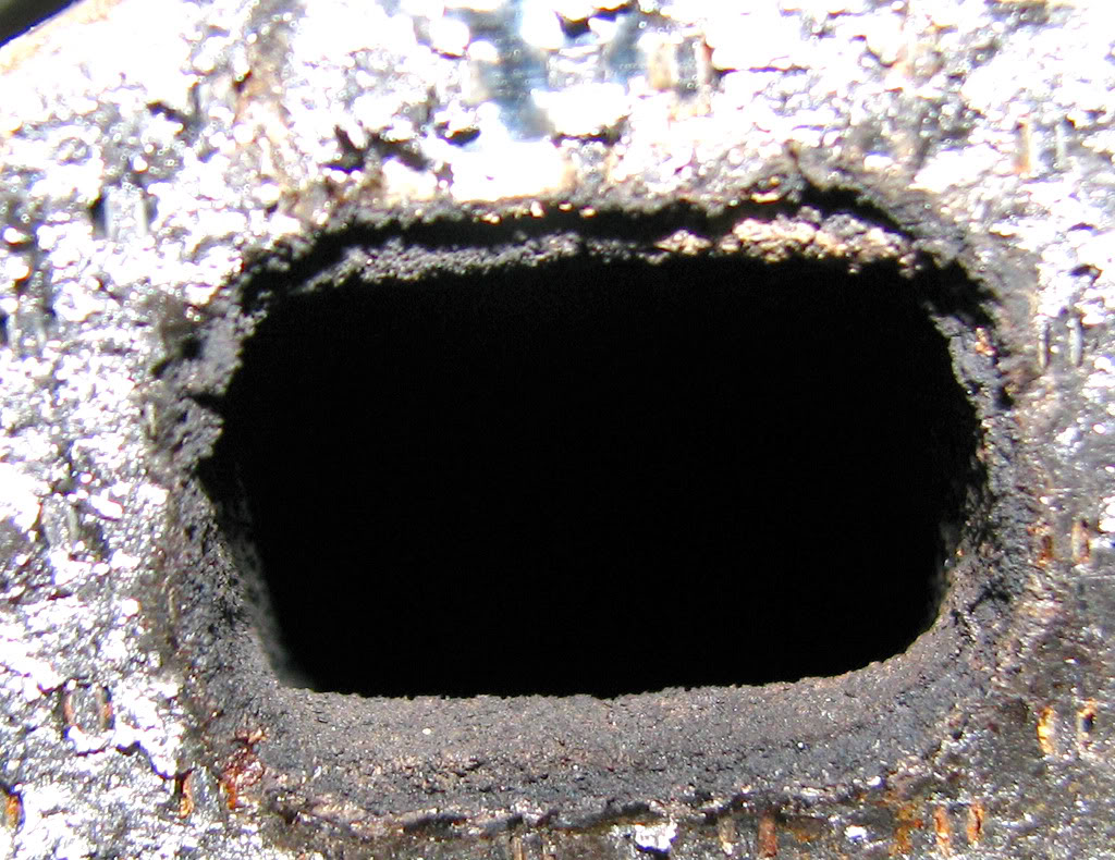

NOW EGR valve is a negative pressure one by the Stamp marking.
Vlave looks normal for a exhaust stuff here are the pictures
Now diaphragm take bit a force to push in by fingers
Here are the pics
I was thinking about making it clean with brake Cleaner spray ??

I have tried using my mouth
and I was barely able to move it.NOW EGR valve is a negative pressure one by the Stamp marking.
Here are the pics
