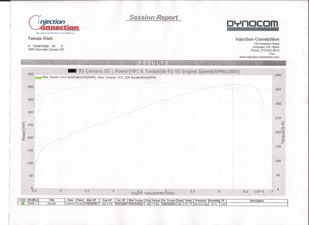

Crazy news, the car has made 412 rwhp. It also has an incredible flat torque curve through the rpm band. This was achieved with 1.94 valves and a $750 port job!
Guess what, it has room to grow if I add full roller rockers, 1 3/4" headers and a larger TB! This thing can easily hit 450 rwhp!
Great job Tony at headbytes.com!
The guys at the dyno shop were very surprised and said they would of never thought the cam choice would work this good, but guess what, it did! I will post a picture of the dyno sheet tomorrow.
Come forth you "nay" sayers!
Here it is =)

Originally Posted by Shangrila
Here it is =)
Something(???) is wrong with this dyno chart.
Any "ole" engineer/engine builder can tell you that the conversion factor between HP and TQ is 5,252. What this means to anyone looking at a dyno chart/graph is that the HP and TQ curves ......... must cross (i.e. be equal) at 5,252 RPM.
The above graph has HP equaling TQ at what looks to be approx. 5,800(?) RPM and that is just ...... wrong.

They won't cross @ 5252 rpm when the scales for HP [left] are different than the TQ [right]
That car won't just easily hit 450rwhp, it'll never hit 450rwhp.
I give it 2 out of 5 stars on my 'meh' rating. Marginally better than a CC306 with LE1 heads or GM847 with 185cc AI heads.
At least the TQ is flat, but I'd rather see some track times. Dyno sheets in racing matter like calf size in the UFC.
As correctly stated by Bersaglieri.... any "ole" engineer knows that they must cross at 5,252RPM if both torque and HP use the same vertical scale. In this case they do not.
Good catch! The problem with being an "ole" engineer is that the eyesight is one of the first things to go.
Let me see some dyno results with your claims. I looked at a lot of combinations and I know that LE1 heads will not come close to these numbers and AI and all the others I can only laugh at with their cookie cuter heads all running 56cc exhaust ports on a lt1. Guess that explains why everyone is going with split duration cams when using their $2k+ heads.
I am tempted however to take it to 450 now that you said that, all in good time. First I have to address the rear. I can assure you it will hit 450 but for now I am very happy with it.

So you see my heads is in the ballpark of LE3 and he is getting this with a TB which I don't even have yet or a full roller rocker set or 1 3/4" headers.
