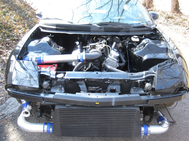

A few have been asking for pics so here we go. I'm in the middle of the full wire tuck on everything in the engine bay. Only thing not in the pic is the brake master cylinder and hard lines that will run straight down, and also the battery cables, which I'm still trying to decide exactly how I want to run them. I still have to mount the fuse box and build a box around it after I run my intercooler piping and know exactly where I will have room and obviously finish tying up the wires. Also later this week we will be filling all the holes in, smoothing the cranks/etc, and painting the engine bay. :headbang:
Once finished the only wiring you will be able to see will be on the motor, which will mostly be tucked/hidden also. Next project will be getting rid of all the wiring under the dash that isn't needed.

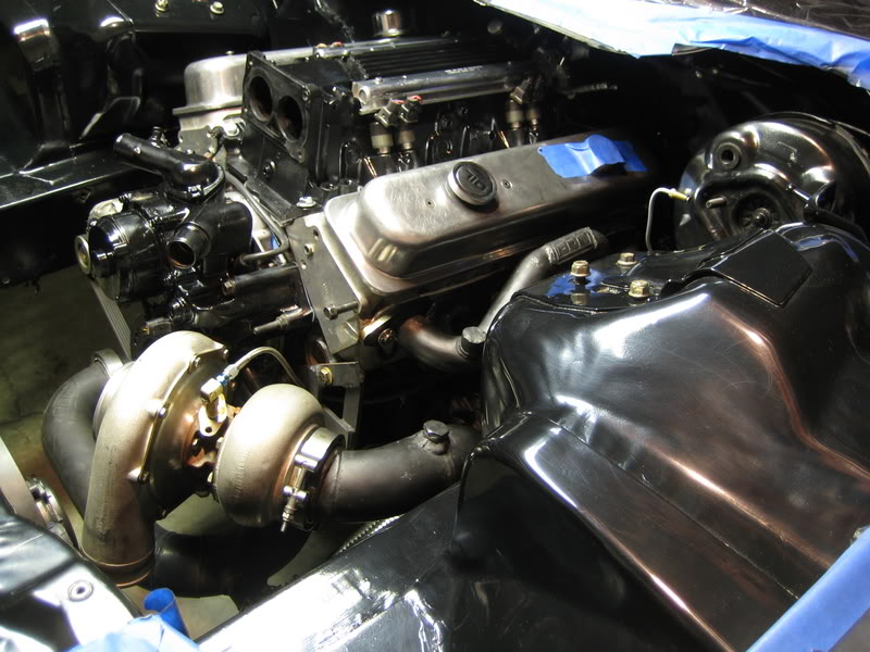

Entire wiring harness is in the car in this picture believe it or not

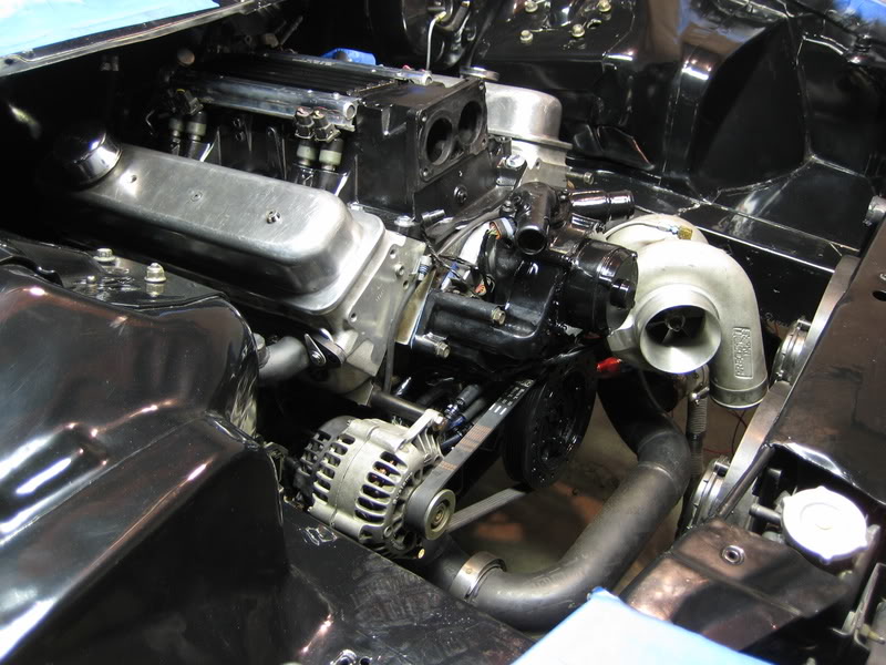

Coil relocated to hide it better

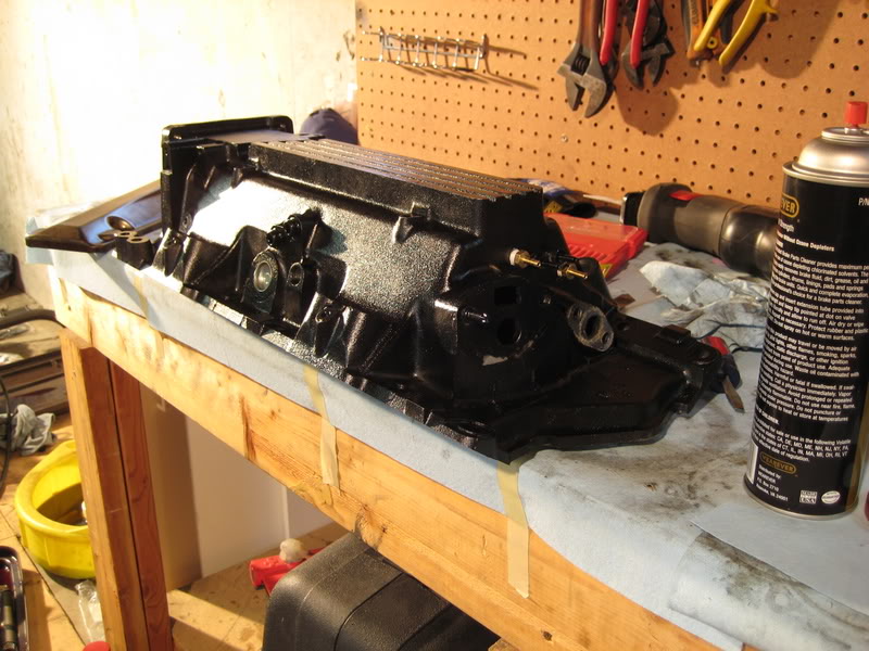

Intake modified, NO vacuum fittings on the side other than the brake booster one, also map sensor relocated to the rear.

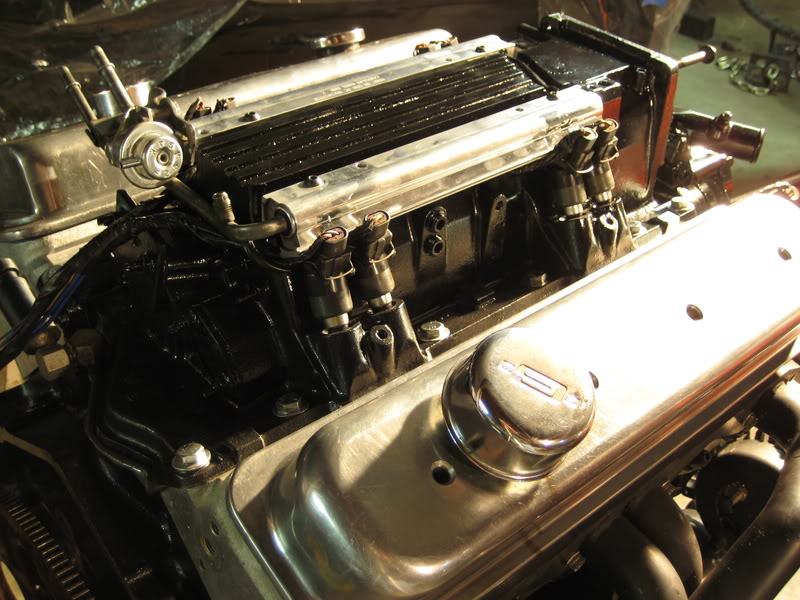

Custom harness setup with the wiring tucked under the fuel rails, this came out as a very clean setup.

Sorry I didn't get more pictures up, I mounted the pcm under the dash, ran the wires through a hole directly behind the motor. We also filled all the holes in the engine bay, plated and filled the big hole where a CAI would normall run, stood the radiator up(for a cleaner look) with slim fans, and much much much more.
