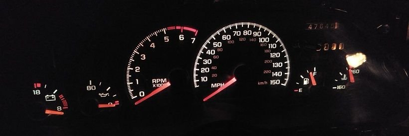

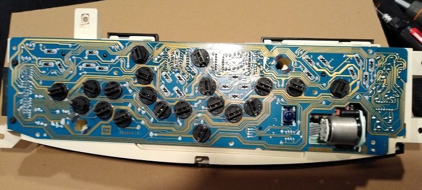

like i said a lot of lights not working in my instrument panel, i took it off tested all the bulbs and they were all good, so i cleaned all the corroded contacts and got them all working but now the brake light is on, does this show up in the computer log?

Scan9495 will read the ABS computer (EBCM) on cars WITHOUT traction control. You have to select that system to scan it. There should be a tab for it. Will also read SIR (airbag) system.

i think this has traction control, because i one time spun the tires in the rain and i remember the traction light came on, also the holes for the "abs inop" & "skip shift" don't have sockets for bulbs.
so is there a way to turn the brake light off without pulling the bulb? (this would be for a temporary time)

Does the service parts label have RPO “NW9” on it? Is there a black device sitting on top of the driver side valve cover, with the throttle cables attached and a silver servo motor? Both those would indicate traction control (ASR).
I think it should have an ABS INOP bulb whether it has traction control or not. No SKIP SHIFT bulb on a car with auto trans.
The “BRAKE” light comes on for two reasons - 1) when the e-brake handle is pulled up; 2) when the differential pressure switch on the side of the ABS motor block sense a significant difference in pressure between the front and rear hydraulic circuits. The differential pressure switch connects to the EBCM computer (EBTCM with ABS + ASR).
