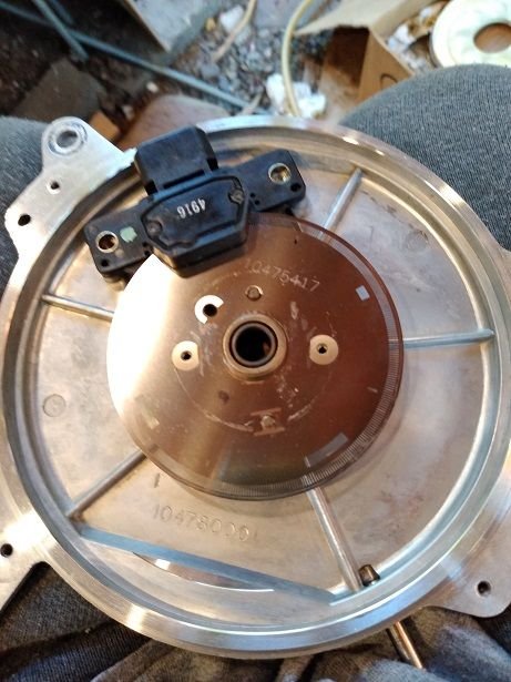

What am I supposed to see in the photo that proves the Opti was indexed correctly? I don’t even see the dowel pin. Is it the correct length?

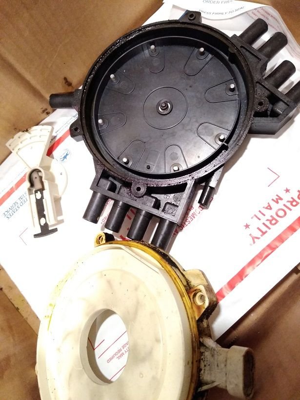

This opti is a NEW GM i had installed about 20K ago when the water pump started leaking. So i took it apart the cap & rotor didn't look too bad (see pic) and put aip cap & rotor
The pic was showing that i took the opti off to see if the pin was index in the right slot.

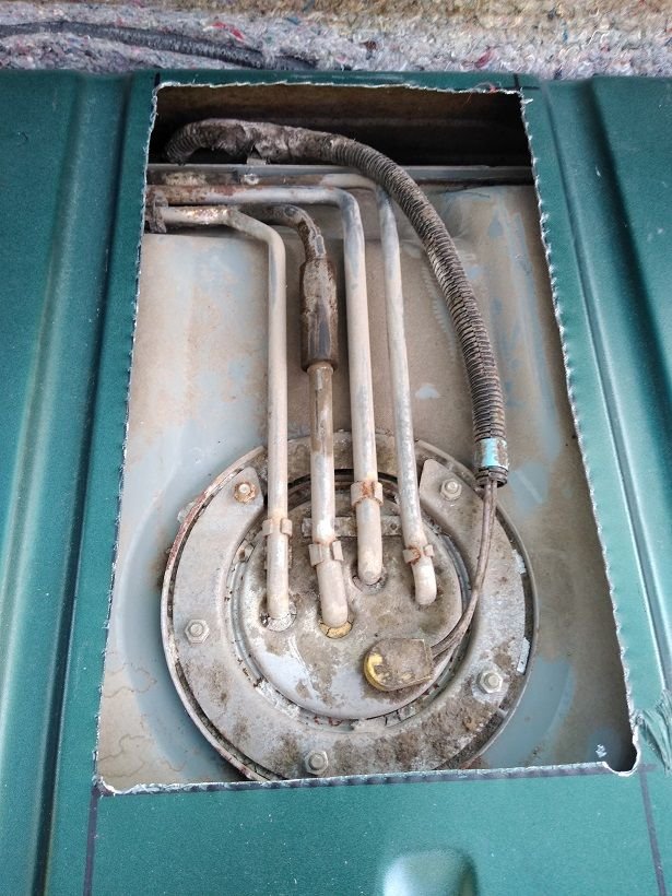

it looks like the fuel pump bit the dust!

I got the fuel pump in using the cutting hole to get to it, and it running.
Can you check this scan file and see if anything jumps out at you?
