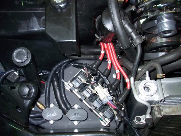

I just put the LTCC in my new build. I bought an MSD opti rebuild kit before I bought the LTCC, not knowing I was going to go that direction. I am having a timing problem that I thought was a tuning glitch. I'm going to try to pull out the opti this weekend and see if it is screwing up. I've verified everything else is good, so it's either a bad opti, or the set screw on the cap got loose (which I now am hearing is a common problem). In hind-sight, I wish I went with a GM replacement opti. I know the cost is more, but the amount of time/effort required to pull one would offset the cost (to me).
On another note, Bob Bailey suggested the Magnacore spark plug wires, so i went with them. I had used the Taylor's for years and loved them, but he said he had seen problems with them on some cars. I was so impressed with the Magnacores that I immediately ordered a set for my Silverado, and my wife's Vette. They have a great write-up on there web site explaining their difference from other plug wires that make s a lot of sense!
Good luck!
Ben
I still haven't fabricated the coil cover, but here it is as it sits:
