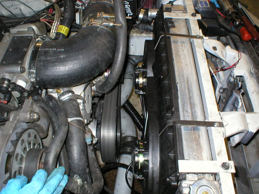

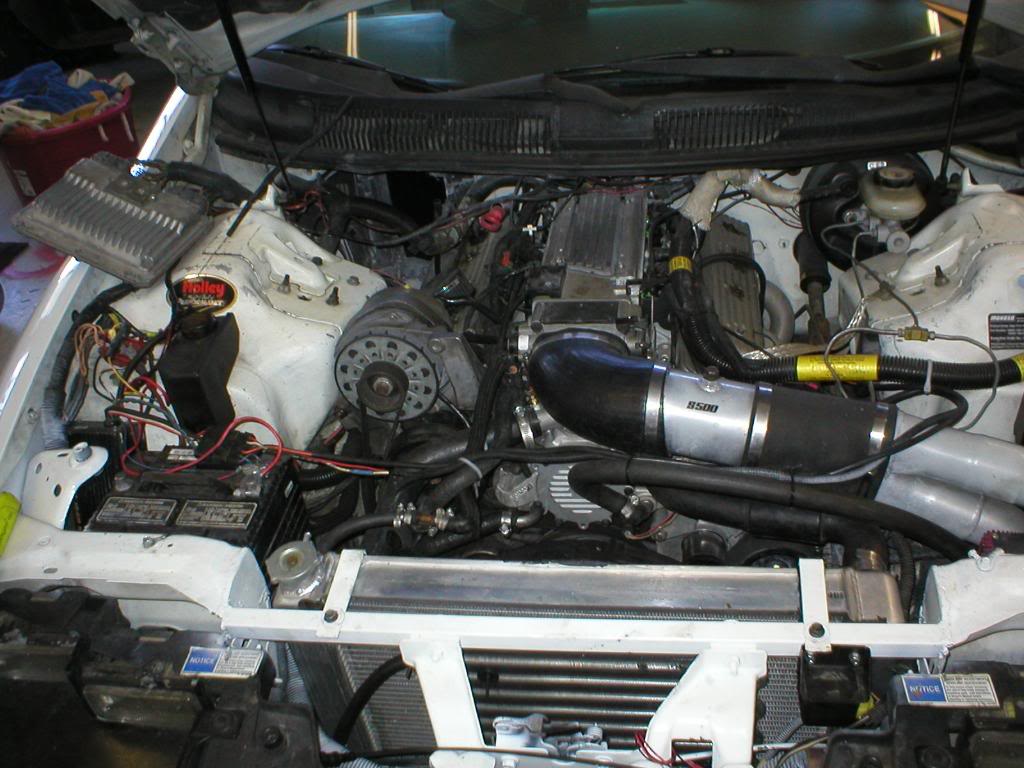

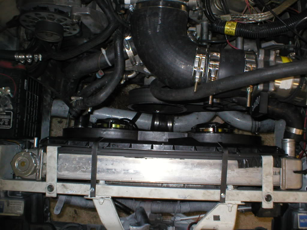

I used all stock hoses, for fans I had real problem, I had the oil cooler put on for some reason... I used Summit dual 11s puller fans work to perfection... Singke would not cool the car in 90+ heat....
Last is old setup

It all depends, the flex 220 dual pullers would not fit, the trans cooler, oil cooler, steam vent, and both rad hoses would not allow for a snug tight fit, I did'nt opt to cut 4 holes in a set of 250 dollar fans........ Pusher option would not keep the car cool in 90+ temps outside (same fans)... Single mono flex puller also would not keep it cool.... If you have a man trans the flex 220 should work, but still requires modifications!!!!!!!!!!!!!!!

Off the top of my head the space you have to work with is 16.5 by 10 inches, the fin area... I wouls suggest you buy the fans at NAPA so you can return easy, and they do sell flex products.
This guy did it with flex 220, but as you can see it does not fit correct, and that will result in a huge loss in cooling.. The turbo setup looks perfect though...

MY BAD These fans http://www.summitracing.com/parts/SUM-G4850/... It was a long time ago, and the car is not here (storage)
12.000 in.
Height (in) 15.000 in.
Width (in) 26.000 in.
Thickness (in) 3.240 in.
Number of Blades 10 blades
I had to do some very minor mods to fit!

Originally Posted by chevyrules85
hmmm i see. looks likess those are about 4" wider than the finned area i have to work with. how did you make that work? thanks!
Top pic, it fits the tank welds to perfection
