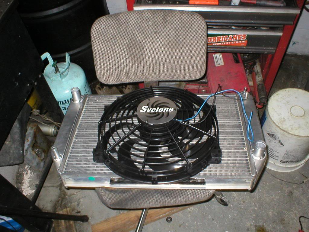

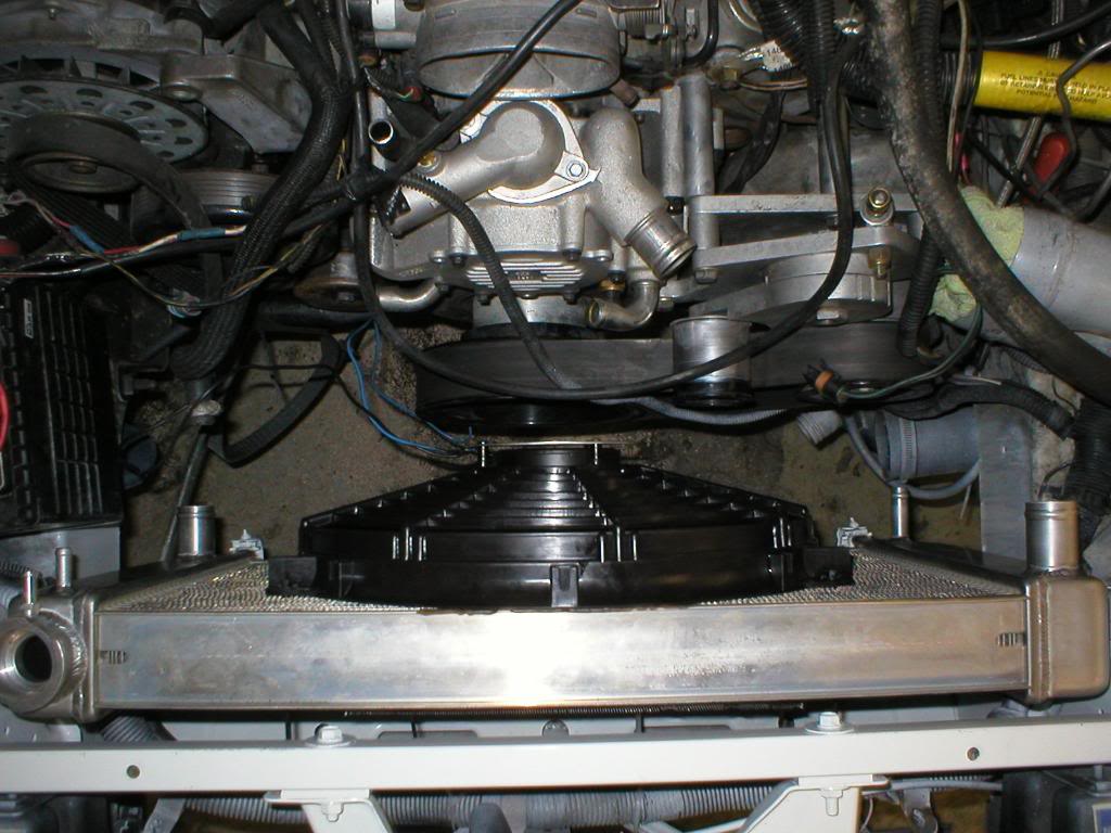

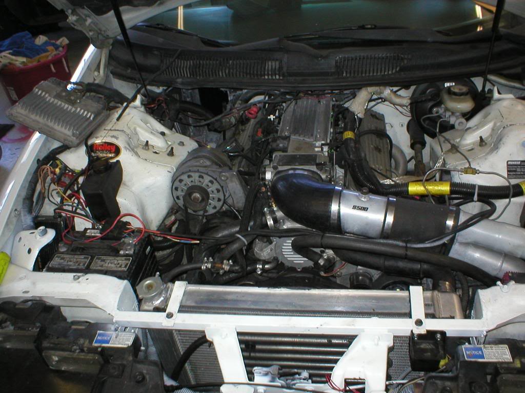

WILL NOT WORK!!! Only way these work on the Griffin Rad is to cut hole in the fan shroud at the top left, and also only to have only upper and lower hose for rad not oil cooler + Auto trans lines and steam line......I had posted about these problem not to long ago... I went with single syclone... Works great... If I had to do over I would have ordered wider than 27 inch rad to 29 then it would work with all stock lines and locations...

EDIT I see your NOT going vertical.... They should work no problem...

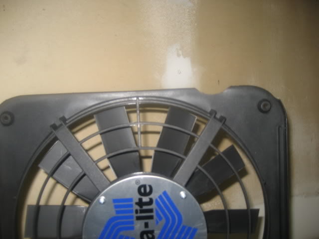

Sorry to Hijack my thread back, but I thought I would give a lil step-by-step procedure for modifying the Flex a lite 220 fans for use with a stock radiator.
Here is the problem that I didnt like. Fits like ****.
Doesn't clear rad hose.
Step 1, remove weatherstripping.
Step 2, mark the plastic shroud where it touches the radiator.
Step 3, Remove fans, cut area from inside out from mark to mark.
Step 4, clean cut area up, reinstall fans.
Step 5, mark and cut area around rad hose.
Step 6, cut weatherstripping to length for top and bottom.
Fits like a champ

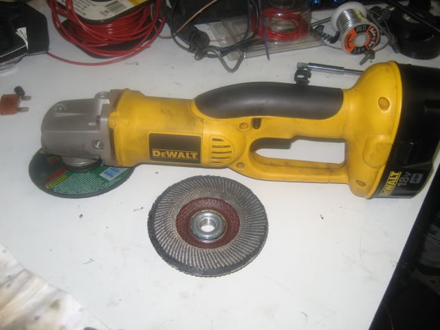

This took me about an hour with my tool of choice and SAFETY GLASSES!!!!!
