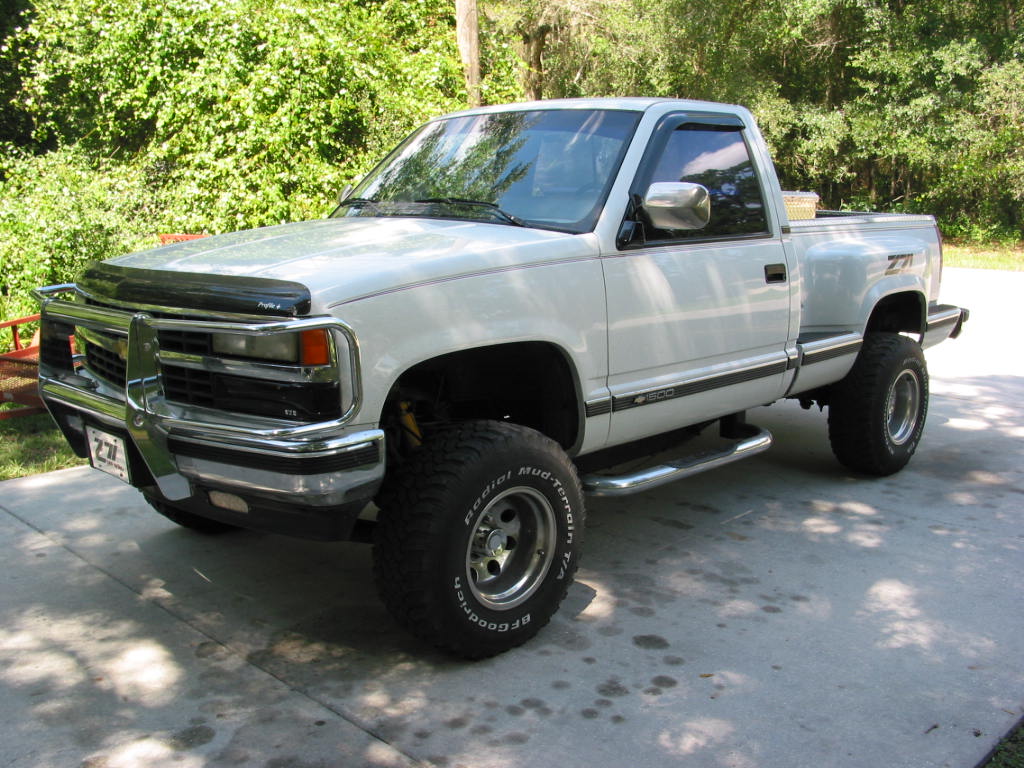

Oh, and GREGG 97Z, I don't currently have the Trans Am anymore Me and a buddy traded vehicles. I got me a red neck 4x4 chevy truck and he got my Trans Am. However, I did end up with another 96SS but I don't have the engine in it right now so it is kinda like only 1/2 a car I guess. LOL!

Brent, That's a nice looking truck! I didn't see a shotgun rack in the back window so I wouldn't call it redneck.
So 2 1/2 F-bodies and a pickup now, not bad!
