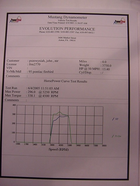

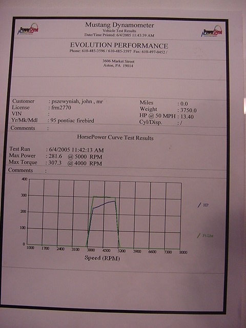

Originally Posted by BUBBA
Actually, I believe the Mustangs read around 10-12% lower. Could be wrong about that.
Bubba,
here is mine on a mustang dyno with the full stock exhaust mods in my sig...
here is one with the cutout open...
We were not sure where to set the end of the run on the dyno computer so the full exhaust run was set to kill the run at 140 MPH, and then after seeing the results it bumped up to shut down at 145 MPH, and since I have 2.73 gears I should have told them to shut it down at 160, but I didn't know that at the time... I was just under 300 and I didn't even get a full run, this is why I thought Mustang's read higher...

a mustang dyno would read lower it has eddy current or to explain force against the wheels to sim the earth where as a dynojet is just free wheeling
