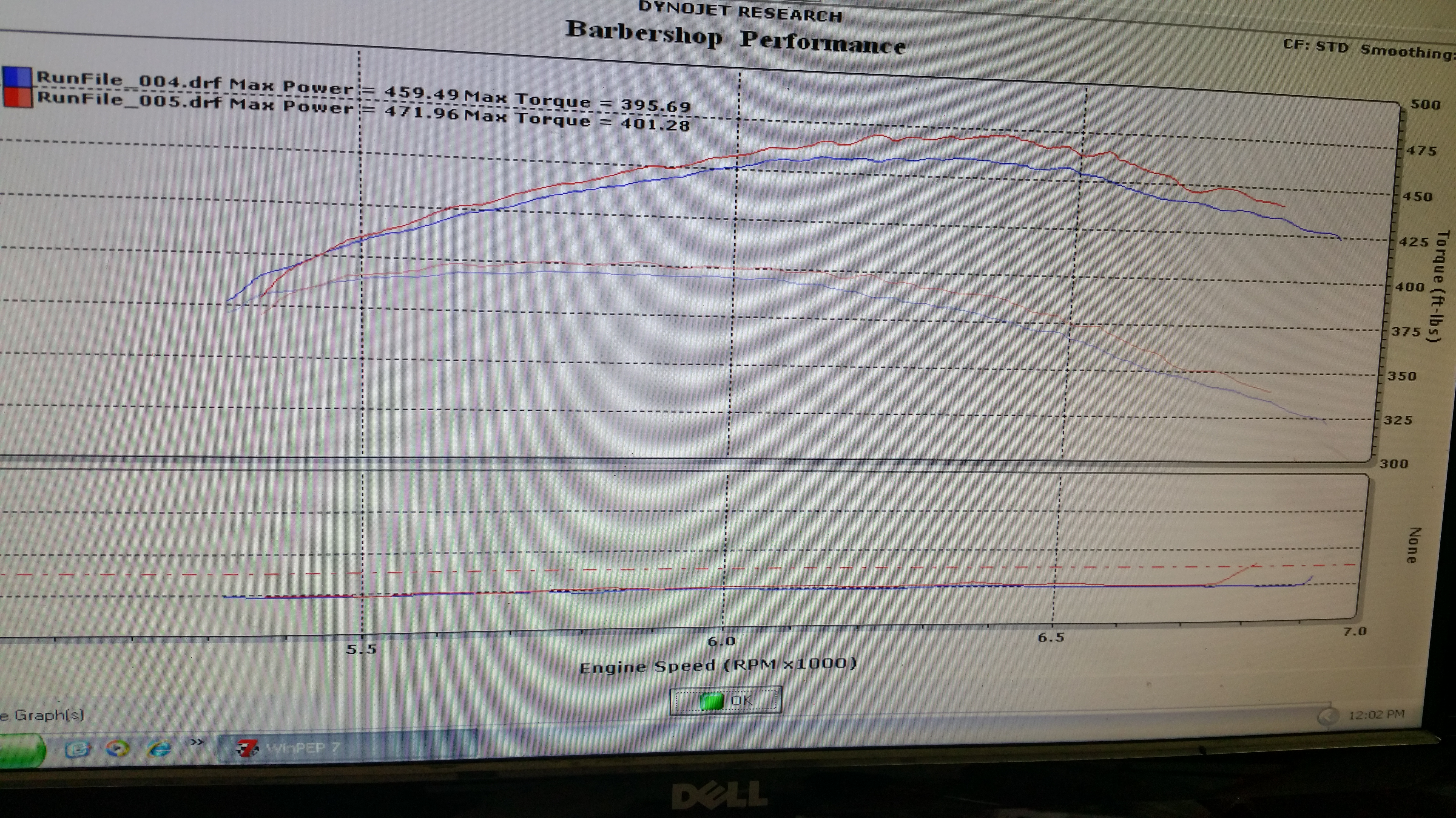

Just got the dyno chart for the 2 runs.

Impressive numbers, and great track times/MPH.
Are those dyno and chassis numbers basically for the same configuration and correction conditions? If so, the drivetrain losses look high (26.4%), but auto transmissions are not my strong point. Part of that could be attributable to the large tires, and I guess the 9-inch.
I know nothing about auto trans setups, even though I run a TH400. When the engine was originally built, it had a T56 behind it, and the losses were 12.1% (670/762 on spray), through a 12-bolt. When I got tired of screwing up shifts and abusing the rear with 5,000 RPM clutch dumps, I had the TH400 installed, and it cost an additional 75 HP loss (595/762), for 21.9% loss. Both the chassis pulls were on street tires, so they were comparable.
The shop told me that was a surprisingly low loss for the TH400 with a non-locking converter, and indicated the converter was apparently "very tight". It's an ATI converter, but I don't know the diameter. I guess they were expecting something more like 25%.
Unfortunately the engine has more dyno time than track time, basically collecting dust in the garage for the past 10 years, due to a job that runs 11 hours/day and another 1/2 day on Saturday. Sounds like you put yours to a much better use.
Good luck with the future upgrade.

If I leaned mine out from the 12.0 AFR on the chassis dyno so it was the same 12.9 as it was on the engine dyno, it should pick up some RWHP which would reduce the calculated losses.

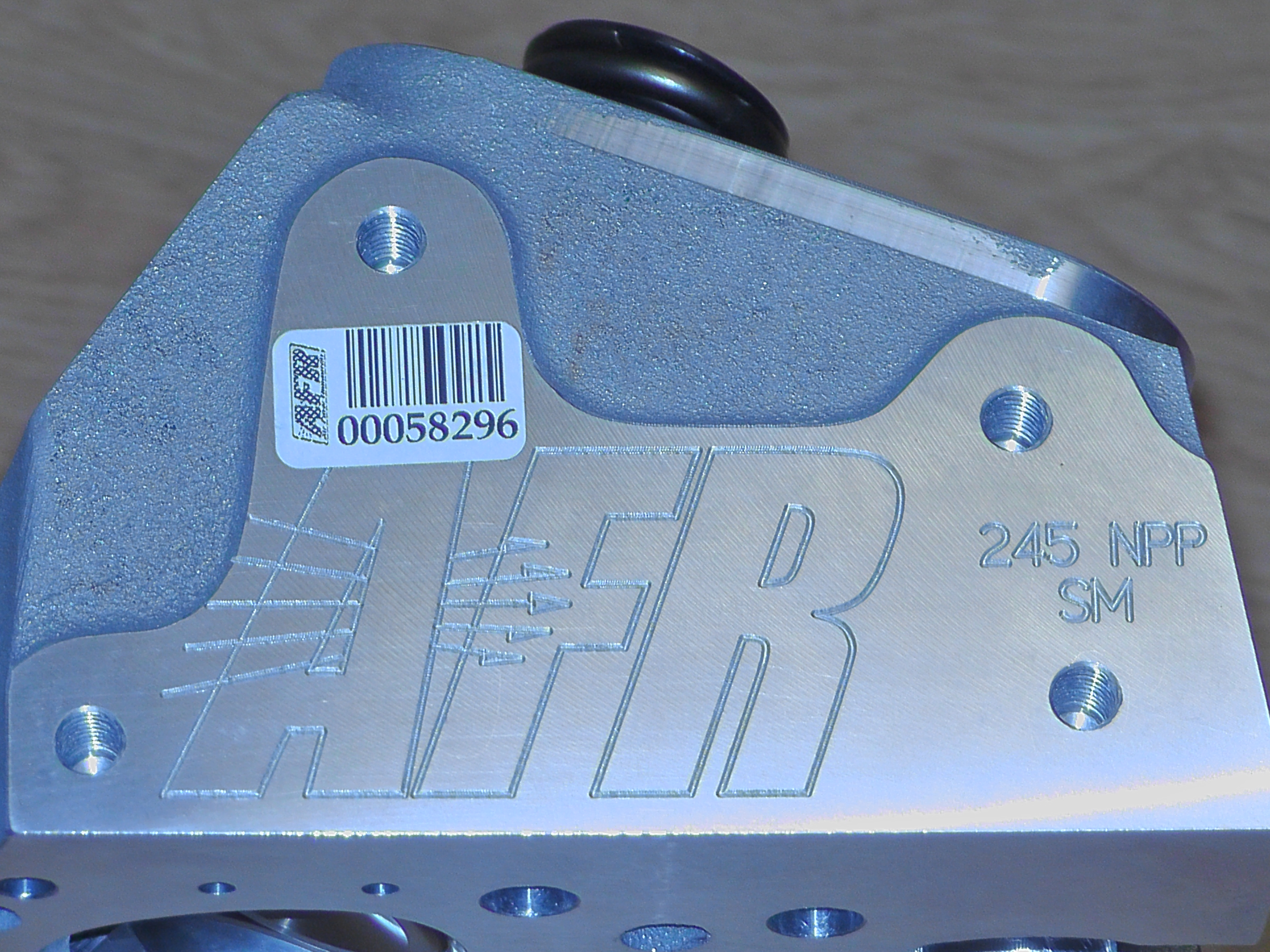

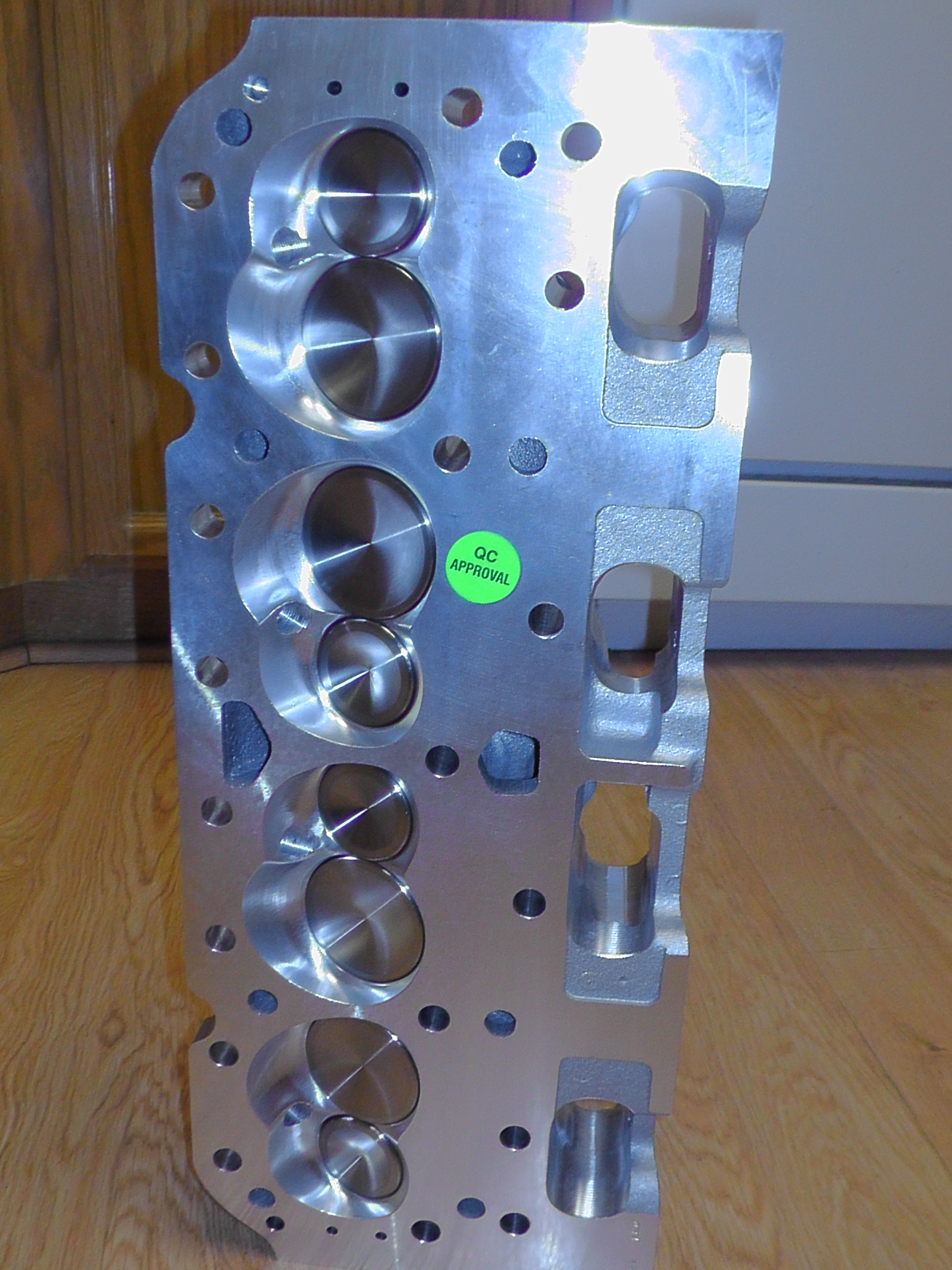

New heads arrived today. Still waiting on the T&D shaft rockers.
