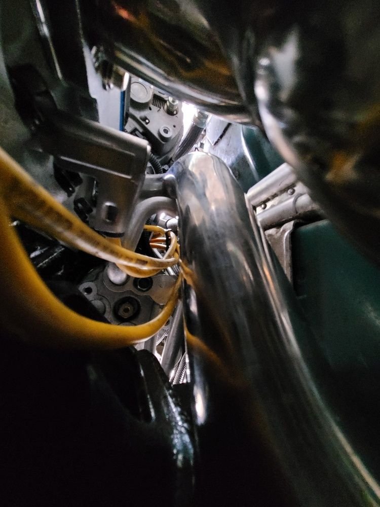

here's a couple of pics. wish i'd dealt with this while i had the entire engine and K-member out of the car, but 20-20 hindsight etc. etc. -- i think i am going to try and do some gentle bending of the a/c line to try and
create at least .25-.50" clearance and wrap that section with some insulation.
from underneath through the motor mount opening
different vantage point

What brand headers are they? I hate to say it, but looks like poor header design. I've got Kooks on my '96 Z28. Just checked the clearance on them and there is at least 3/4" between the #2 primary and the AC line on the back of the compressor.

i bought the stainless steel ebay kooks knock-offs. i'm actually really happy with them other than this minor issue. i went ahead and removed the ac manifold from the compressor and was able to bend it enough to create a 1/2" gap, and i also insulated it.
