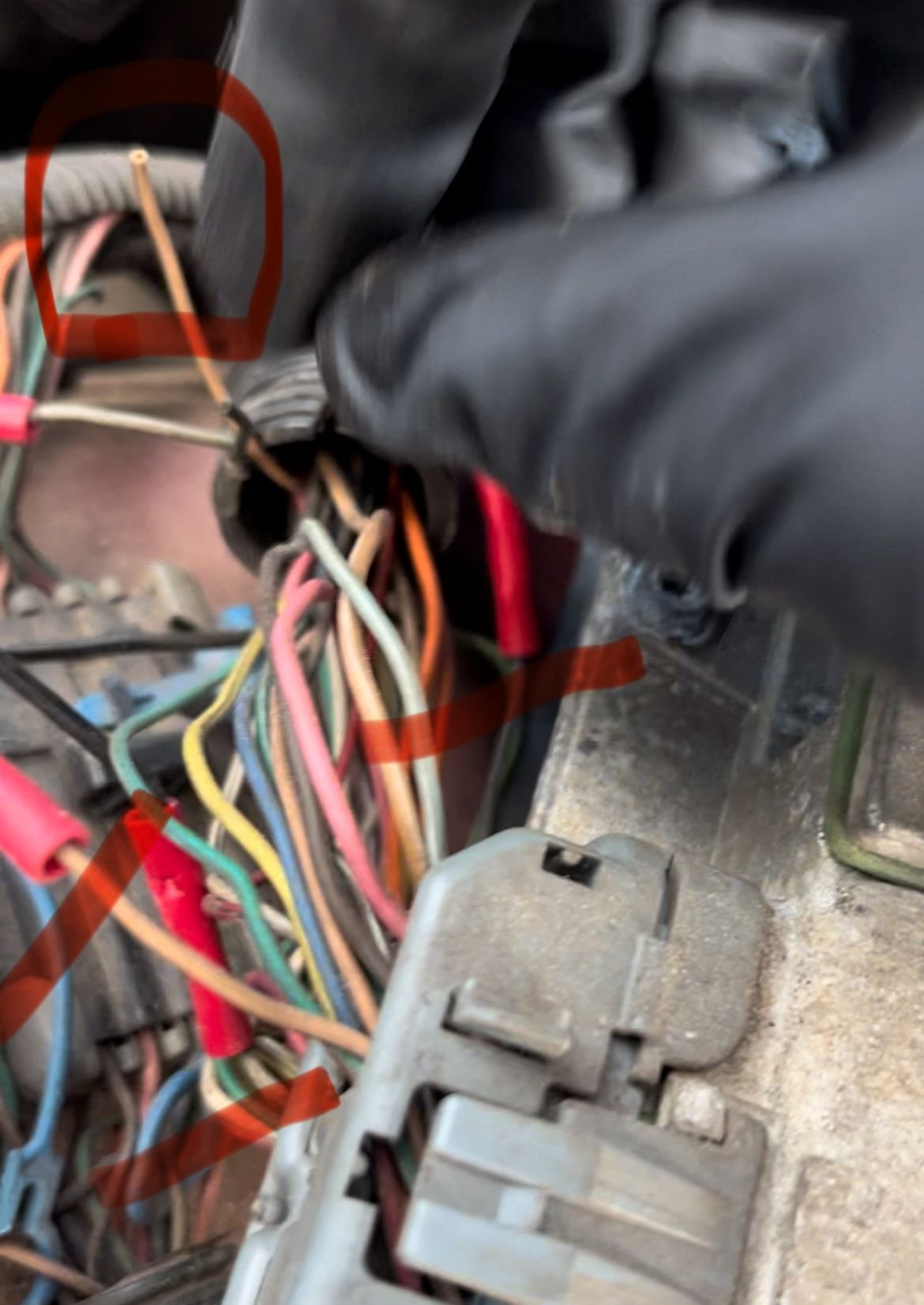

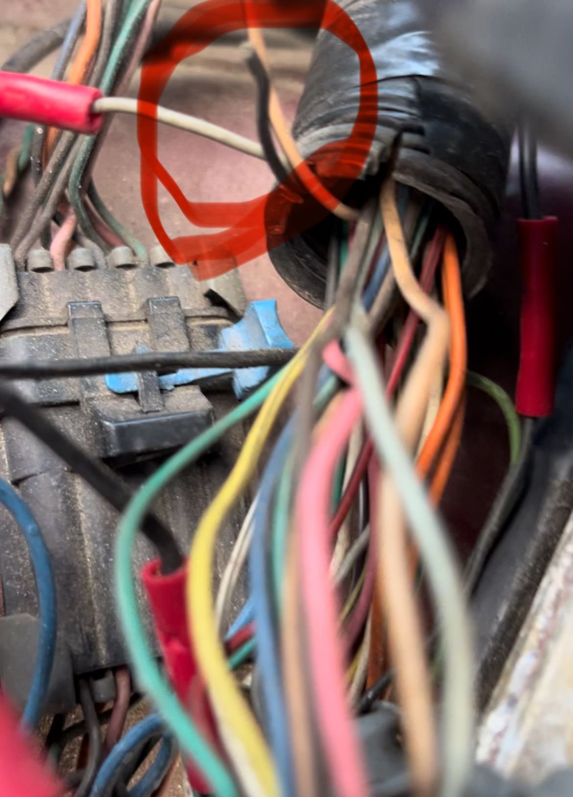

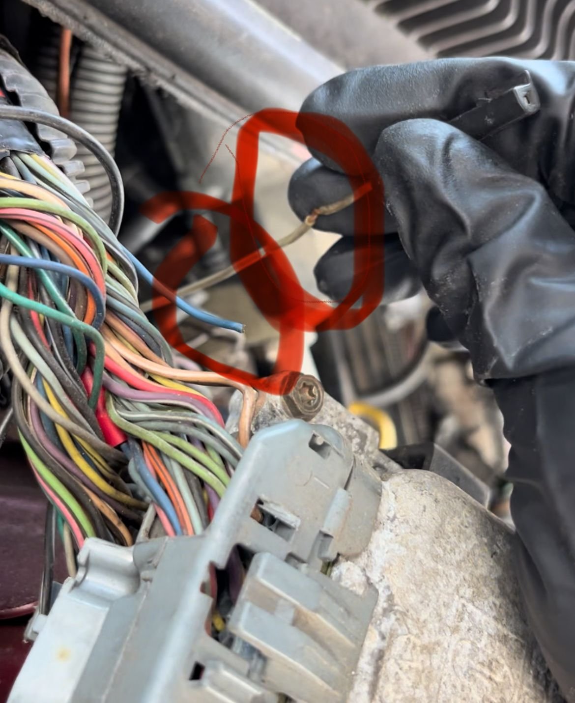

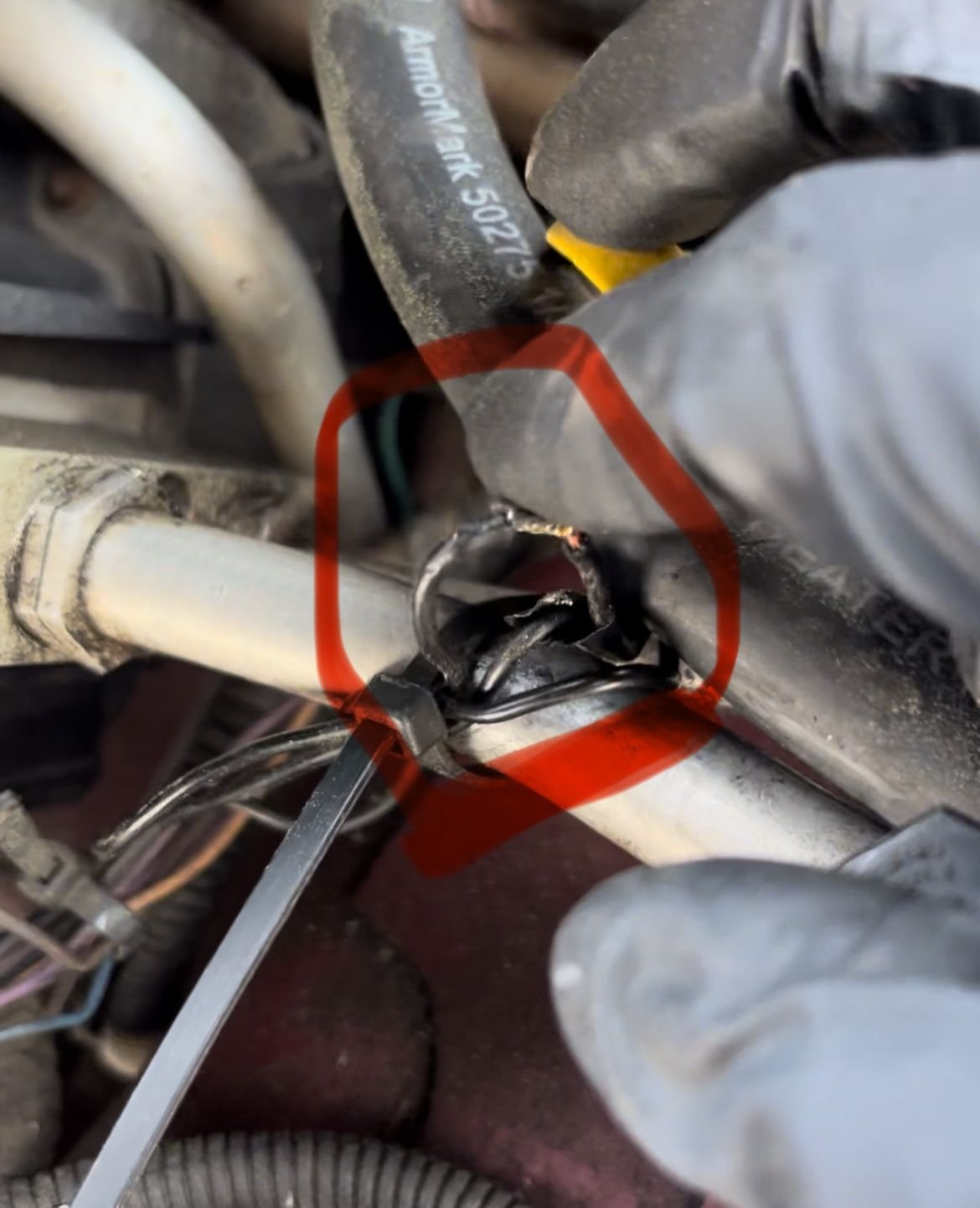

95 Z28 LT1 will start and die continuously for 20 times then idle and then once shut off will do the same thing. It has a new fuel pump, fuel filter, fuel pressure regulator, idle air control valve, opti spark harness plug, ignition control module and ignition coil. I’m lost at this point, fuel pump was bad when I got vehicle hints why it was replaced. But I can’t seem to find out why it won’t just idle. Please help, I just tested the injectors and they are all reading a resistance of 10.2-10.5 ohms. After Closer Inspection my wires are cut in multiple spots, exposed wires etc. Could this be my issue?

The single gray wire near the PCM, with the black connector is the fuel pump prime connector. Normally not connected to anything. Only used to test the fuel pump operation. Make sure it isn't shorting to ground by taping it up.
http://shbox.com/1/fuel_pump_prime.jpg
The rest of the wires are virtually impossible to identify without knowing the exact location. And even then there can be multiple wires of the same color in large bundles. The nylon tie that appears to be holding a bunch of wires to an A/C line is not stock, so impossible to identify the wires.
