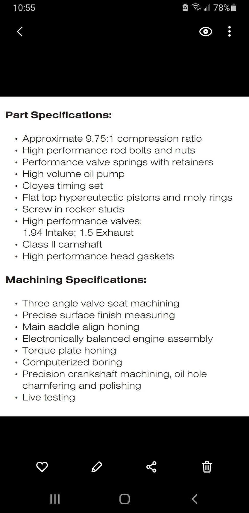

What are the cam specs? I'm assuming that 340 HP is at the rear wheels??

]​​nothing has been deleted and has all its emission still on amd was tuned in Arkansas but do not remember the name unless I find paperwork and im in IL now...only recently started doing this.fuel pressure holds at 40 when key in and off.38 when running and goes up quickly when u hit the gas and back down.Amd sorry not sure if my old laptop battery will stay up long enough to take a drive but I can try i guess,tx for youre time and patience as im not much of a comput geek. On the street it runs very good.no hesitation or missing and idles smoothly.

You don't need a “dyno” tune with the mods you listed, basically a small cam and a valve job. A good mail order tuner can do it. You send him the PCM with a detailed list of your mods - the tuner will have a form to fill out - he tunes it, mails it back. Just takes a few days. I can give you a contact.

Are you sure your old injectors were the stock ones? Or could someone have changed them? What size injectors are in the tune?

Sorry I've been pretty sick last cpl weeks and finally gtn back to normal.inj were 28lbs on ny paper work as we're my replacements.So yes if you have a mail order tuner in mind I'd appreciate the info.I did pull the iac and cleaned it and put it back helped some but no fix so I have a new spare in my box I'll go ahead and switch it out a d chk again.i did find 1 wire that had a burnt spot so I replaced that one and again helped but didn't cure.Ill keep chking youre list and re check all.y reading again om the sensors and voltages but at this point to me it's either a vacumn leak I can't find or even hear nor does the engine idle change when I spray around pieces for a leak so other then the iac im thinking it may have to be in the ecm.i took the connectors al off and cleaned those and put back on and no difference.Even though it still has an issue it still runs very well and gas mileage is st hoveri g around 18.5 to 19mpg but that's on interstate.I need to repaint rear bumper so that will be a good time to send the ecm off for a tune.Tx again for youre assistance!
