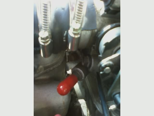

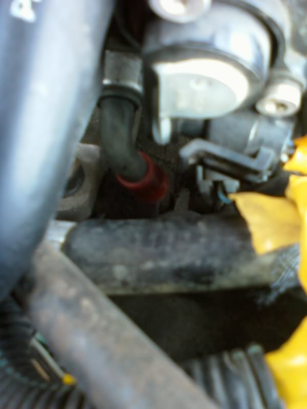

ok i feel stupid for asking this but... i cant find those two coolant lines everyone is talking about i found a former thred about this same thing
https://www.camaroz28.com/forums/sho....php?p=5471751
but i still cant find those two lines i found this....
are those two red niples the lines everyone is talking about? and if they are what do i do connect the two? if they aren't where are they haha

Yours has already been bypassed. It looks like your intake elbow is in bad shape. I would replace it. You should get a tune,it would be better the the chip you have.
