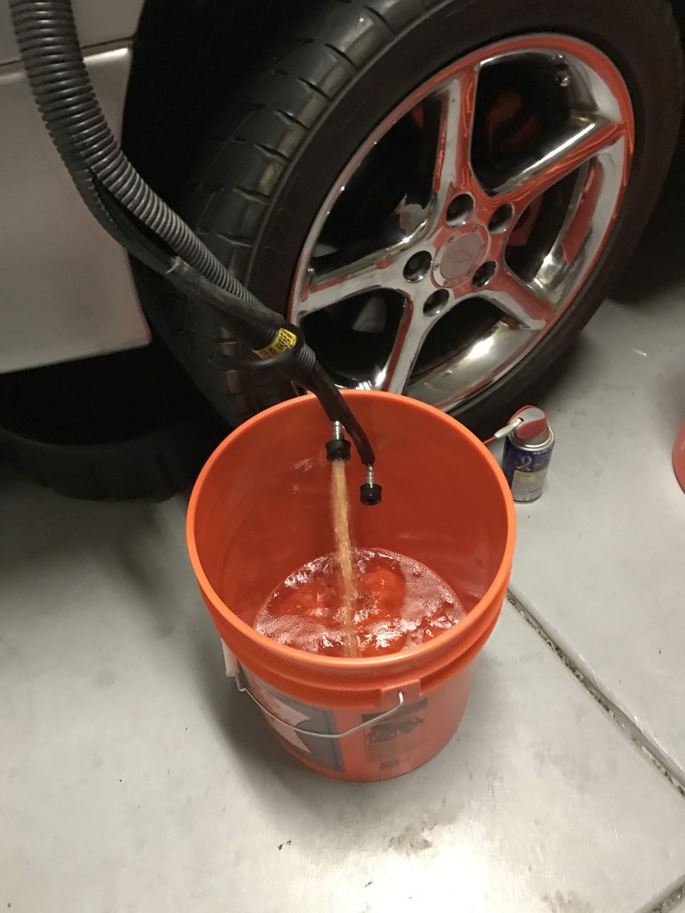

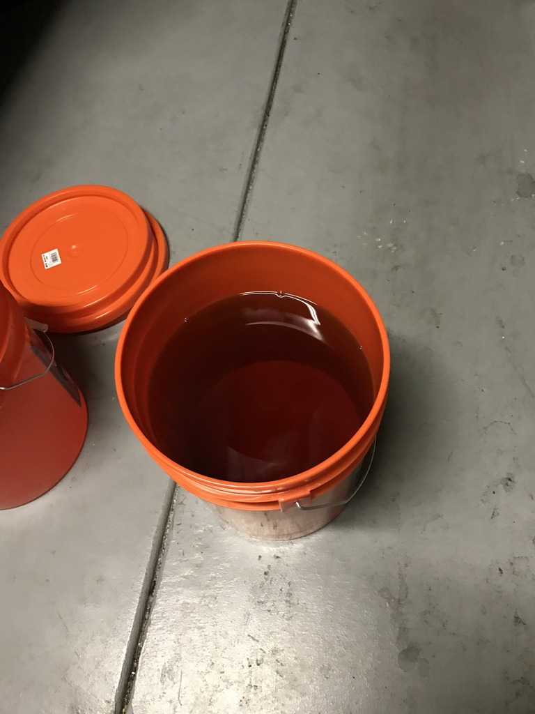

Emptying the tank with the fuel test port way way easier than I expected. I ended up using the feed line from the engine bay instead of the feed from the rear as it was easier for me to get to. I used an insulated paper clip (just happened to have one) with the tips stripped off. I then attached it to a wire and ran the wire back to the positive terminal. It only took about 4 minutes to clear about 9 gallons (Walbro 255 pump).

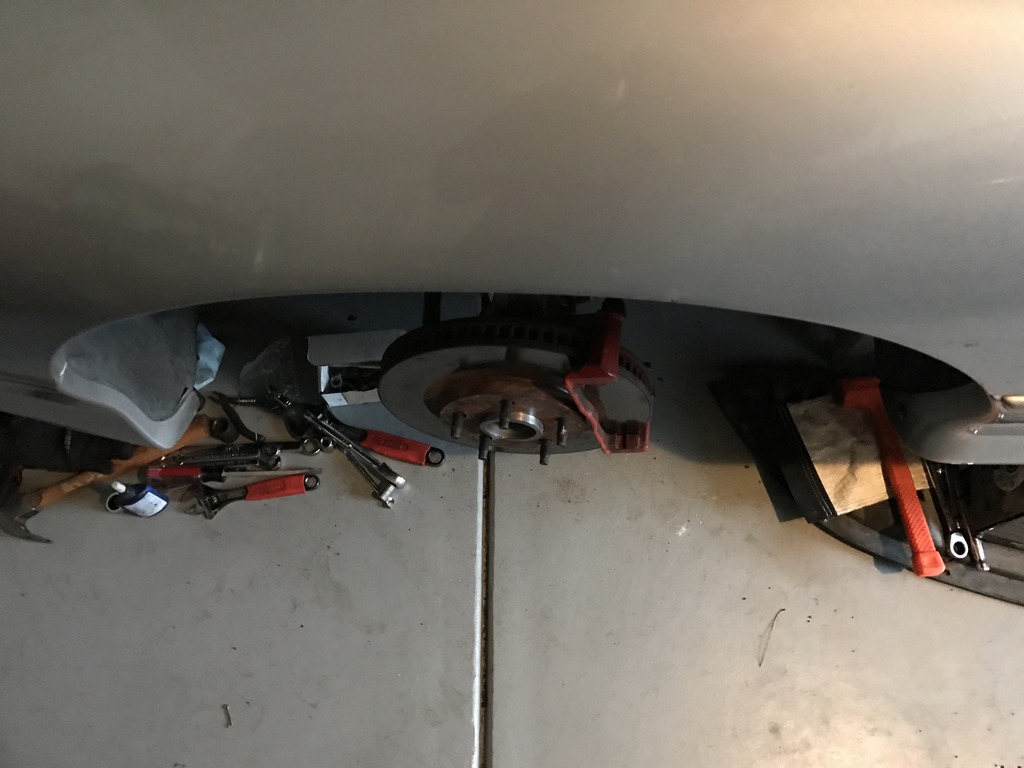

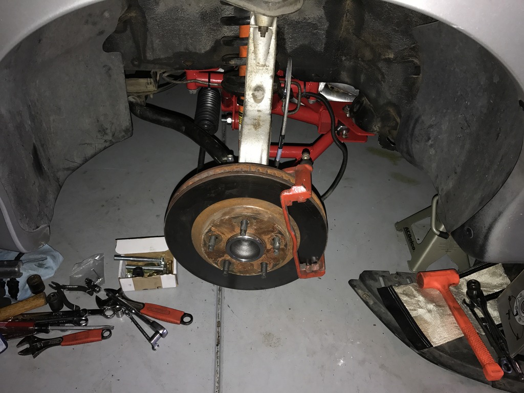

New lower a-arms are in (which of course had to be inspected by the puppy):
The alignment is better, but I think I will pull it off and shorten it just a bit. What a pain to adjust these!

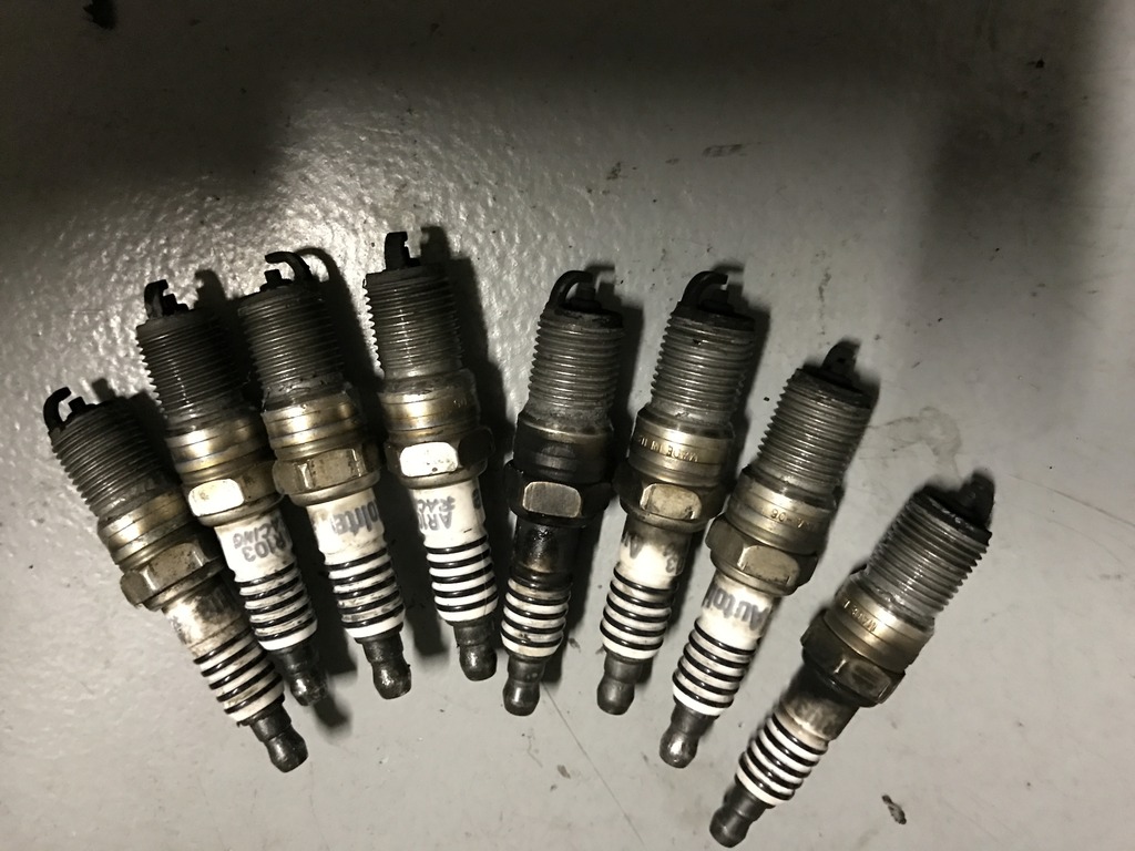

I pulled the plugs and found a bit of fouling (they smelled worse than they looked). I ended up replacing the AL's with NGK mainly because of availability.
I also found a surprise!
I have a new set of Taylor stainless braided wires on the way. I wouldn't think that 1 broken wire would prevent the car from firing, I would figure just a nasty misfire, but maybe it was causing more severe issues by grounding out the whole system?

the plugs do look a little "wet"...maybe due to cranking motor in attempt to start.
"maybe" the shorted plug wire FU the Opti. IDK if that could cause it to short out internally or just misfire only on that cyl.
You have chased several burnt wires...maybe there is another one yet to be discovered causing the no start issue
you may find it while doing something completely unrelated so good luck.
It appears fuel pressure is not a issue nor is the bad gas now that you have drained it

Finally back on this. Summers in Vegas make working in the garage a complete no go for me. I was able to get the front alignment back together with the new lower a-arms (pics soon) and am hoping to tackle the new plug wires this weekend to see if I can get this thing fired before I end up with 7 year old gas again. I REALLY want to drive this beast again.
Here is the lower a-arm re-positioned and tightened down:
Here is the front suspension back together. It is about 1/4" more forward than I'd like, I am hoping with an alignment they will be able to bring it back a hair:

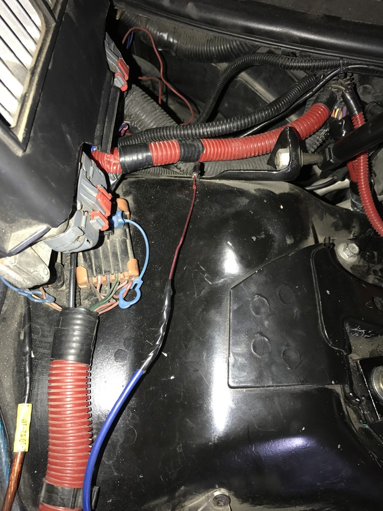

Re: 1997 Project

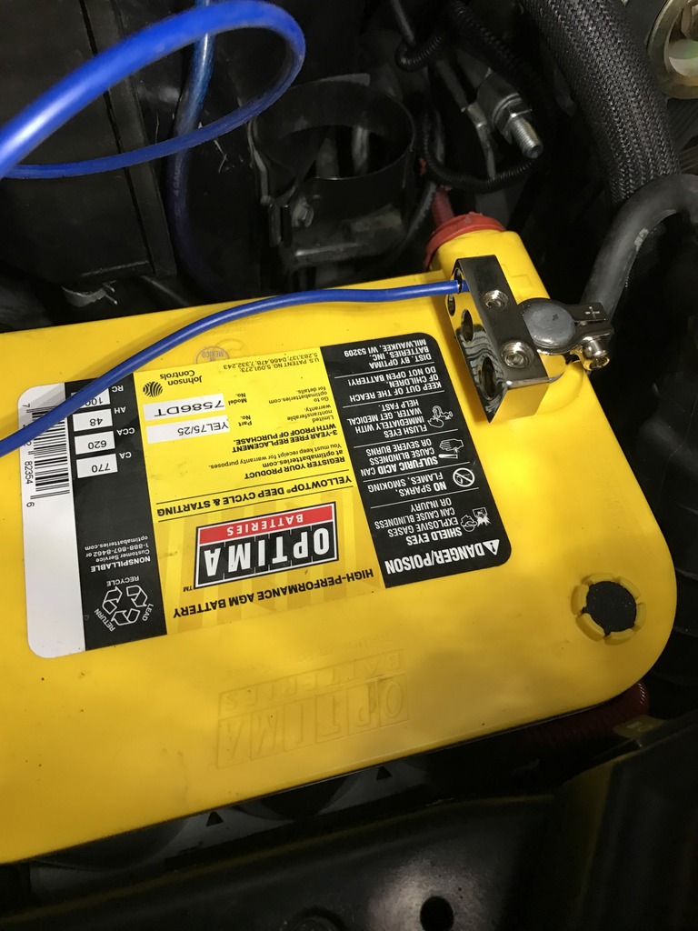

Got the wires under the hood buttoned up, I plan on switching to the Nitrous Outlet plate system as this isn't the prettiest.
