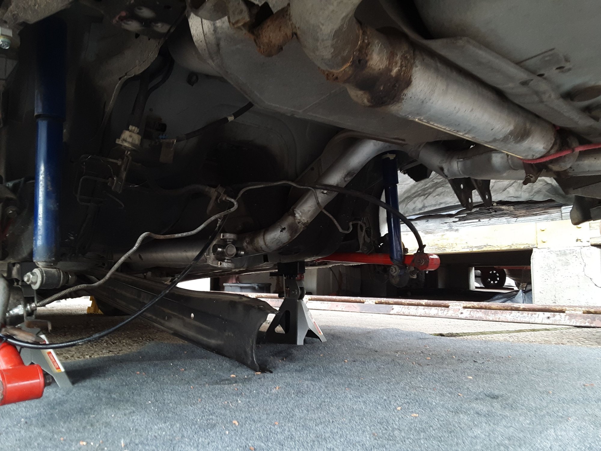

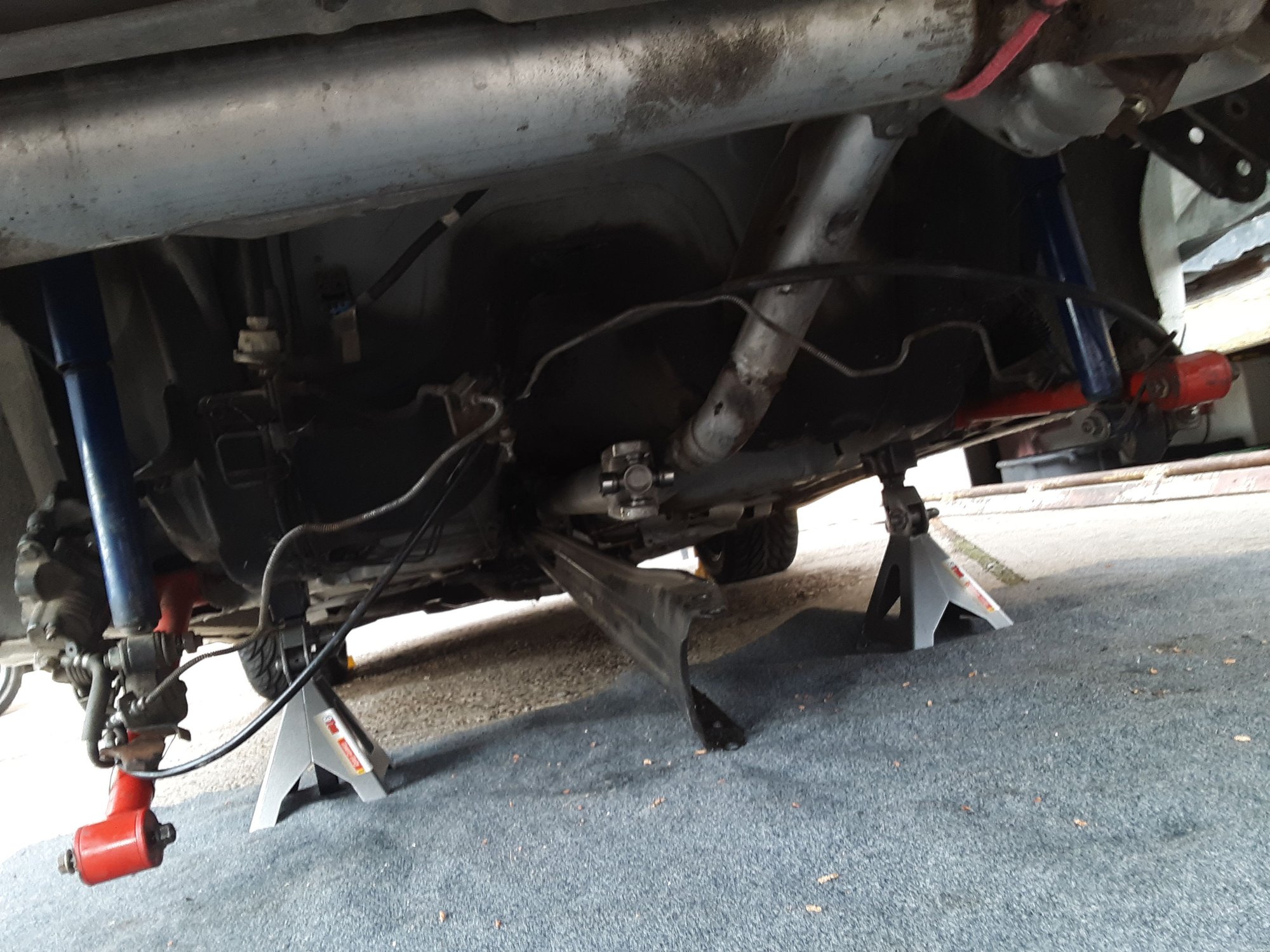

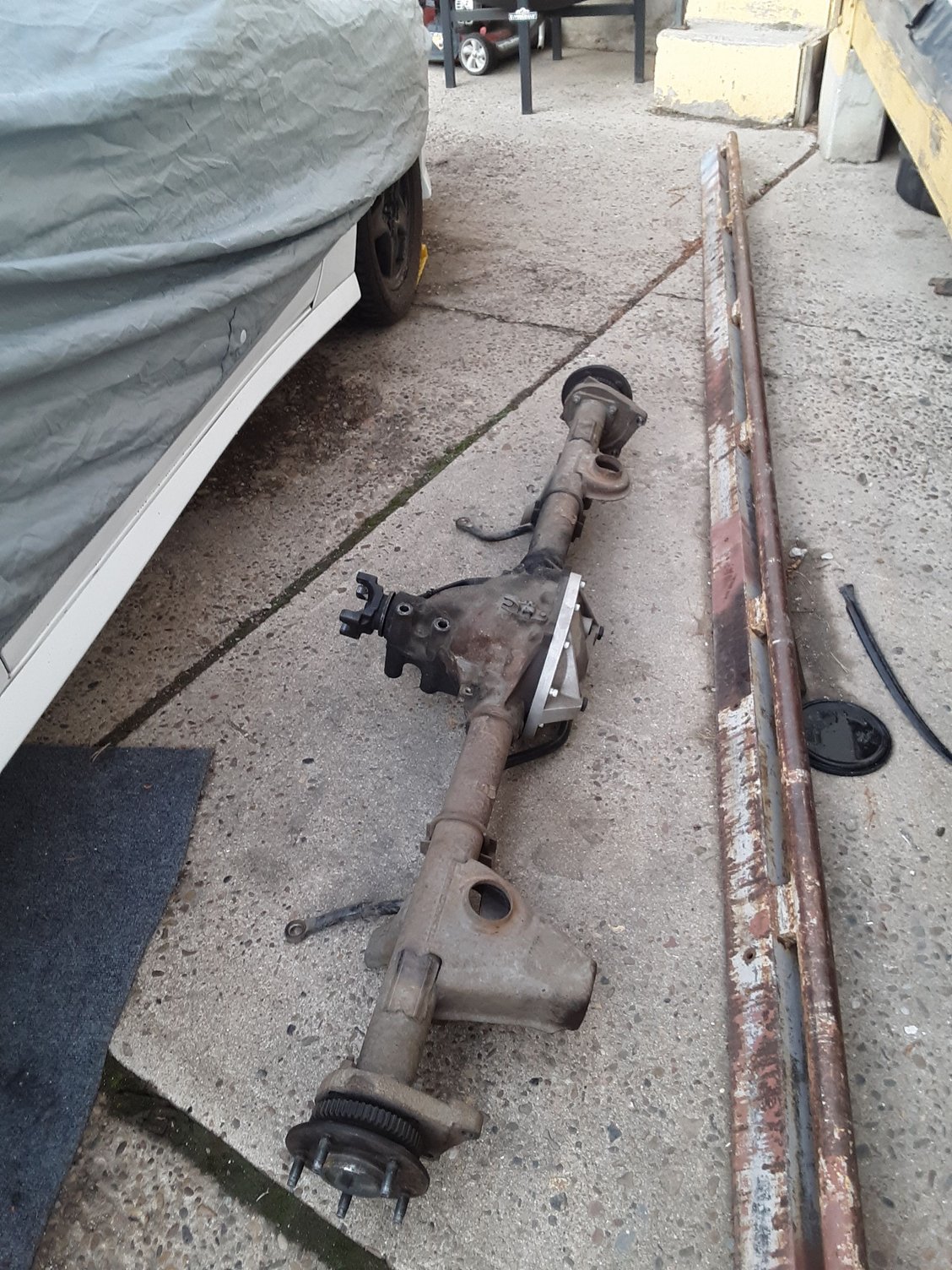

Have the rear end out of my car to get all the rust off of it and repaint it, am also doing the sway bar bushings, end links and rear brakes while I'm in the general area. Considering I've gone this far, should I replace the fuel pump? To my current knowledge the car has a stock fuel pump, which is a bit scary considering the mileage (145k) and mods the car has. My point being, how hard is it to remove the tank? I've got 3/4 of a tank unfortunately still in the car, I'd likely put in a Racetronix fuel pump (Walboro 255) and body ground kit from Hawksmotorsports. Any personal experience or guides to removing the tank and replacing pump would be greatly appreciated.
