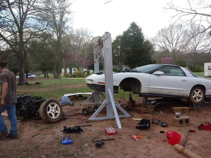

Ha she's running ! On starting fluid.. maybe just clogged injectors but ha I been trying to do this for so long I had to build a lift and everything did this entire swap by myself I figured thats considering im 25
