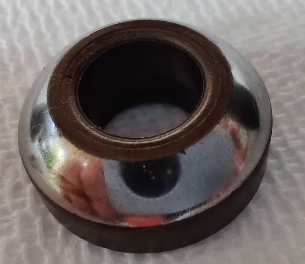

Thanks for the words of warning! I've managed to isolate the sound with the Drivers valve cover off.
The sound is coming from the #7 Intake rocker/area. Using the scope it definitely loudest coming exactly from the middle of the rocker, not the pushrod and not the the top of the spring.
Additional info/what i did next:
  • The car still has stamped rockers, no real issues with the other rockers that i noticed. Plenty of oil ...
  • With the valve closed i could turn the pushrod between my fingers with some effort, it definitely was not loose at all. (Not sure if this is good/bad/normal, i know loose would have been bad)
  • It sounds more like a metal squeeky sound, not a tapping sound
  • I backed the rocker nut while running and the sound went away as soon as the rod's started to begin tapping.
  • Tightening the nut a tad got rid of the tapping but brought back the problem sound (more squeeking).
  • I relaxed the nut a tad till the problem/squeek sound went away, the tapping just barely came back
  • I shut the engine off and with the rocker nut still loosened and the valve closed.
  • I was able to freely spin the pushrod, and there was some play now that the nut was loose.
  • I couldn't feel any spring /give in the lifter when pushing the pushrod down. How much force is needed? I'm wondering if a seized lifter is the root cause?
I think the next logical step is to take the rocker off next, but I'm not sure what to look for. I'll post a pic in a bit...

Thank you for the tip! Unfortunately the ball and rocker have already been separated when i inspected them So it may "go away" with the repositioning on the new rocker, but at least if it stays with the stud I know something else is up.
I did manage to check the pushrod on some tempered glass, it rolled no problem and the passage is clear. The car was running smooth aside from the noise. I noticed nothing until a "chirp/squeak" happened on startup one day, it came and went for a few seconds, then came back permanently after a short drive. Also the sound managed to stop when the lifter was loosened so this means it's likely not major bearing going (whew!) Given the above I'm optimistic this is really just the rocker arm! I would expect worse if a lifter collapsed.
FYI there is a very faint scour mark on the ball nut, I'm guessing it's probably bad.

@shoebox @Injuneer Thanks for the heads up regarding the Hub/Pulley not being keyed. "Turns" out mine was off by 180°. The good news is I managed to swap the bad Intake rocker with the good exhaust rocker on #7 with no issues (thanks @97 6SPEED Z for the tip). The bad news is the sound stayed with the #7 Intake right at the stud/rocker. I confirmed with the stethoscope, its 100% for sure loudest there. I'm crossing my fingers it's just a bad Stud, but it does seem like a really odd failure point to me
I found this video, which sounds too similar to mine (in person using the scope, oddly the chirp doesn't pickup as well on my mic). End result was a damaged lifter and trashed cam: https://www.camaroz28.com/forums/lt1...squeak-867779/
In my case, if it is a lifter I'm still wondering how sound would travel right to the #7 intake rocker stud, wouldn't the lifter have to transmit the sound through the pushrod to the rocker, making the pushrod end louder?
I'll post an update when I replace the stud - hoping for the best, preparing for the worst. If anyone knows the stud replacement process on these heads off the top of their head feel free to chime in..
