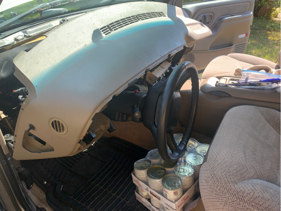

Thanks for the help on this, I appreciate it. I'm hoping this doesn't turn into the nightmare that working on the suburban was. Fun times those were:
The dog food holding up the steering column still makes me chuckle. Adapt and overcome?
