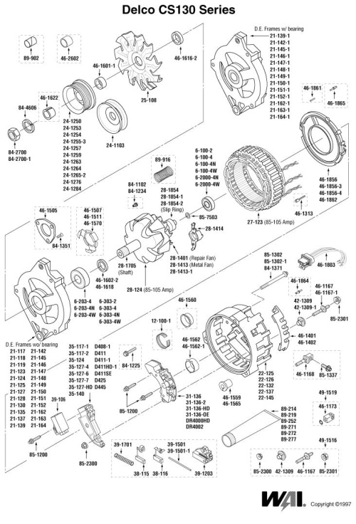

Threadlock would be ok there. And/or a lock washer. But the stud or alternator may be stripped or worn too badly to stay put. Can you tighten the stud to the recommended tightness (about 10 lb-ft)?
Another possibility is that the cable is too tight and pulls on the stud, turning it with vibration.
Now that I read again... "all thread with a nut". Does that mean there is no shoulder between the nut and the alternator? You may have the wrong stud there.

I misread, earlier. You need to open up the alternator and secure or replace the stud.
