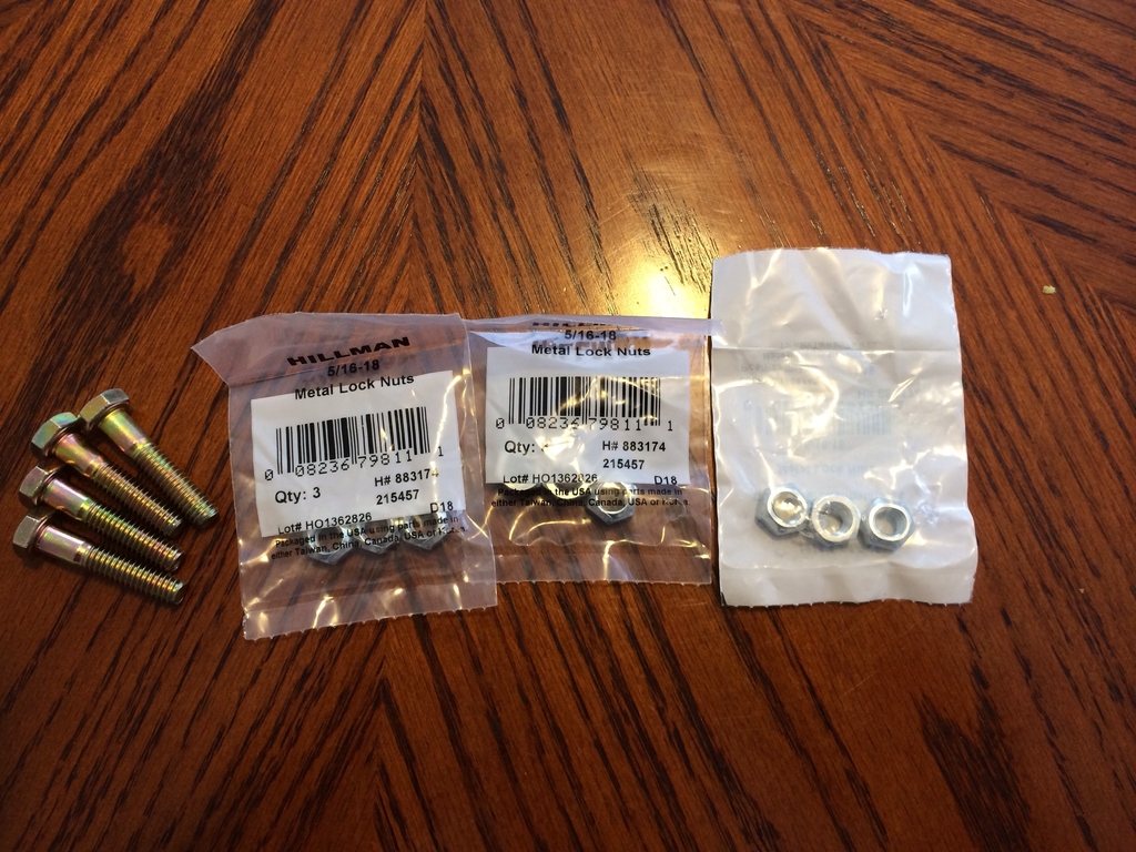

- (Four) 5/16-18 x 1 1/2" Bolts
- (Four) 5/16-18 Lock Nuts
- 1/2" Wrench
- 1/2" Socket with Ratchet
To fasten the Eliminator back into the steering shaft, you'll need some bolts and lock nuts. I used some 5/16-18 x 1 1/2" Bolts with some 5/16-18 Lock Nuts that I picked up from a hardware store.
A Vise can help here but it's not need. Place these bolts through the holes on your steering shaft with the eliminator in place. Make sure you put it back together the way it was.
