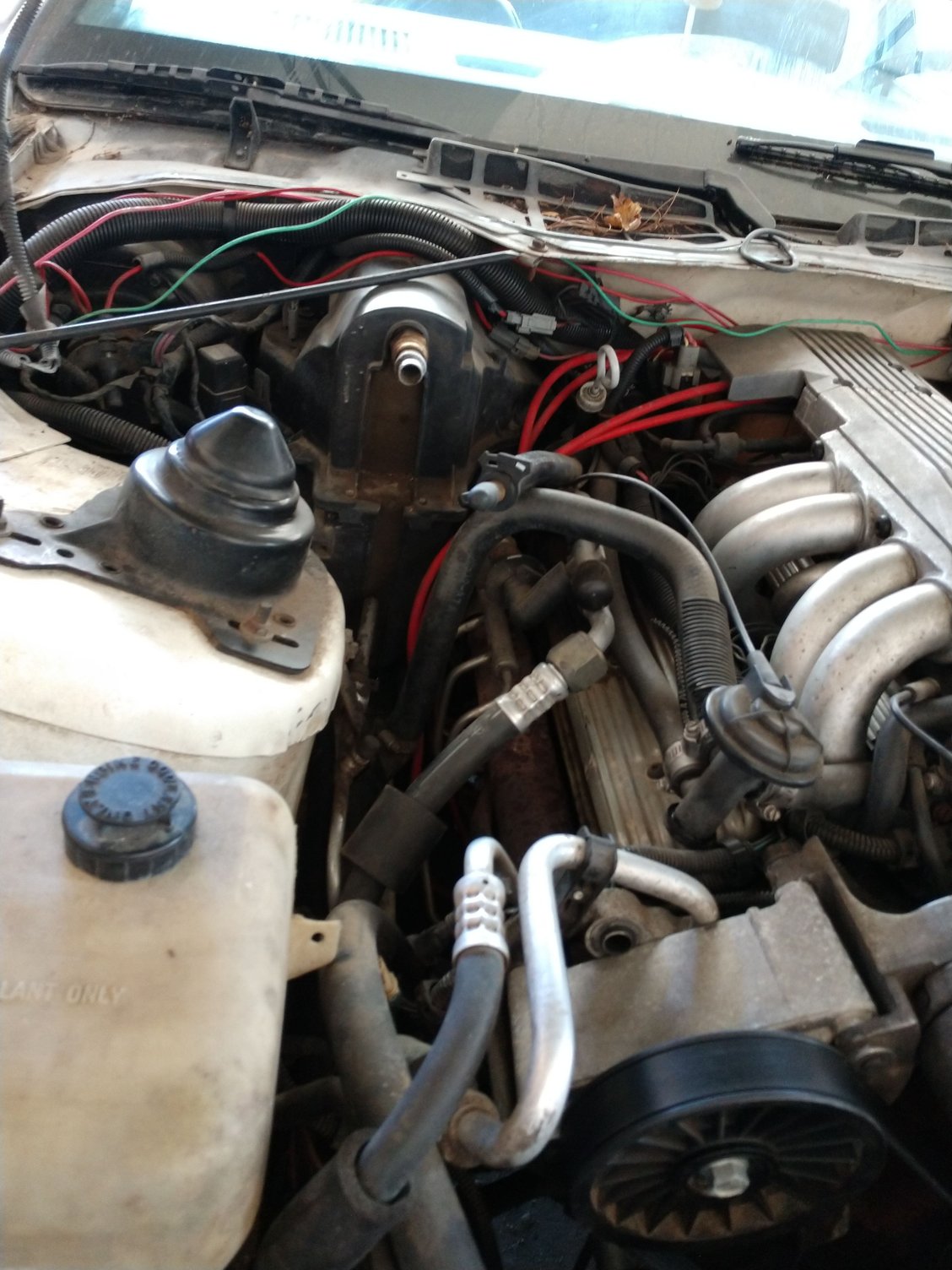

I have an 1988 Iroc Camaro with the 5.7 350 V8 in it. If my research is correct this camaro came from the factory with the duel cooling fan set up. The main fan is supposed to be controlled by the ECM and come on at 230 degrees while the secondary fan is controlled by the A/C and comes on at 238 degrees. One of the previous owners took it upon themselves to redo the radiator fans in an interesting way. This camaro no longer has the A/C and has a delete pulley in it's place now. As for the fans, I can't tell if they are original of after market fans but they are wired directly to the battery and have wires running to the dash board on two separate switches with no relays in the system so the switches get to hot to touch after about a minute. I believe i have found the original wires for the fans all cut off and wire nutted together. Is there a good AC kit out there to add the AC back in as well as a harnessing kit to fix and/replace the harness for the dual fans?
I have attached pictures of what I believe is the old fan harnessing and where the AC should be. Any help or advice is appreciated.

Sorry to tell you but thats a bad hack job without original parts, the fan shroud on the IROC covers the fan blades those are 2 of the same blades, the fan shroud also covers the back of the rad and pulls air from the front air dam under the car to cool off the rad, by looking at it it seems like those are fans from a z28 5.0
Do you know where I can get the right parts to try and bring it back to original?
