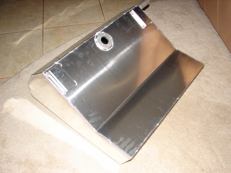

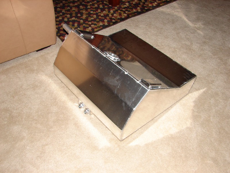

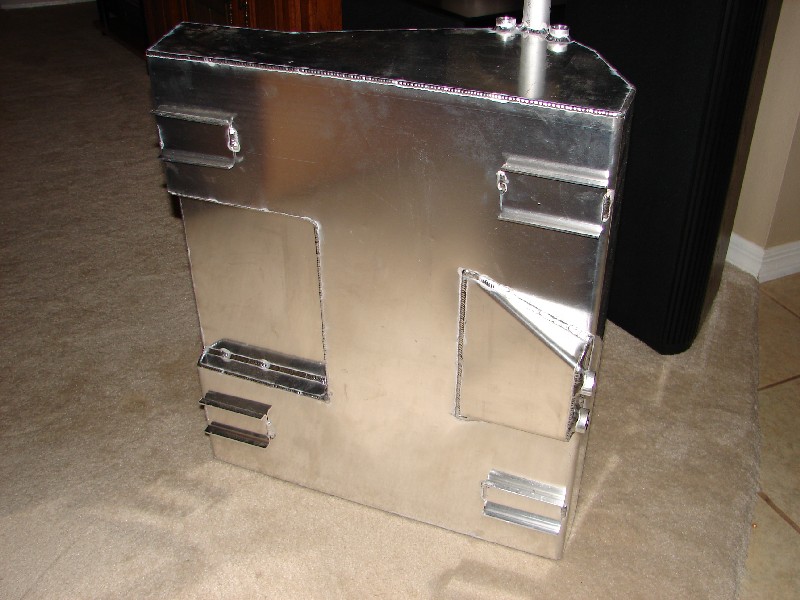

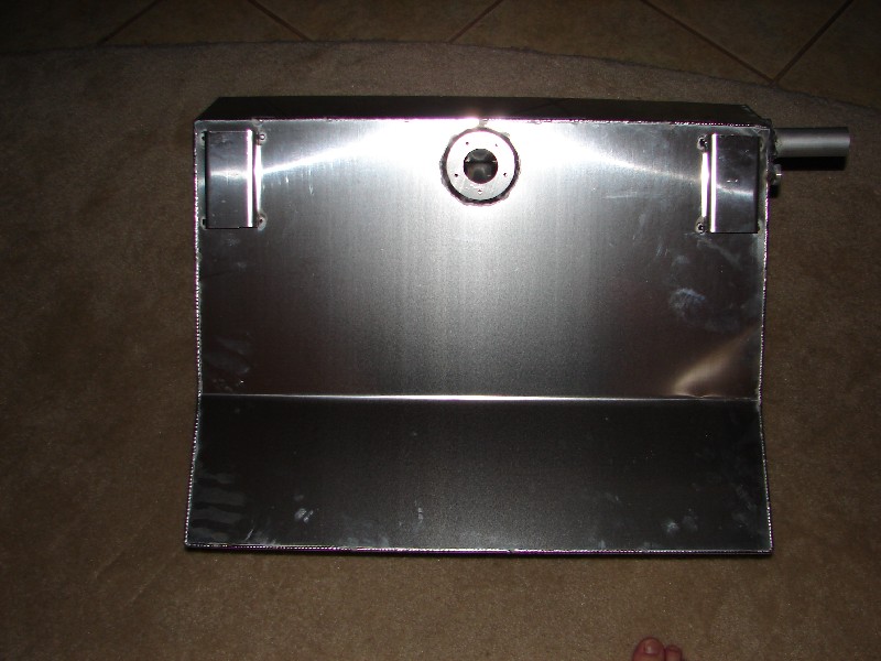

I'm using this, it mounts in the factory location.
Old May 8, 2008 | 09:14 PM
BMoney's Avatar
Posts: 435
From: Flint, Michigan
wow. that is a nice piece! whats the price on that thing?
Old May 11, 2008 | 09:39 AM
97ChameleonTA's Avatar
Moderator
Joined: Aug 1998
Posts: 307
From: Valrico, FL
It isn't cheap. I got mine a long time ago but now they are running around $675 from NastyPerformance.com.
