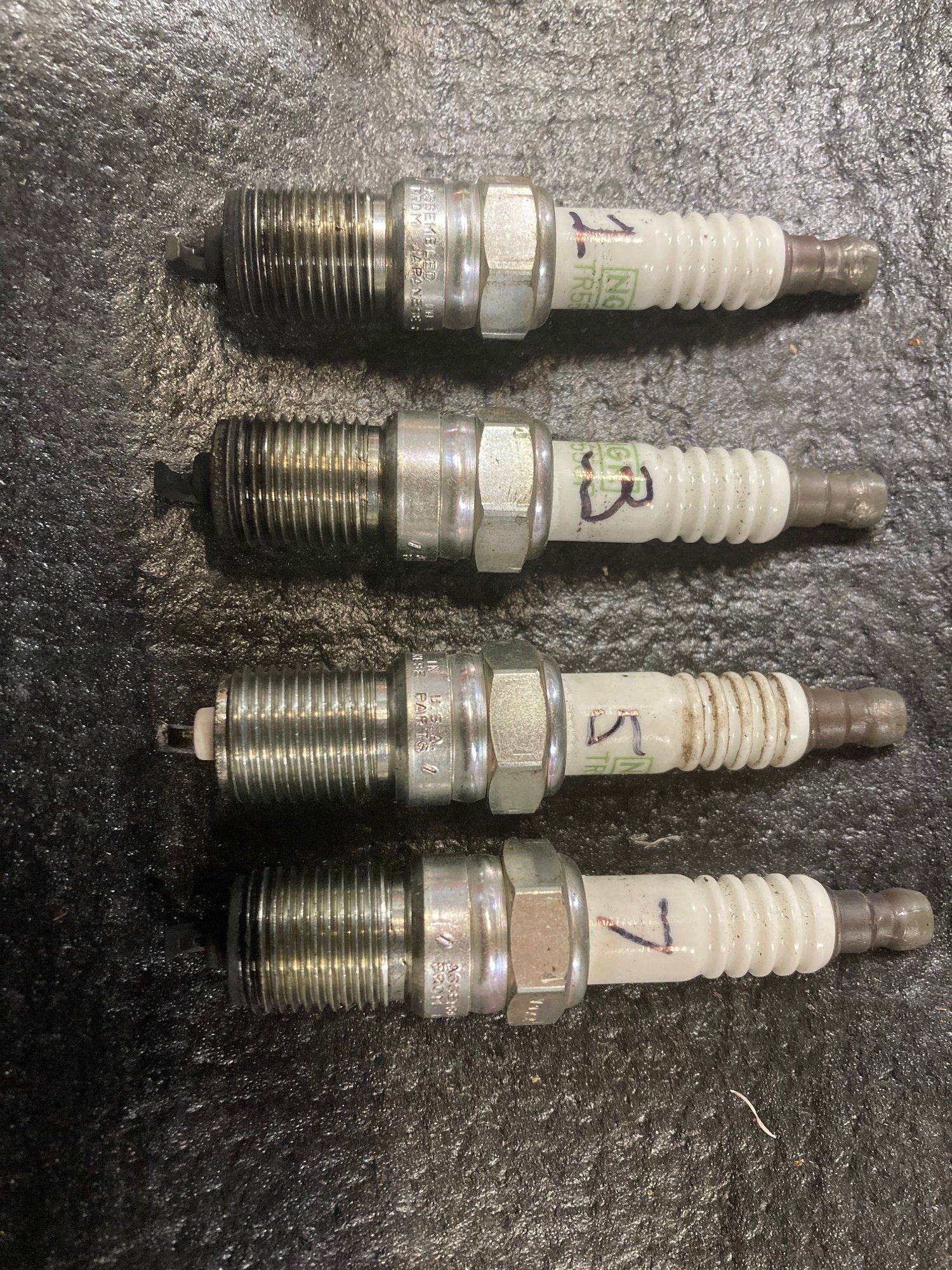

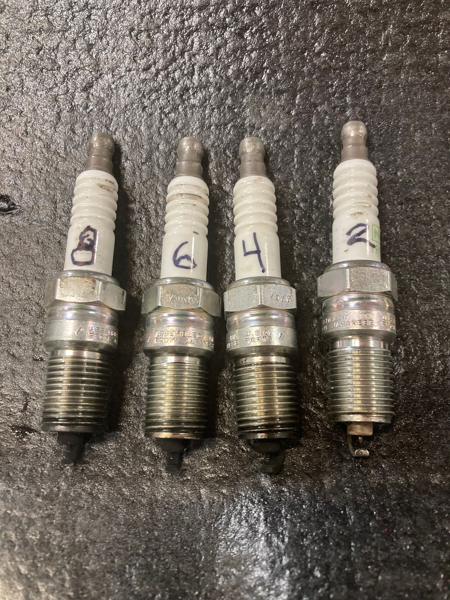

pulled them trying to figure out why we can’t idle and #5 looked as if it has never fired and #2 looks if it’s fired about 20% of the time so been sending Solomon multiple logs trying to track this ghost down but he is at a point of his tune should have me running and I can’t even take it off the jackstands
Recent things I’ve tried are new icm, coil, plug wires msd super conductor checked for resistance 38 ohms to 110 ohms, new plugs again and the exact same #5 and #2 were soaked with fuel but sparkling clean like the car never fired once the two videos are cylinder 5 and 2 old plugs grounded out and me turning motor over with injector fuse pulled and they both spark also I shot some header temps with it gun and I’m 300-550 degrees Fahrenheit on 1,3,5,then 7 was 140 f then #2 4 6 8 are colder than the coolant
