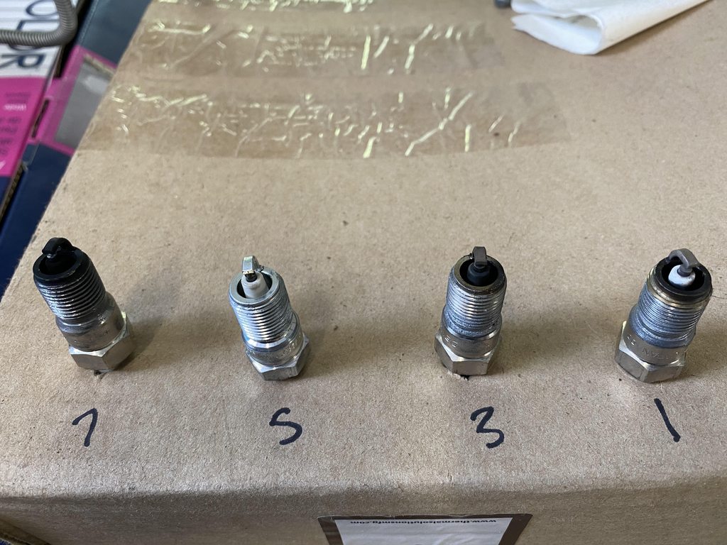

Old May 2, 2021 | 03:02 PM
RealDealZ28's Avatar
Joined: Jan 2004
Posts: 234
Re: Newly rebuilt '95 LT1 - misfire/skipping
I went back and pulled the driver's side plugs. Looks like cylinder 5 isn't firing at all, and cylinder 7 is really rich.

Old May 3, 2021 | 08:55 AM
Joined: Jan 2004
Posts: 234
Well, I may have found something. And I take full responsibility for being a dumbass. I was having trouble reinstalling the spark plugs on the driver's side bank from the top of the engine. I decided to do cylinders 5 and 7 from underneath. While I was under the car, I physically traced the plug wires for 5 and 7. I had them swapped on the optispark. My working theory is that cylinder 5 was firing all along, just at the wrong time. That explains why I never could find a problem with the valves, injectors, etc. As showing in the picture, cylinder 7's spark plug was very fouled. That's because it was firing in the wrong sequence.
I corrected the spark plug wires and took it for a short test drive. I ran out of time to drive it much, but from what I can tell, the misfire is gone. I do still have some slight hesitation that I'm going to have to look into, but the car is at least drivable now.
Injuneer, thank you so much for your help with this! And again, it's completely my fault that I didn't triple check the Opti. I checked it one time from the top of the car, and from then on assumed it was good.
