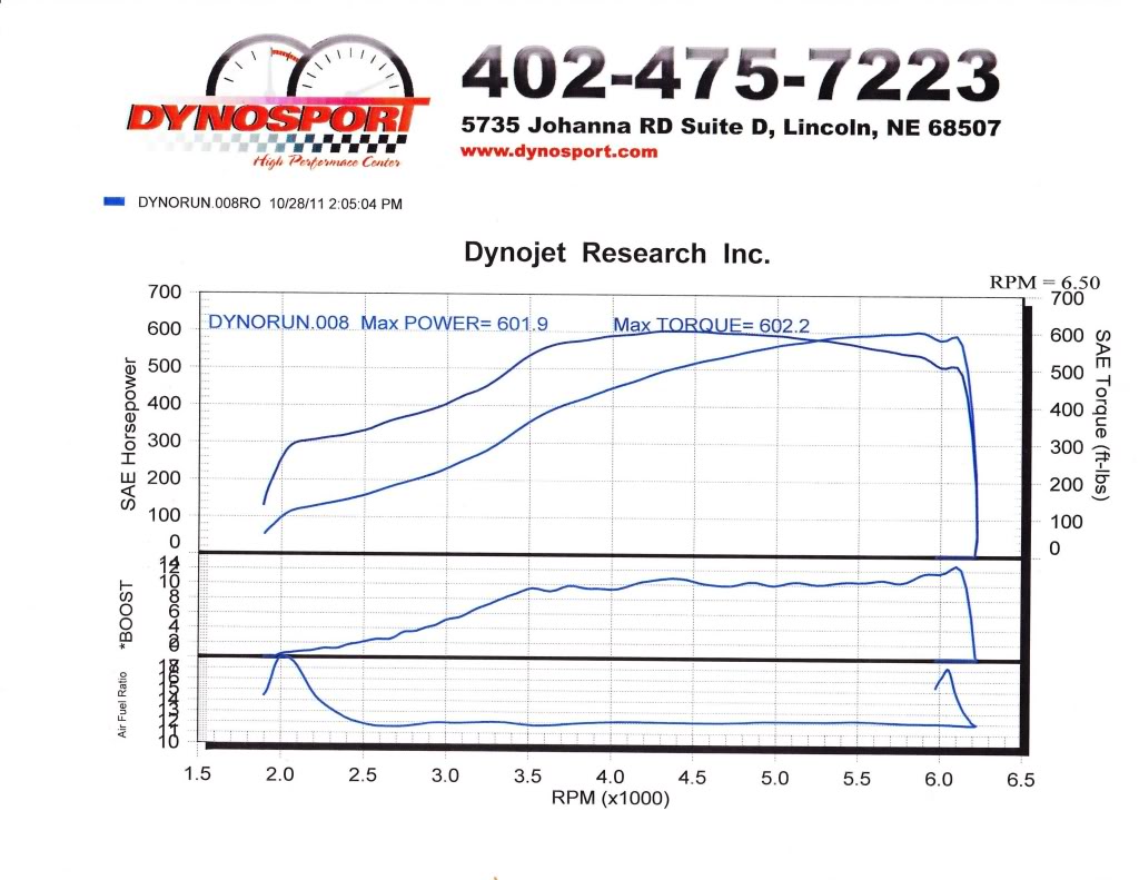

Fixed the leak permanently on the drivers side, the passenger side hasn't given me any trouble yet, but I might as well take the time to fix it too, that way I don't have to worry about it.
So with 10psi and about 21%u00BA timing on 91 octane it put down 600hp 605ft/lbs with a somewhat rich AFR. I don't remember exactly what it was, but I think another 30-50hp could be found just from leaning it out and adding a little more advance. I'm not going to push it though as I want to keep it on the safe side.
I kinda want to through the 15psi spring in it and see if it'll break 700, but I also don't want to push my luck. Does anyone know where I can get a compressor map for this turbo. I want to see where its most efficient.

Nice... you only went up 3 psi, but up 4 degrees of timing and picked up 100rwhp. The key is timing I don't have a compressor map, but you could email turbonetics and see what they have.

Cam is a little small, but I would get the 1.15A/r turbine housing first before swapping out the cam (make sure the .96 a/r isnt choking your setup with those heads).
looks like you had boost creeping up to 14psi right when you made peak power, but the powerband was already done at that point.
If you plan on running 10psi on the street, then keep the current spring. Us a boost controller to pull it up to 15psi for the track.

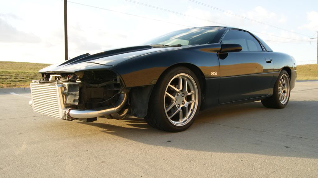

Here are some pics of the dirty car.

I don't know what to do with the MAF. I want to run one to get rid of the sight hesitation off idle, but I think it'll be maxed out if I put it in a 3" or even a 3.5" housing. Its in a 4" housing right now, which throws off the MAF readings and creates turbulence coming from a 3" intake tube and then back down to a 3.5" elbow, so its turned off and I'm running a speed density tune.
As you can see, the intercooler tubing had to be modified since I had to lower the radiator and stand it up vertical. I can remake it and gain about 3-4" of ground clearance at the nose. The downpipe and wastegate tube are the next lowest pieces, but its about the same as my tranny pan and torque arm crossmember, so hopefully it won't be an issue. Also don't mind the duct tape on the drivers side valve cover. Its just temporarily holding my oil fill cap in.
