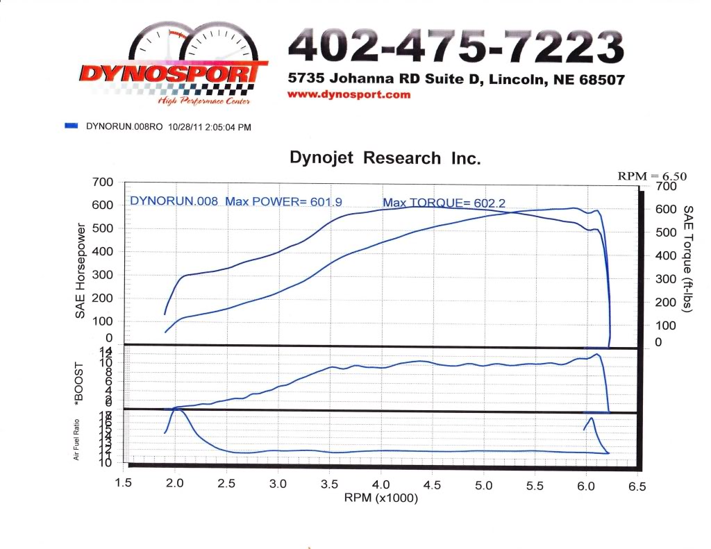

Edit... just talk to Travis and he got some preliminary numbers:
A/F right around 12.0
timing only @ 17 degrees (which is low for an LTx. I told him to turn it up to 24-26 degrees, but start @ 21/22 degrees and see how it reacts as he goes up).
91 octane doesn't help...
495hp 491ft/lbs @ 7psi thru an AUTO
I think with more timing he should be right @ 550rwhp @ 7psi.
Updated numbers @ 10psi: 602rwhp/602rwtq

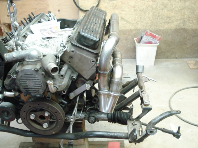

I am going to post build pics along the way.

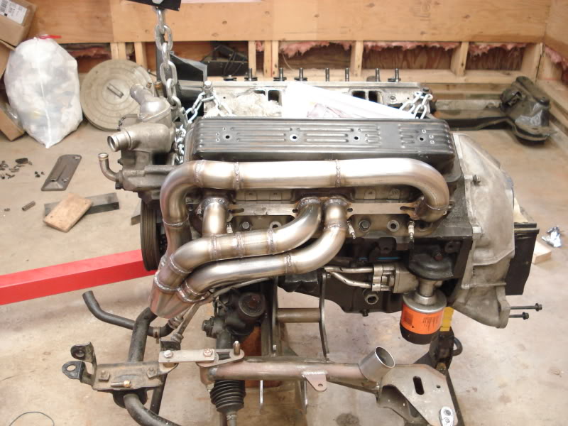

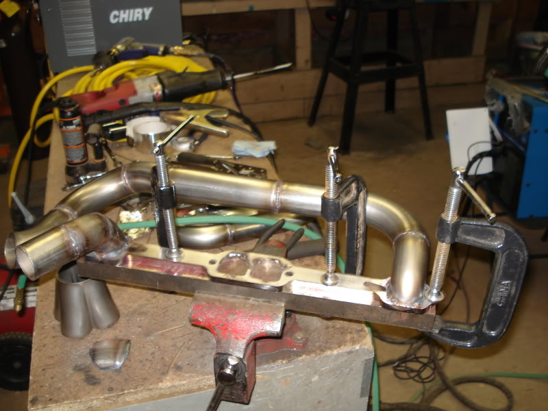

Driver's Header tacked

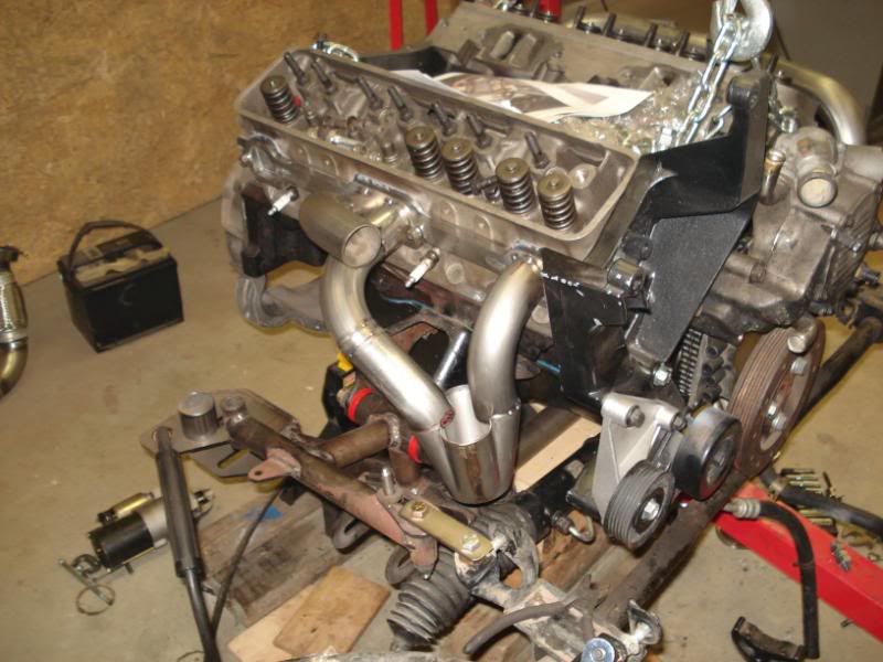

Old Mar 26, 2010 | 06:31 PM
RealQuick's Avatar
Joined: Feb 2002
Posts: 5,645
From: Bridgewater, MA
Pass. header

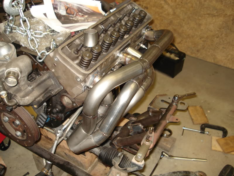

Old Mar 26, 2010 | 09:10 PM
RealQuick's Avatar
Joined: Feb 2002
Posts: 5,645

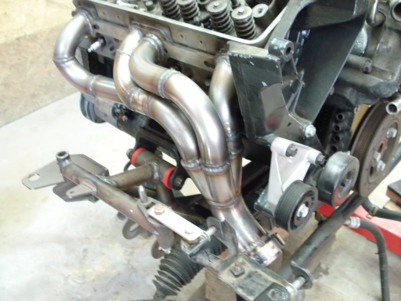

Old Aug 14, 2010 | 07:28 PM
RealQuick's Avatar
Joined: Feb 2002
Posts: 5,645

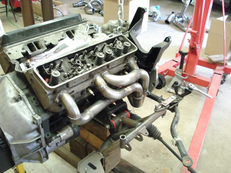

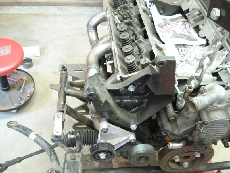

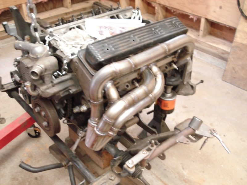

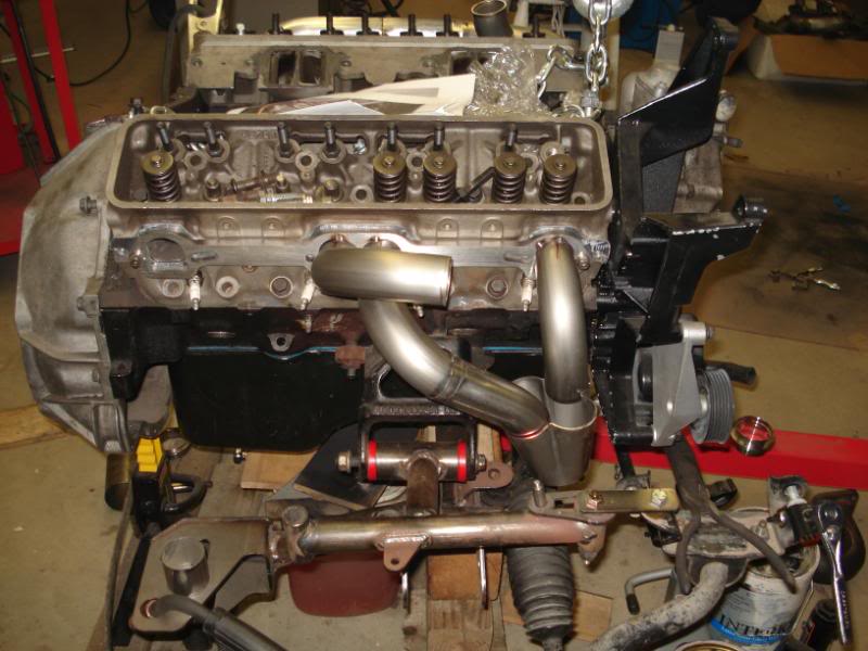

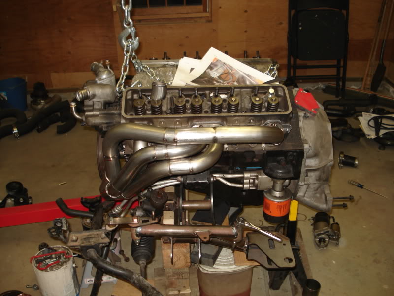

Bringing this back up as I started on the project again for the customer. I wasn't happy with the fit of the headers, so i remade them I freed up some clearance and made the install much easier.
pass:
driver's:

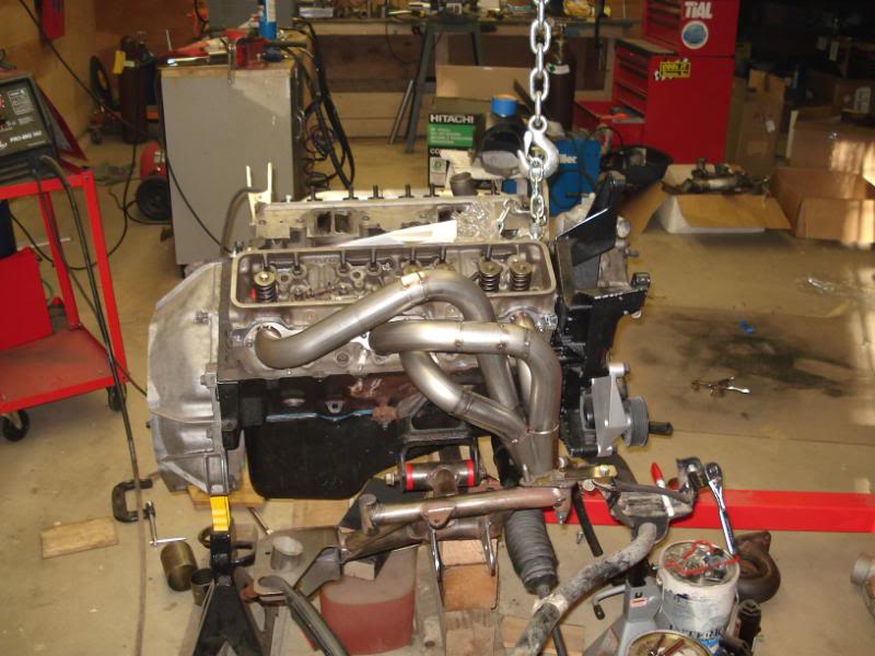

Test fitting in the car:

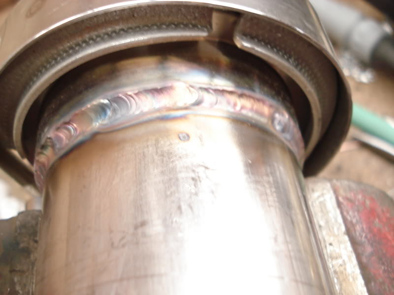

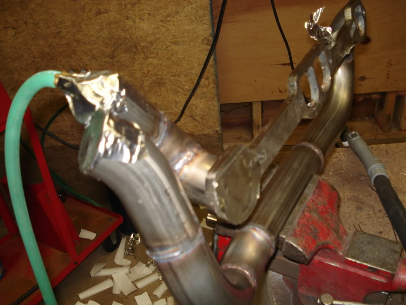

Welding... back purge setup.
